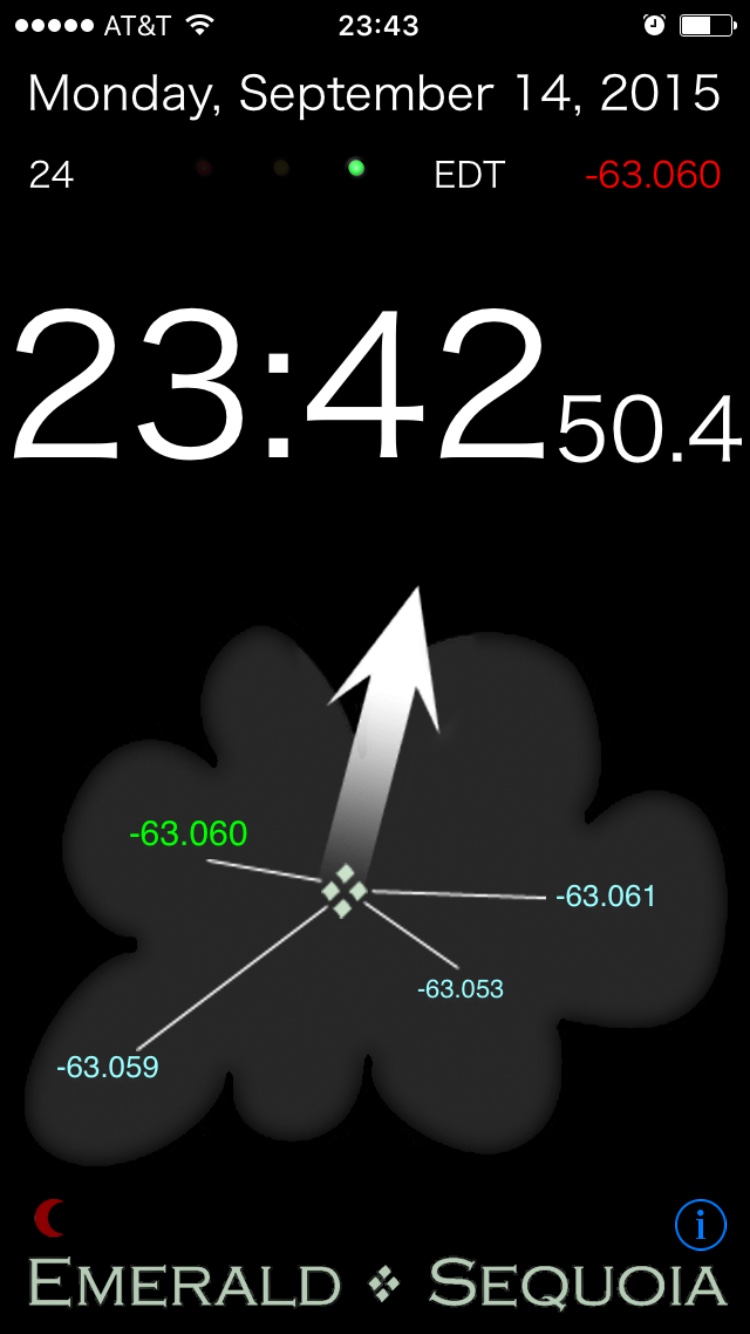

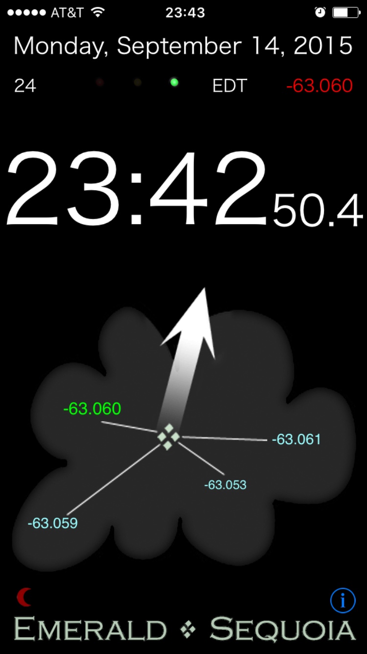

Yeah.. this is my iPhone 6 on iOS 9.0 GM running Emerald Clock, which shows the difference between device time and actual precise NTP time.
63 seconds. That's over a WHOLE MINUTE off! What the hell, Apple? In iOS 8 it was within 1-2 milliseconds. Someone really screwed up on this.

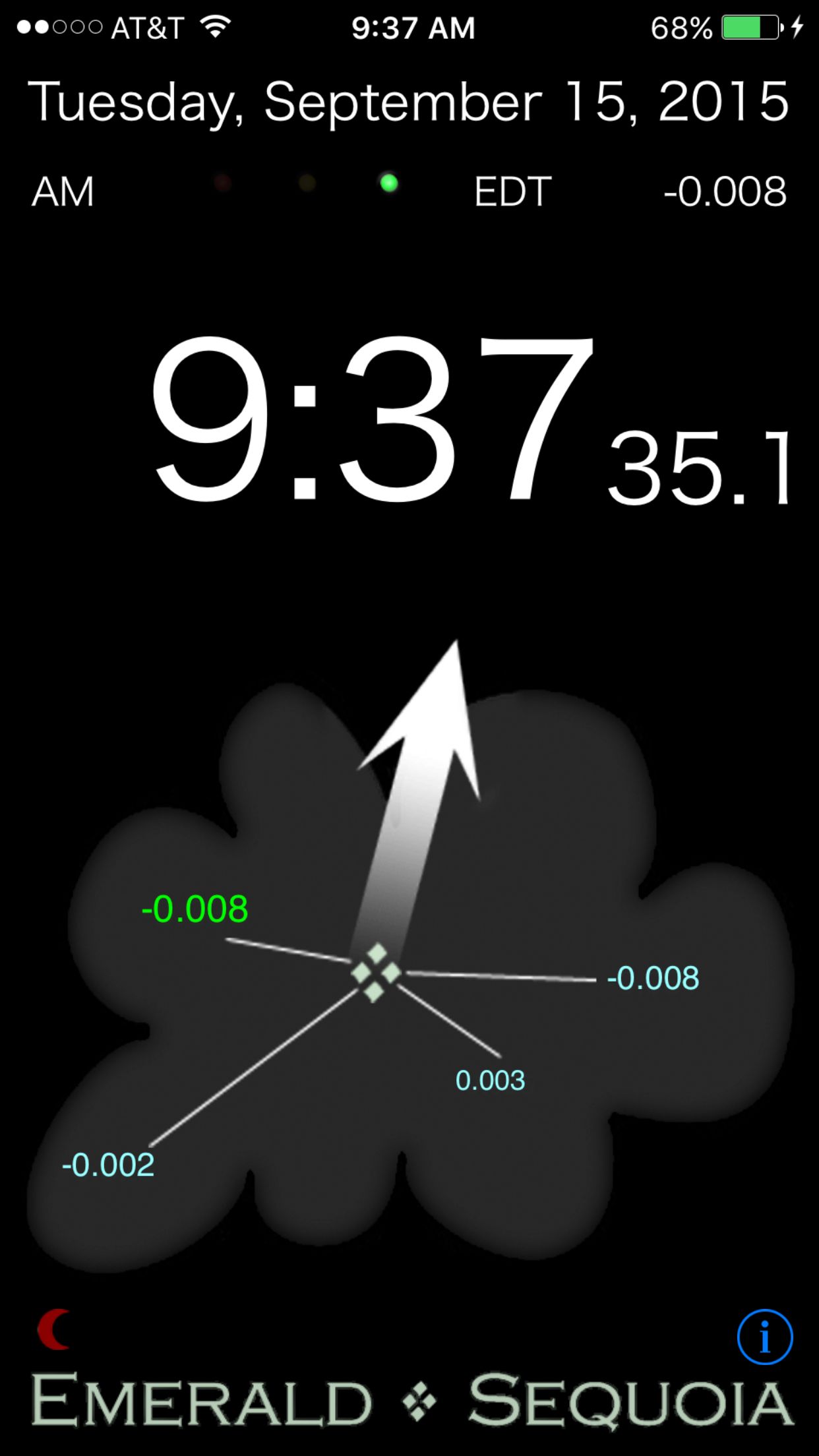

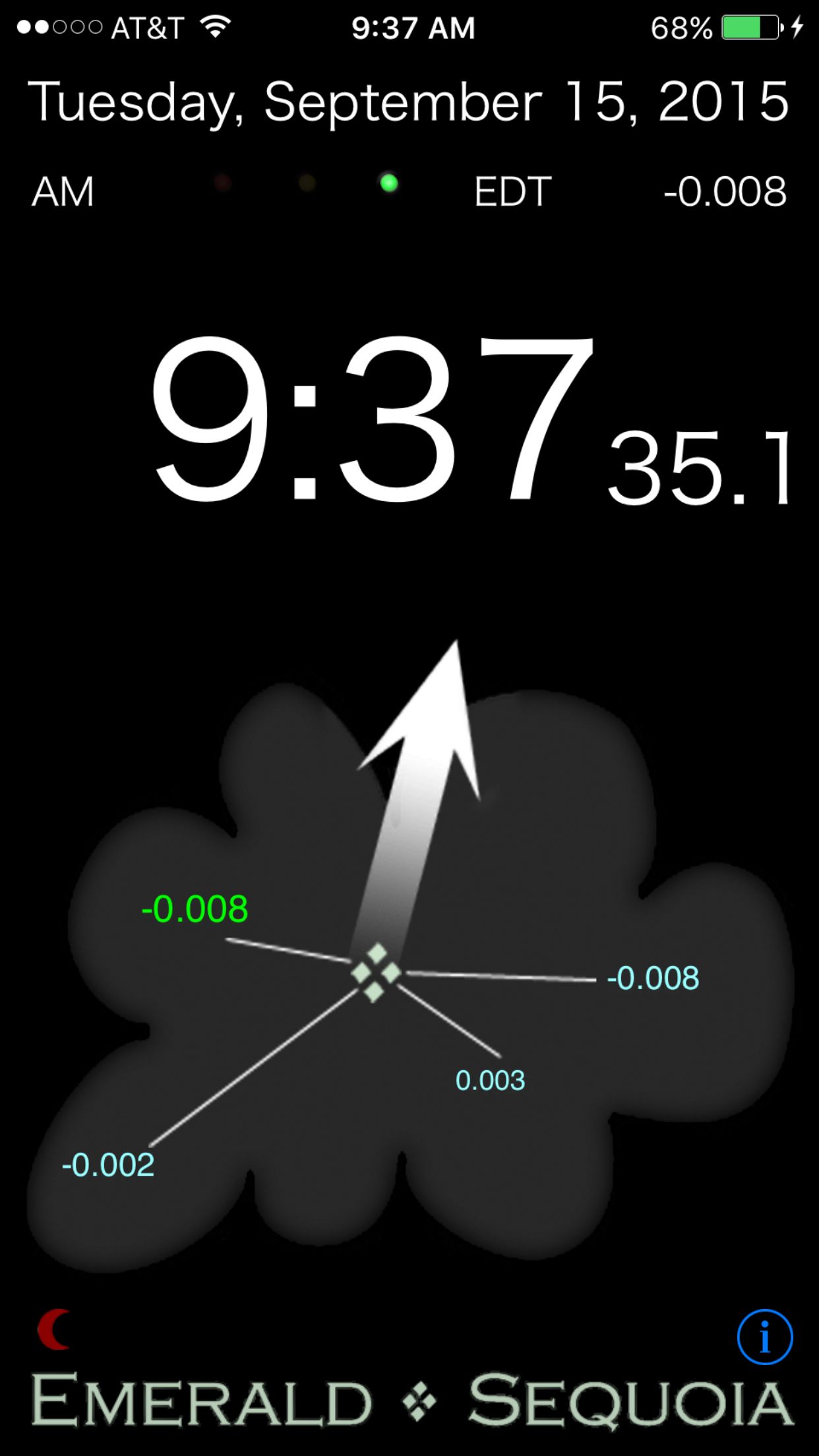

It was fixed in 9.1 beta. Here's Emerald Time now, after updating to 9.1 PB1 last week (and switching back to automatic time setting):

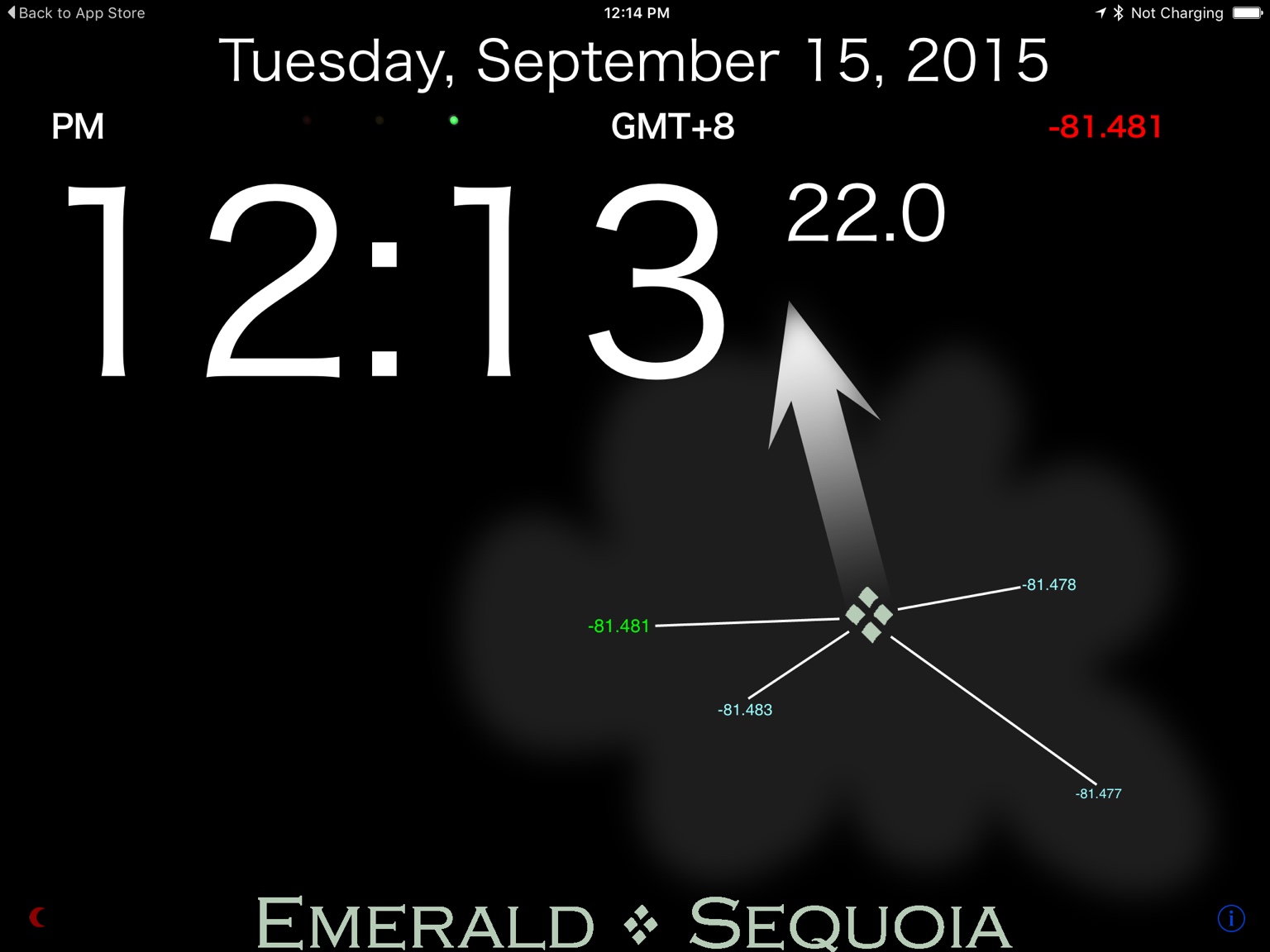

I turned off cellular data on my iPad and toggled "set automatically" for the time. Suddenly the clock was EXACTLY right, at 0.000 offset from NTP clock as reported by Emerald Time.
