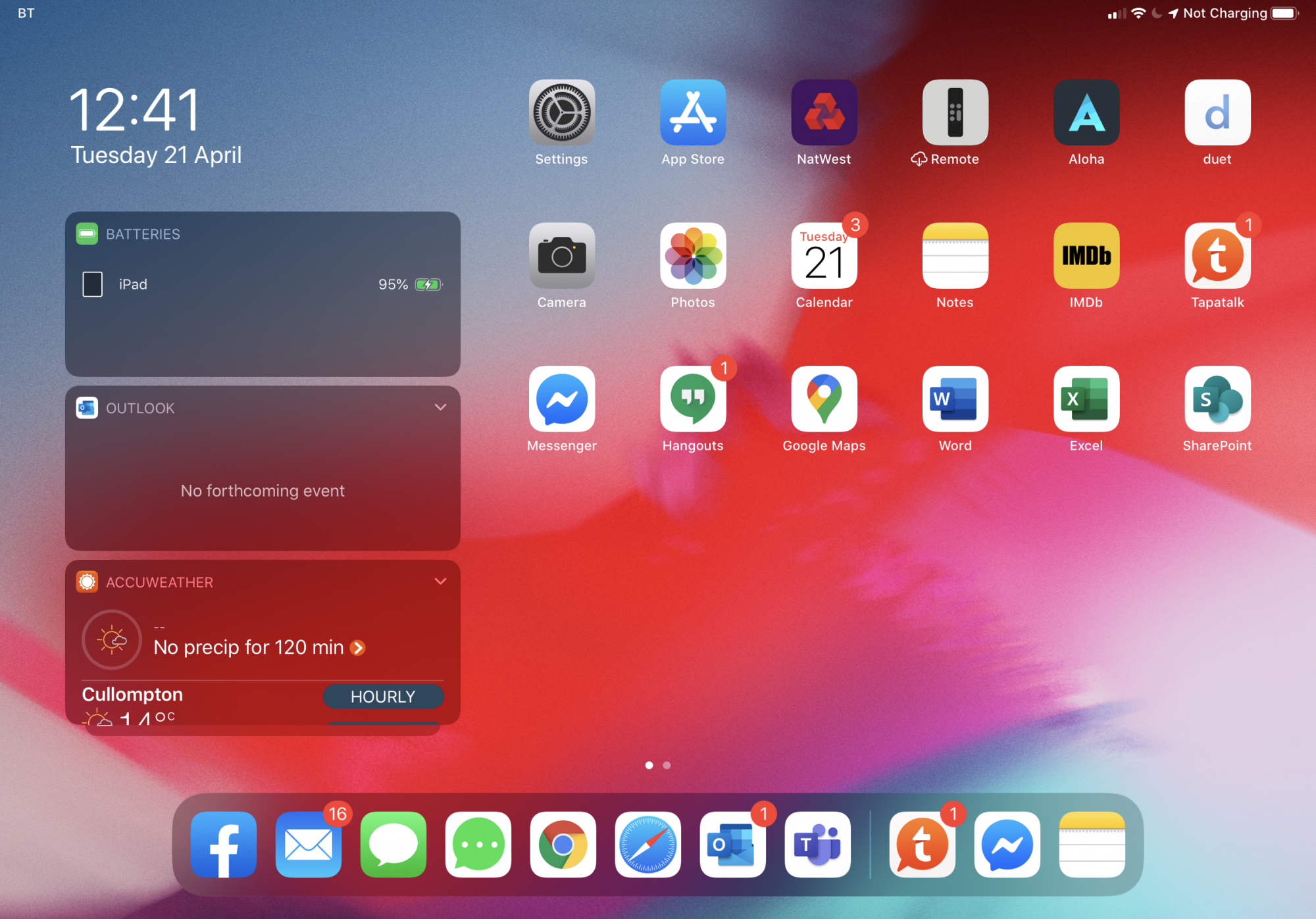

Has anyone with the new MK experienced any issues in using the pass-through charging port?
I have tried three different USB-C cables and all result in ‘Not Charging’ being displayed next to the battery icon (See picture).
I have been on the phone to Apple Support for the last hour trying to explain this to them, it would appear to be a hardware issue and they are arranging collection of this one and dispatching a replacement upon receipt of the faulty unit.
