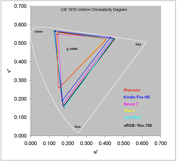

http://tablets.reviewed.com/content/ipad-mini-with-retina-display-tablet-review/the-science
The mini produces about the same colors as the previous gen did. The only real difference is that it's an IGZO panel and it has higher PPI. It's not as close as 90% compared to 108%. It's more like 70% to 108%. Also if it were as close as you say there wouldn't be such a large number of people noticing this, even after picking it up and using it for the first time.
My main gripe is just how muted the magentas look in this. I could deal with overall muted colors I guess..but it gives a bit towards the cyan side which inherently mutes magentas specifically, even more so.
Edit: According to DisplayMate's comparison of the Original Mini's display:
The Retina Mini's display is about the same:
Which means it has about 60% color gamut. Wow 🙁

Just curious which one of the two on the right is the rMini? I'm hoping it's the top one. That one appears to have be 10-15% more saturated colors than the one below it hah (I'm going to be getting the rMini no matter what - because I don't want the huge iPad)
But as I look at my own original post, the graph showing the iPad Mini 1st gen. and the iPad 2 have almost the exact same gamut. So the difference from the iPad 2 to the iPad 3 was huge because of both the doubling in pixels, but also the much more colorful, and accurate color gamut. In the iPad Mini retina, they only did the 1st of those two. So it still has the overall color reproduction of the iPad 2, and thus looks muted overall 🙁
