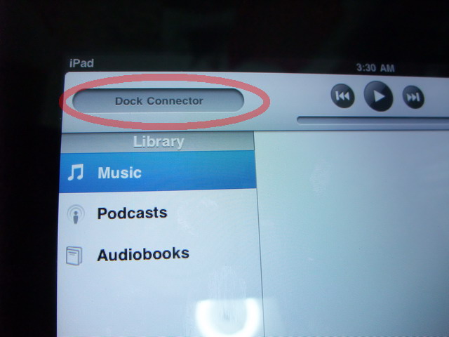

Most likely it is hardware problem, because when I open the iPod App, the volume control slider turn itself into a "Dock Connector" indicator immediately. Implying that I am connected to an external device, such as card reader or the like. In fact, I am not connected to any external device.
If a headphone is plugged, than the "Dock Connector" indicator will turn back to volume control slider!

Solution to sound issue (in my case and others)
Dear all,
It's been a while since this thread started, but because Apple has closed their version of the thread, I'll leave my solution here ;)
I had the same problem and went through the usual reset and restarts, plugging dock connectors in and out. To no avail. Because the word 'dock connector' was in the volume slider I suspect (my theory and that of others at the Apple forum) that I have created the problem when trying to hook up my iPad to my car stereo's USB port with another dock connector cable (i.e. not the one that came with my iPad).

The solution is easy as I have done this loads of times with IOS 4.2 and airplay to restore sound.
After choosing Dock Connector.
Reboot your ipad.
Sound will be back to normal on the device. It has the dozen or so times I have done this.

What do you mean by choosing Dock Connector?
I'm having the same problem on my iPad. The previous answer didn't work.
