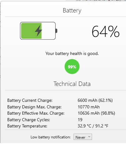

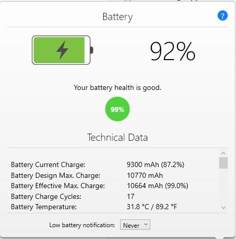

My 2021 12.9 M1 pro battery is only 99% after 17 charge cycles
And then down to 98.8% after 19 charge cycles

That totally incorrect. Not every iPad starts with 104% to 106%
