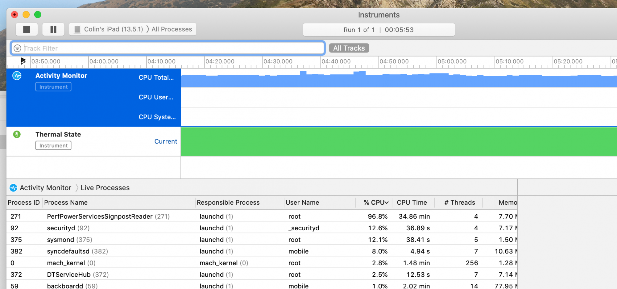

... so I connected my iPad to the Activity Monitor in Xcode...
It looks like PerfPowerServicesSignpostReader (some OS process) has gone nuts - and is stuck consuming virtually 100% CPU. I'll try rebooting - and if that doesn't help I'll try rebuilding this iPad from scratch.
In the meantime, if anyone else that has these heating problems also has Xcode, have a look in Instruments. Do you have any rogue processes?
