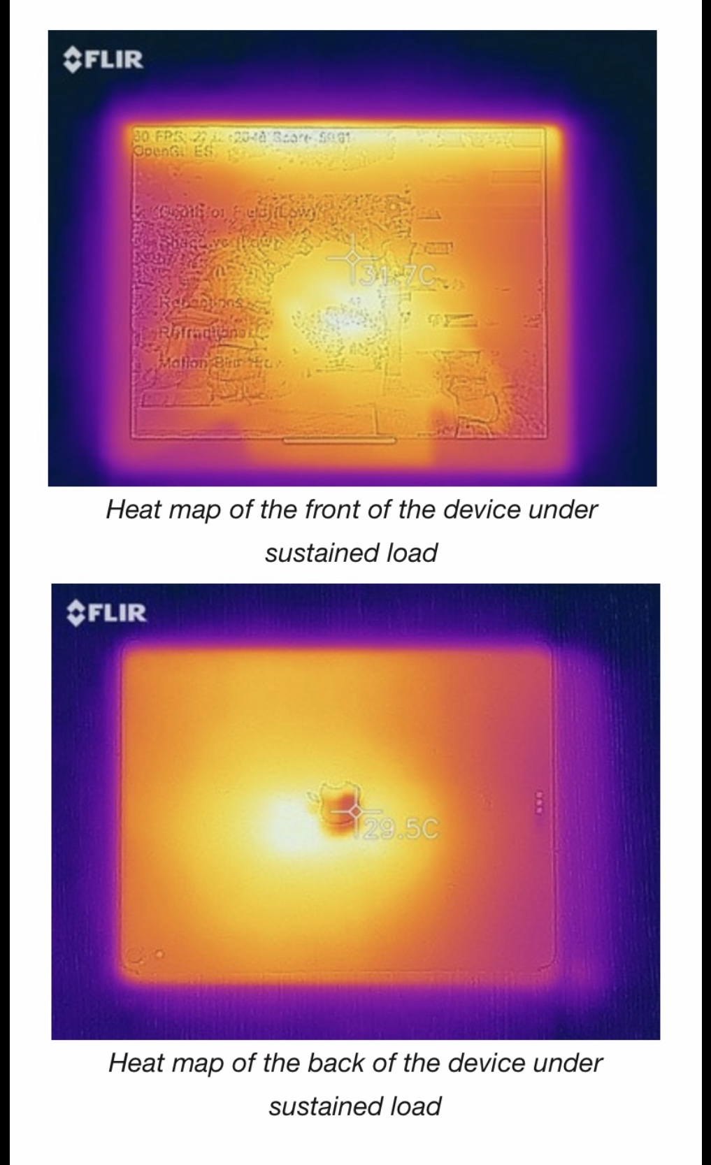

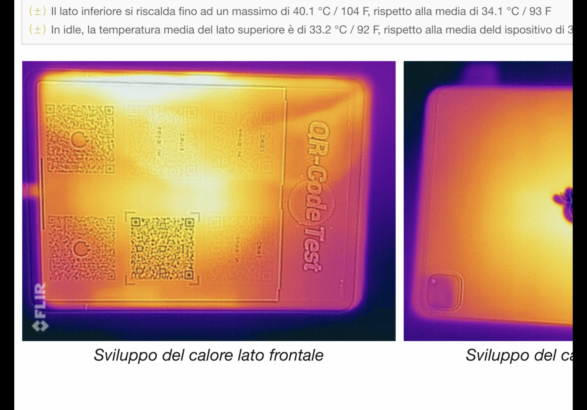

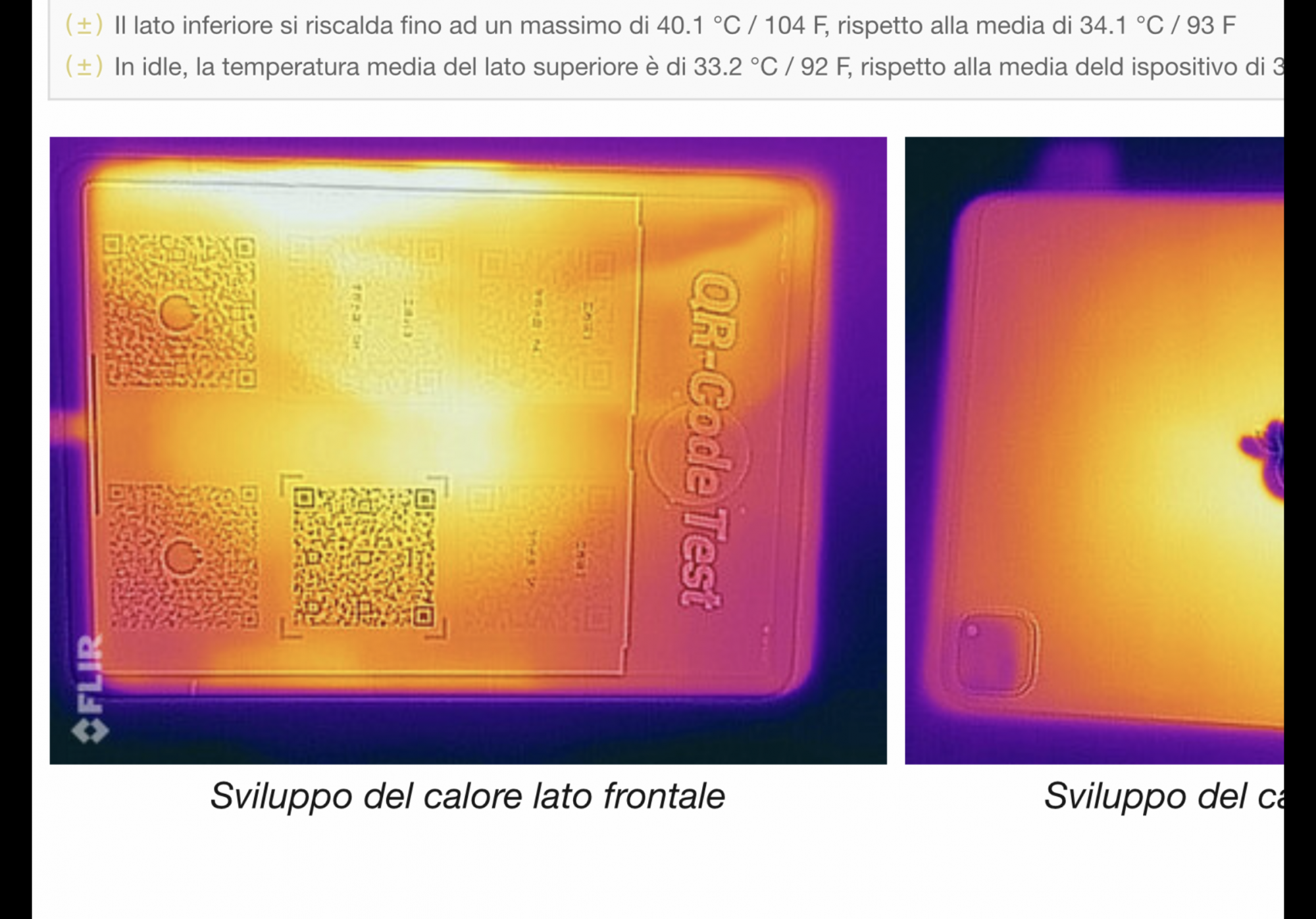

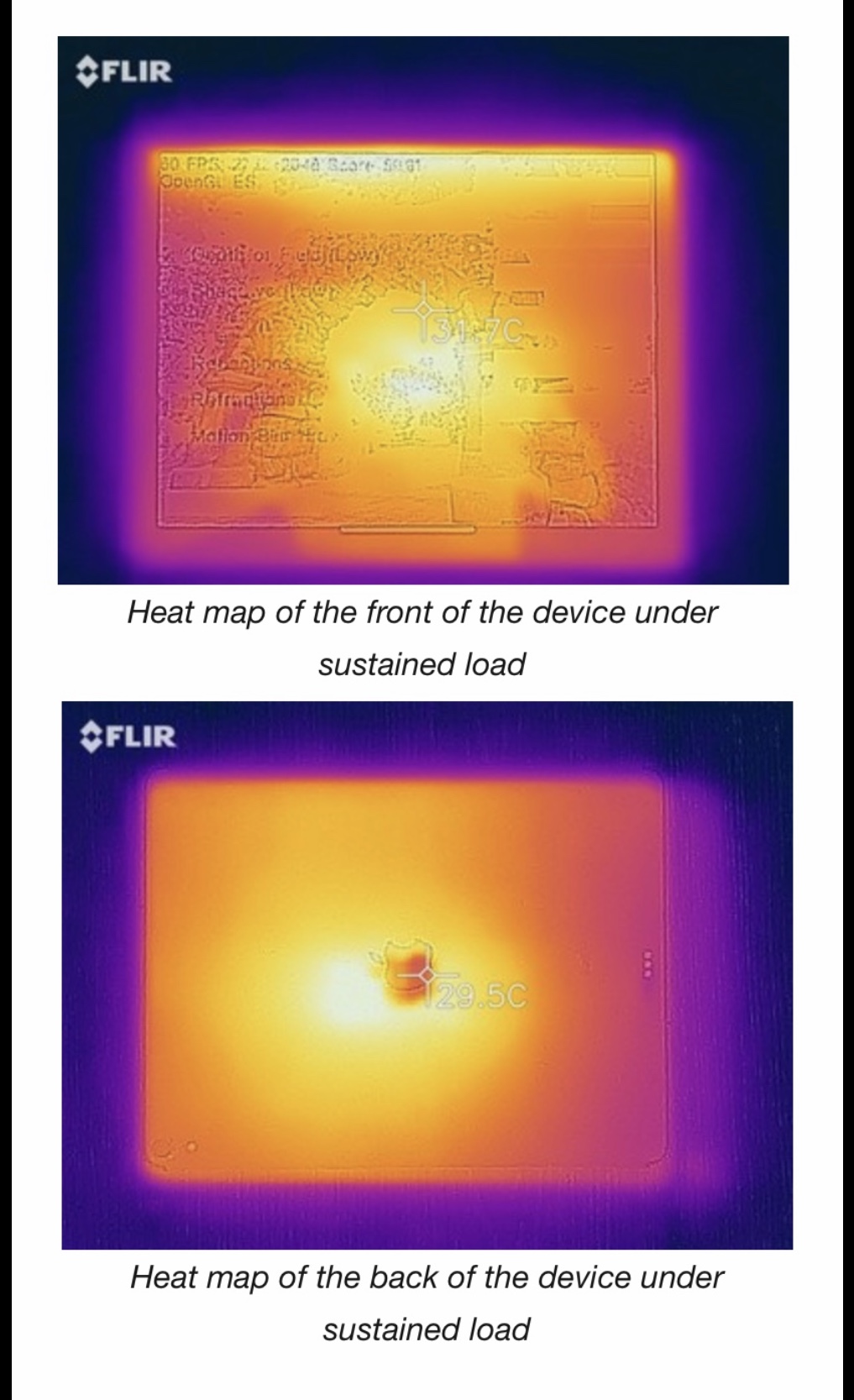

I found this heat map of both ipad pro 2018 and 2020
The CPU seems to be more or less the same, only with an additional GPU core now activated, which is most likely due to yield improvements because of stabilized production process. Therefore my understanding of “architecture” would not necessarily be limited to the A12 chip only, but to a wider area. Perhaps they also optimized some power routings or used different parts that dissipate less heat (which could also include the parts on the left side).
And even if the reference would indeed focus primarily on the A12 chip: making it dissipate less heat would mean less heat in the whole system and thus more “headroom” for the other parts like the display drivers. After all, the iPad‘s heat sink (a.k.a. metal back) and its cooling capacity is shared by all components.

Difficult to decipher. If I read correctly, the 2020 iPad is some 10 degrees cooler than the 2018? Is that correct?

The first part of your post is correct (ICs located there), the rest is not. Do not mix together the normal warmth development with single cases where very strong heat even under little use got reported. This also applies to several postings above, like the heat maps from Tommaso. We are not talking about the regular heat development.
