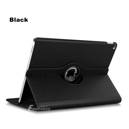

I had a similar issue with my iPad PRO 12.9. And I just found out what caused it.
There was one spot on the display that would show the distortion (called Newton rings).
The distortion would appear with very light pressure. And also when lightly pressing in another area of the display, the same spot would distort. Even when pressing at the back of the iPad, the spot would appear.
I went to the Apple store and showed it to them.
They gave me a new pad. They also mentioned this could happen when the ipad had been dropped. (mine hadn't).
After a few days of using the new iPad, the issue slowly started to re-appear.
It was then that I found out my cheap rotating swivel case had caused the problem.
I was using this type of case:
This case has a rotating point at the back which is not flush but stands out a bit on the inside.
It presses against a small focused area at the back of the iPad, causing it to slightly bend and produce the newton rings on the display.
I am now using a non rotating cover and everything is fine.
