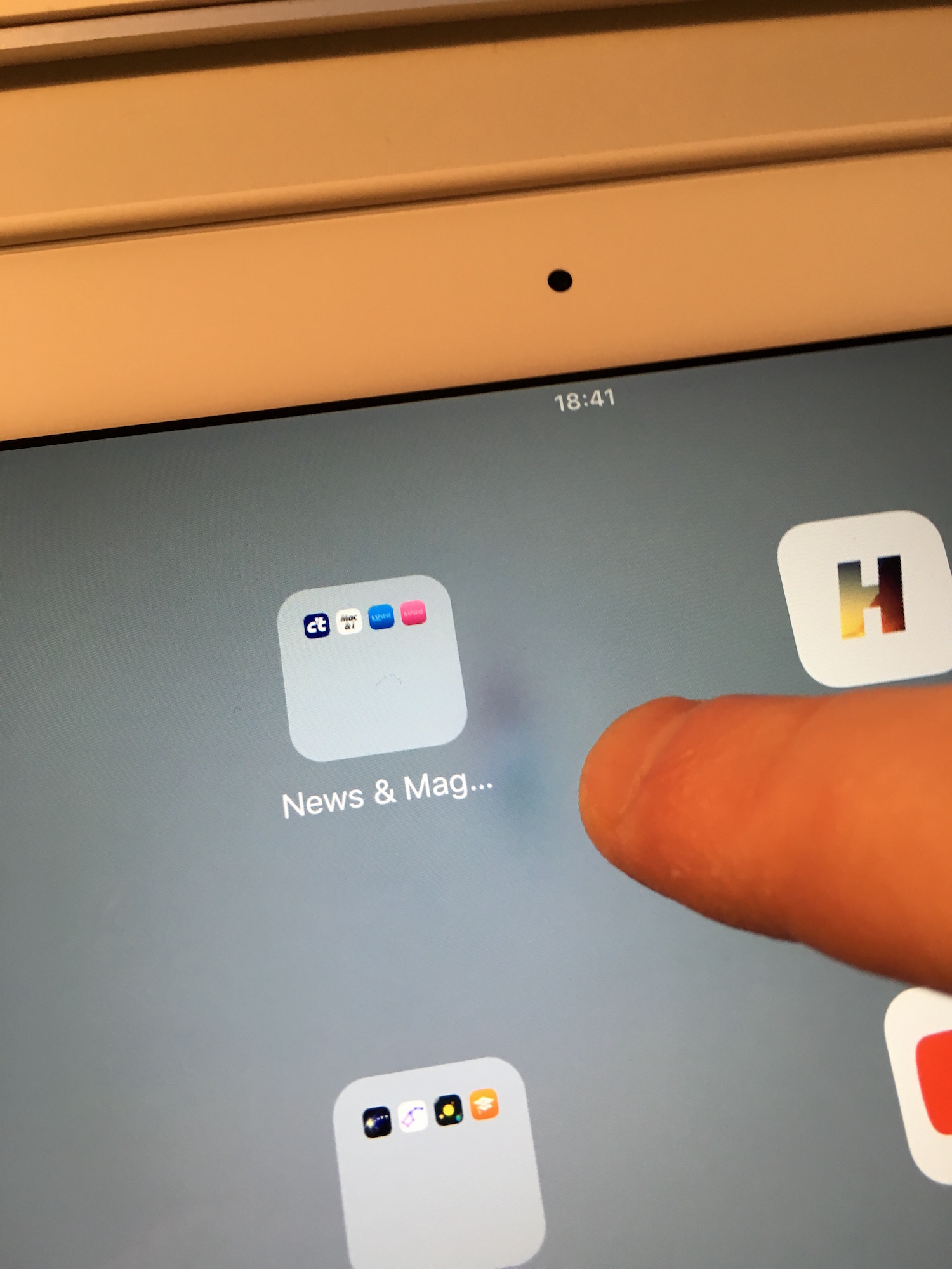

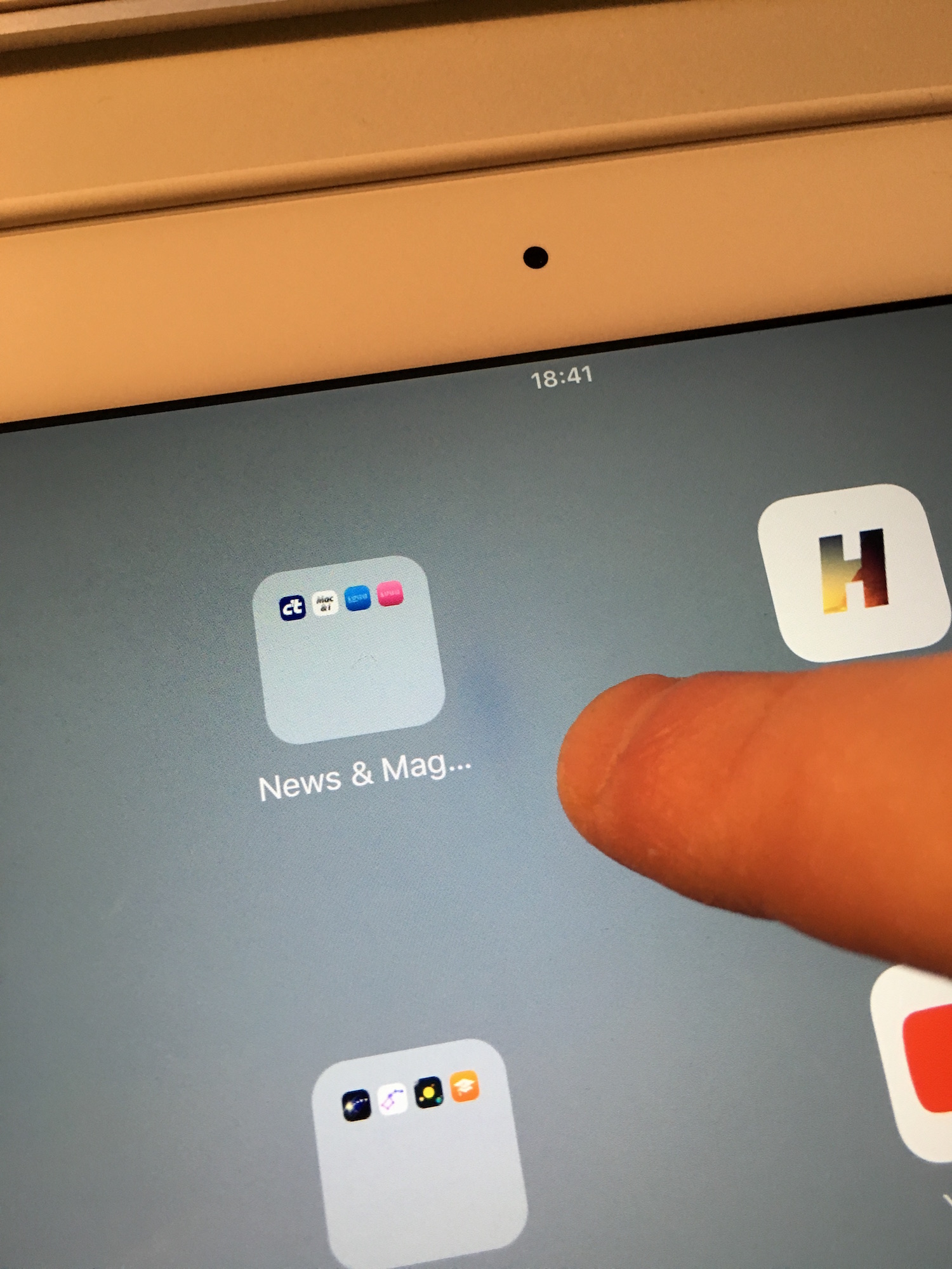

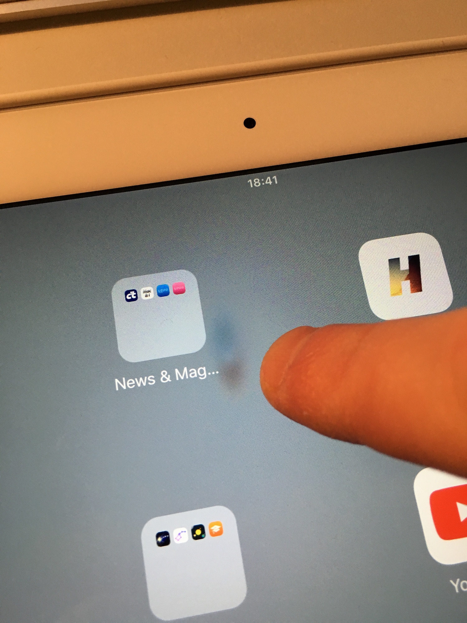

I just discovered a very annoying issue on my iPad Pro's screen: there is a spot in the upper area near isight camera (where the clock is displayed on the lock screen), which reacts with lcd pressure distortion even on lightest touch. With normal tap or stylus distortion gets very visible and annoying.
I made some pictures and video, demonstrating that issue.
@All iPad pro owners: can you confirm that on your devices or I just got a defect one?

there's nothing gentle about it, see video 😎
