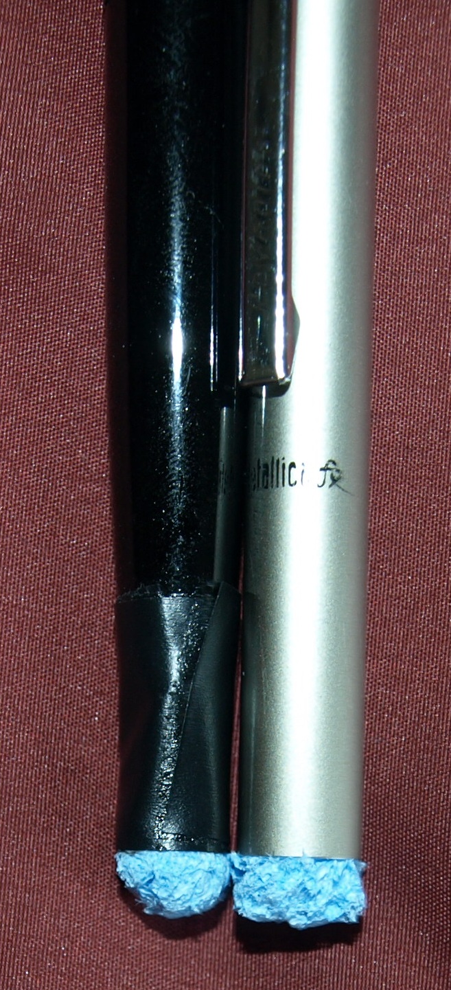

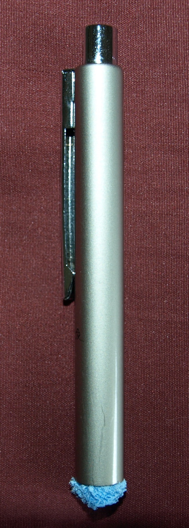

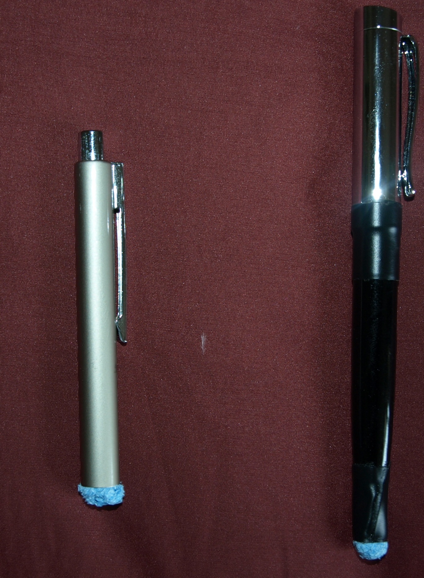

Went through a lot of research on products such as the Pogo or others (forgot names) and thought why not simply make one of my own. Below you will find pics of what I made, note that the Black&Silver one is what I truly intended for and the short silver is just a 30 second job.
Here are the instructions:
1. Grab a metal pen (Metal conducts electricity and hence it's easiest). If none available, grab a plastic pen and a metal wire.
2. Go to your kitchen sink and find some Scotch Brite Sponge.
3. Cut the thick soft lighter color side into a rectangular piece slightly wider than the pen opening. You will notice that the Black Pen took me over 2 hours as the hole is less than 2 mm in diameter and was impossible to get the foam through in a stable fashion.
4. Insert the foam and make it secure by filling the hollow space with more foam or w.e you wish.
5. Trim the ball in front and make sure the rim of the bottom of pen is also touching the foam as to not scratch the screen or cause erosion.
6. Fly away drawing like a pro on paper!
P.S. You should make sure that the foam is indeed conductive by holding the foam and moving on your iPad screen. It should work.

Interesting idea.. But wouldn't the material you used scratch the screen or at least give it hairline marks?
You may be thinking of the corrosive side of the sponge. I'm using the soft side which is very soft to the touch and can no way scratch the screen. In the last 8 or so hours of using it (yes I have been drawing a lot lol) it hasn't troubled me at all, as in be hard to slide on screen or anything. Nevertheless, I trimmed the ball on the tip of pen so it cannot leave any hairlines or sponge residue.
I'm quite sure in my original post I mentioned the soft side... if not then I'll add it in there 🙂
Edit: There ya go, made it bold in step #3.
No. It appears he used the rougher part of a washing sponge.. Which consists of many fibres similar to hair, which therefore could cause hairline damage to the screen theoretically?
That's not the rougher part. I have a sponge like that, and the blue is the soft part.
