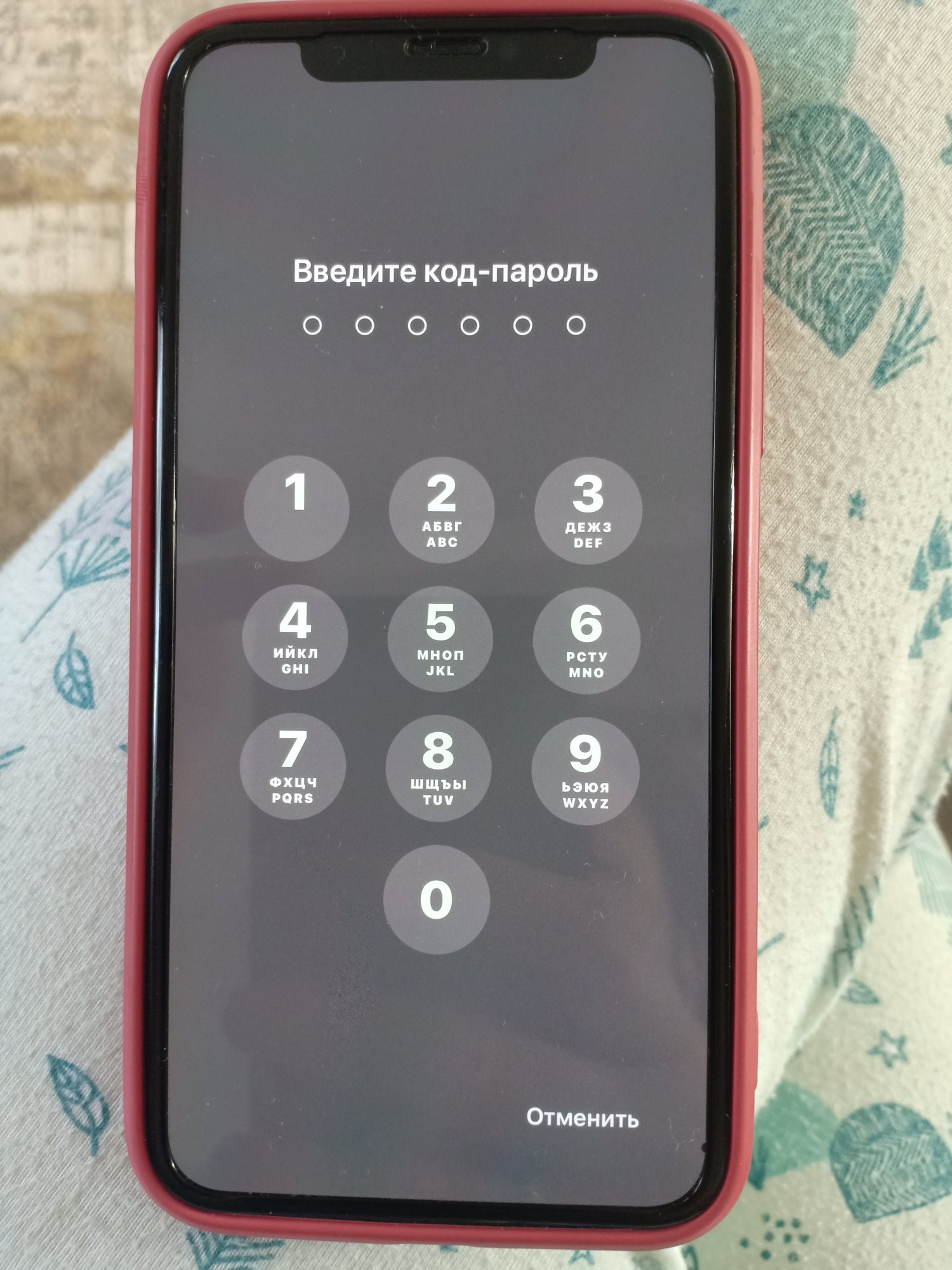

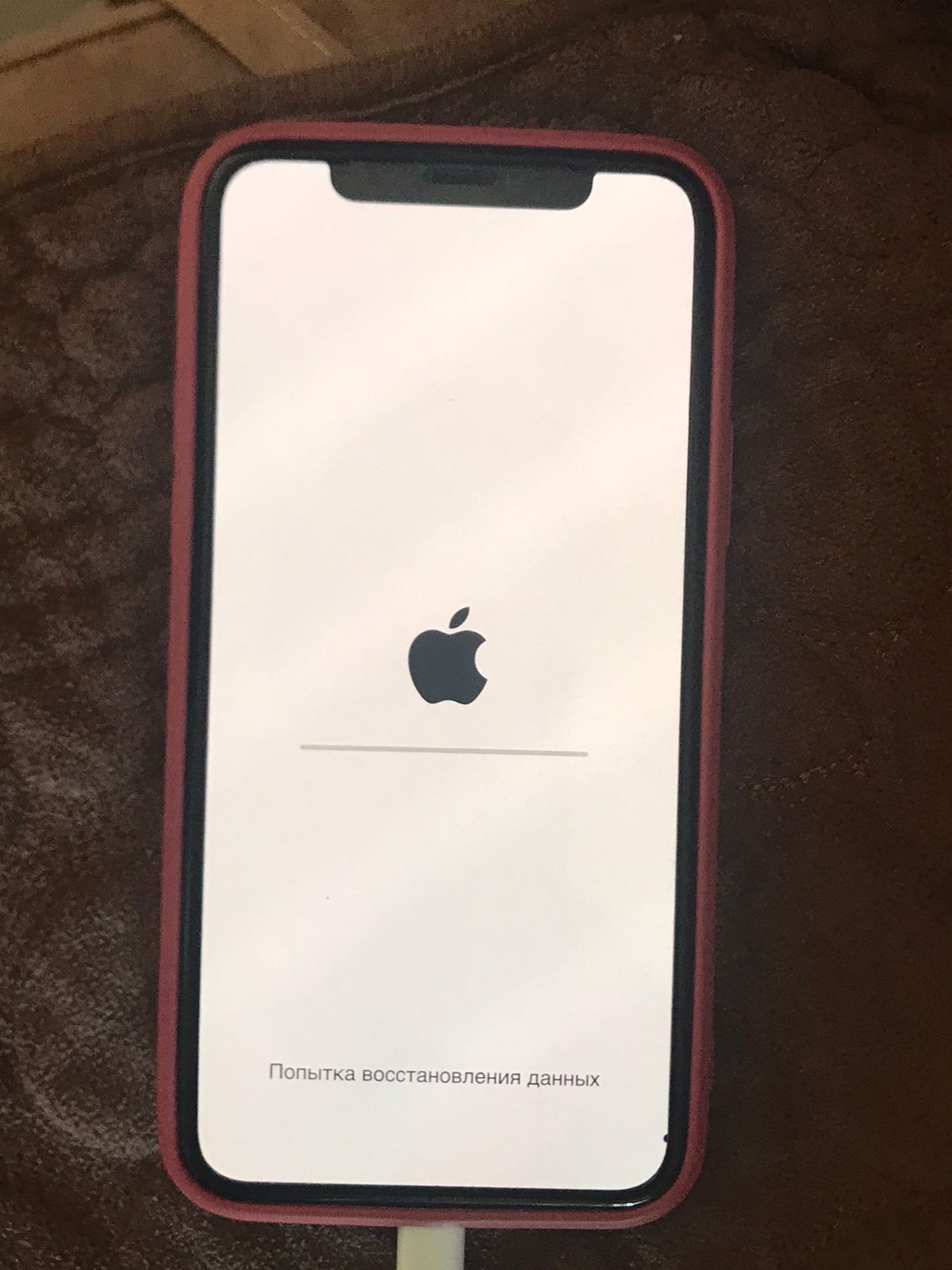

Hello, I have the following problem: swipe up on the screen to restore, then asks for a password, when you enter the password, the apple logo appears, it says that there is an attempt to restore and after a while it comes out again swipe up to restore. I attach screenshots, I have very important information on my phone, I really ask you to help me with the recovery.

Yesterday, a technician tried to restore the phone using 3uTools and ReiBOOT. In ReiBOOT, they selected the Standard Repair option (keeping data), and I paid for the firmware (iOS 26, about 9 GB). After that, a loading bar appeared under the Apple logo on the phone, and it completed fully. Then the screen said “Swipe up”. I entered my passcode, and the phone started “Restoring data”, which took about 30 minutes.
When it finished, the “Swipe up” screen appeared again. After entering the passcode, the phone shows a white screen with a black Apple logo and a loading bar for 2 seconds, then the screen turns black, the logo reappears, and after about 30 seconds, it goes back to “Swipe up” again. This repeats endlessly. Restarting doesn’t help.
I think the problem might be caused by insufficient storage space or an error during the iOS installation.

Erase the iPhone and then restore your data using a backup from iCloud or a computer. This should clear enough space for the phone to function normally.
