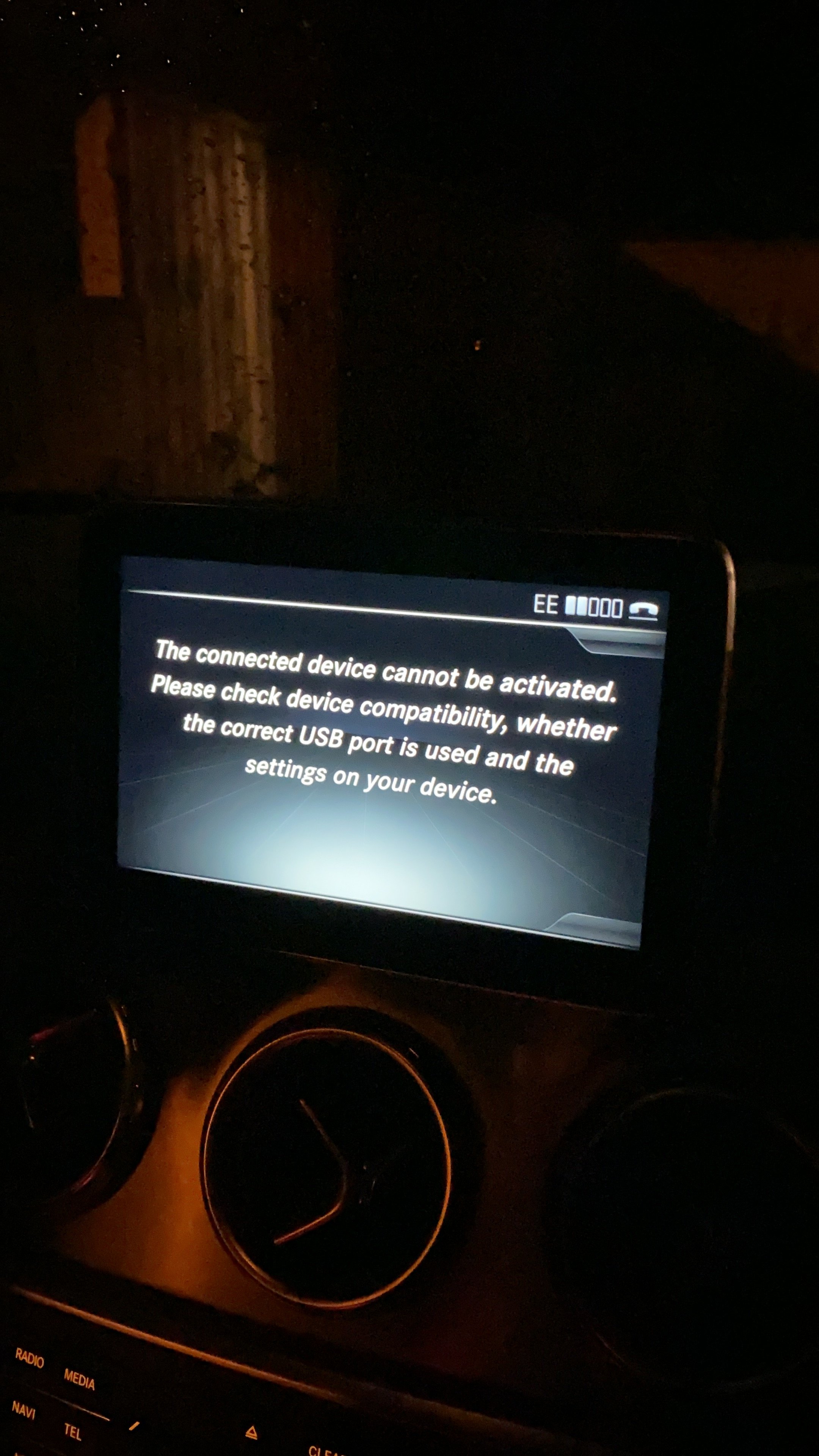

Having the exact same problem with my Mercedes. I've contacted Apple support, tried reinstalling iOS on my iPhone 11 Pro Max, reset my Mercedes system and it just won't work. Works absolutely fine with my friends iPhone 11 Pro Max and partners iPhone XS.
I've also turned Siri on and off. Reset the network settings.
Really don't wanna return my iPhone just because CarPlay won't work!
Anyone else had any luck fixing this aside from the solutions above?
