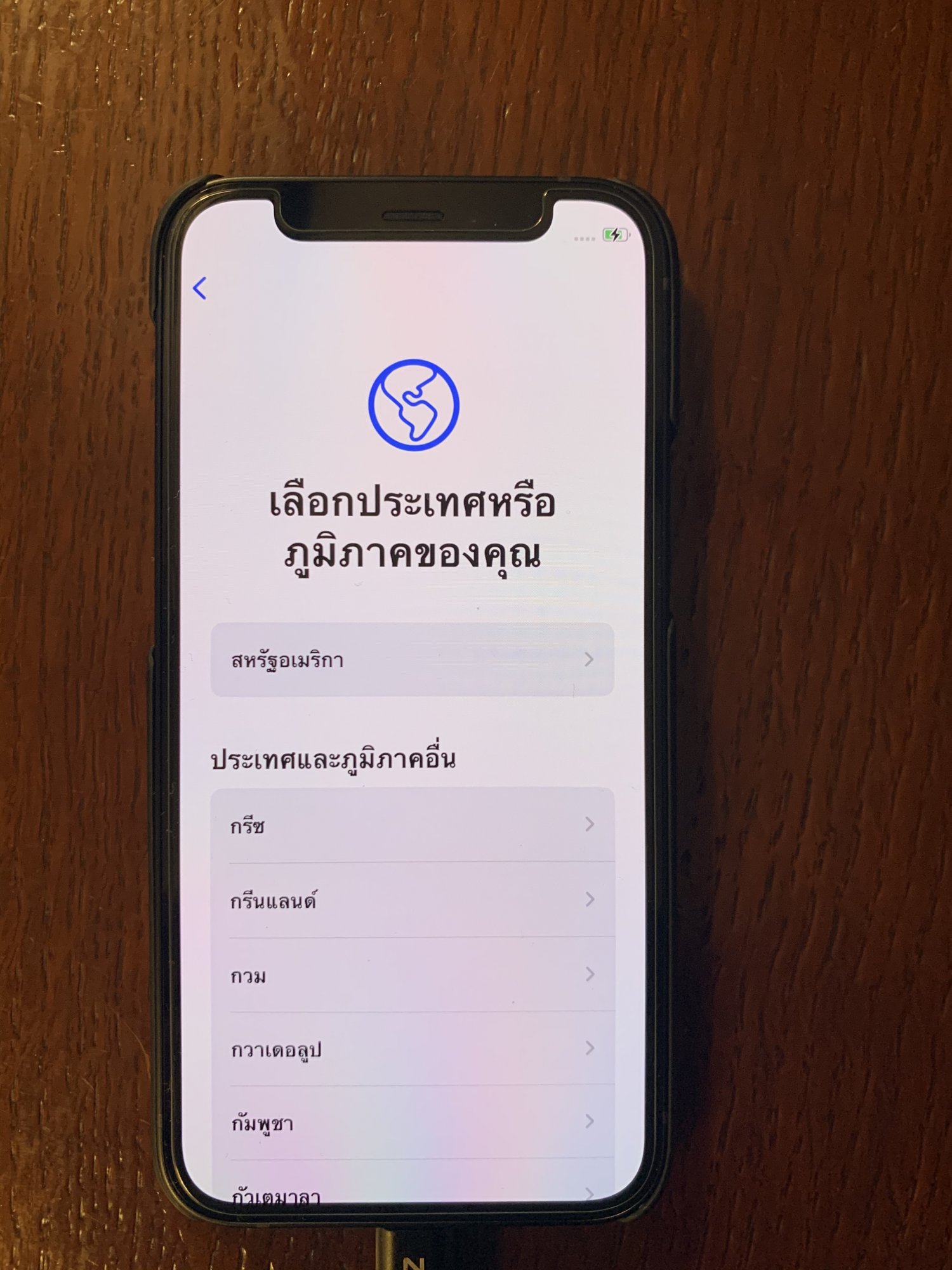

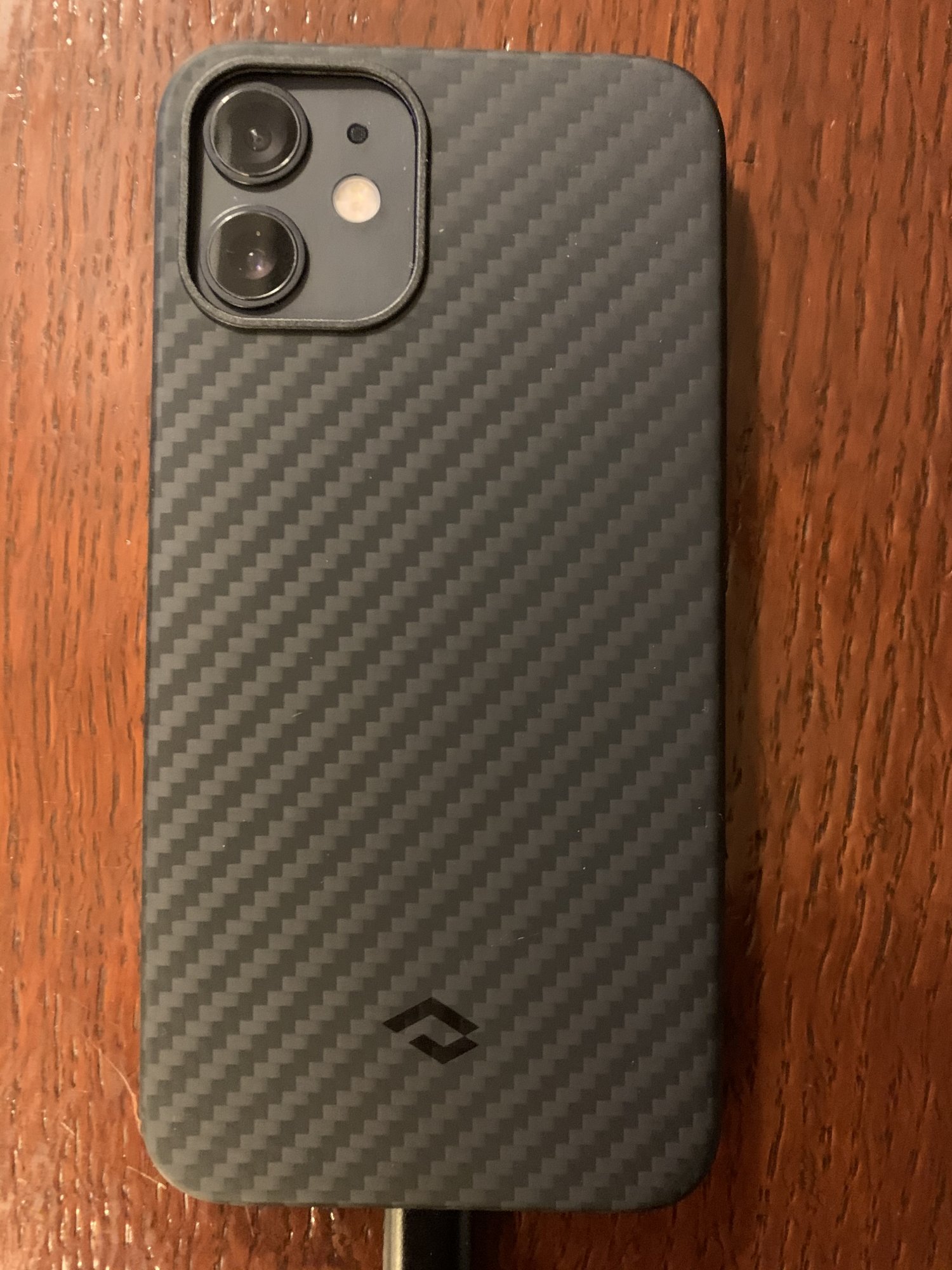

I put pitatka mageaz & spigen glass...every thing perfect working...kaa
