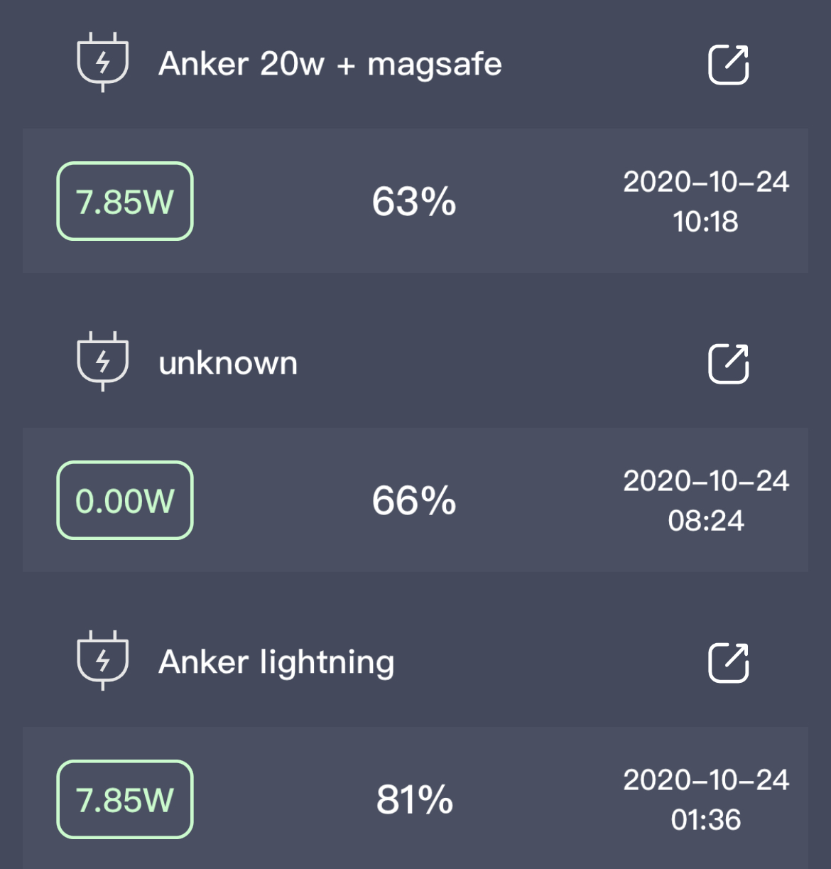

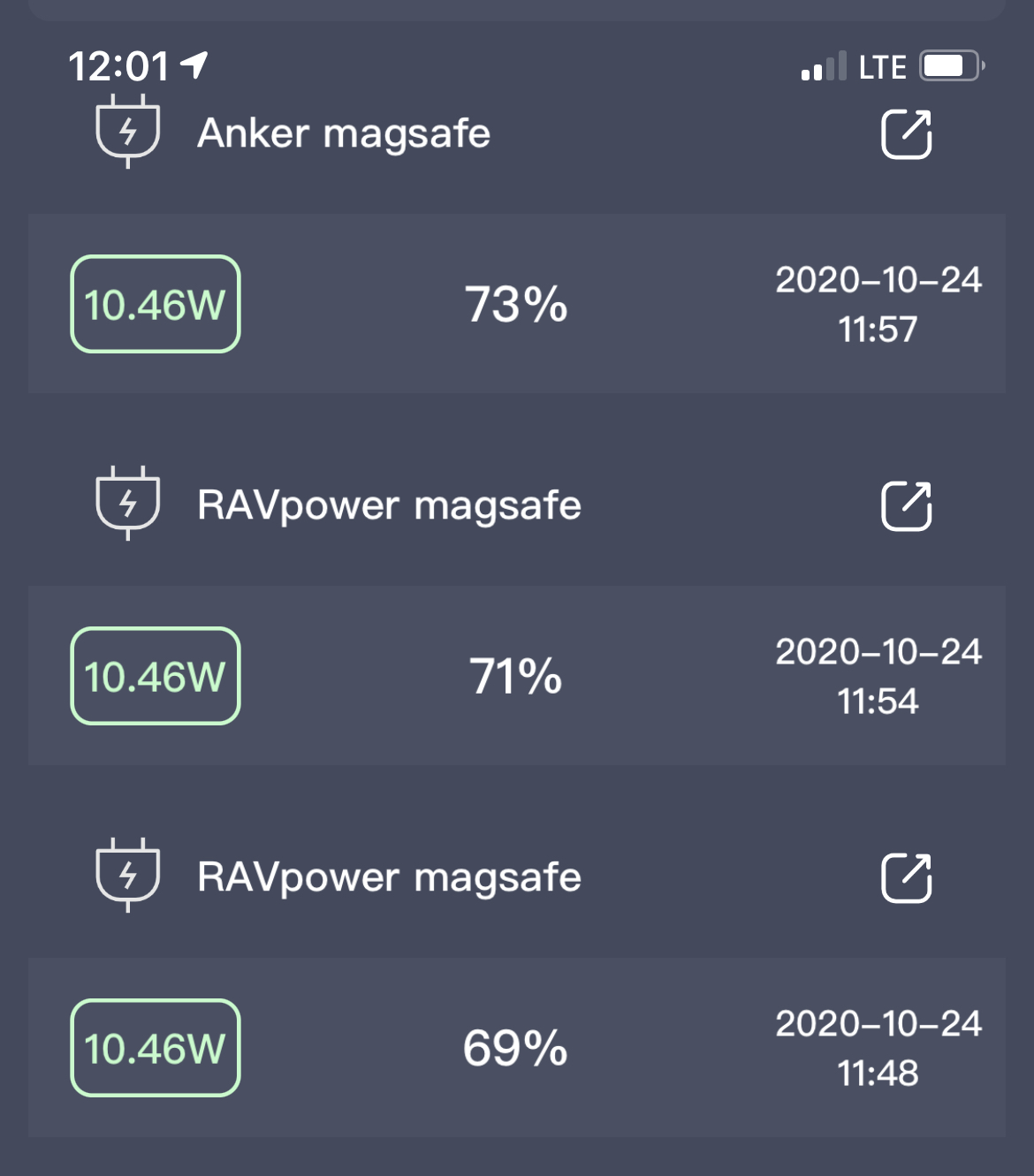

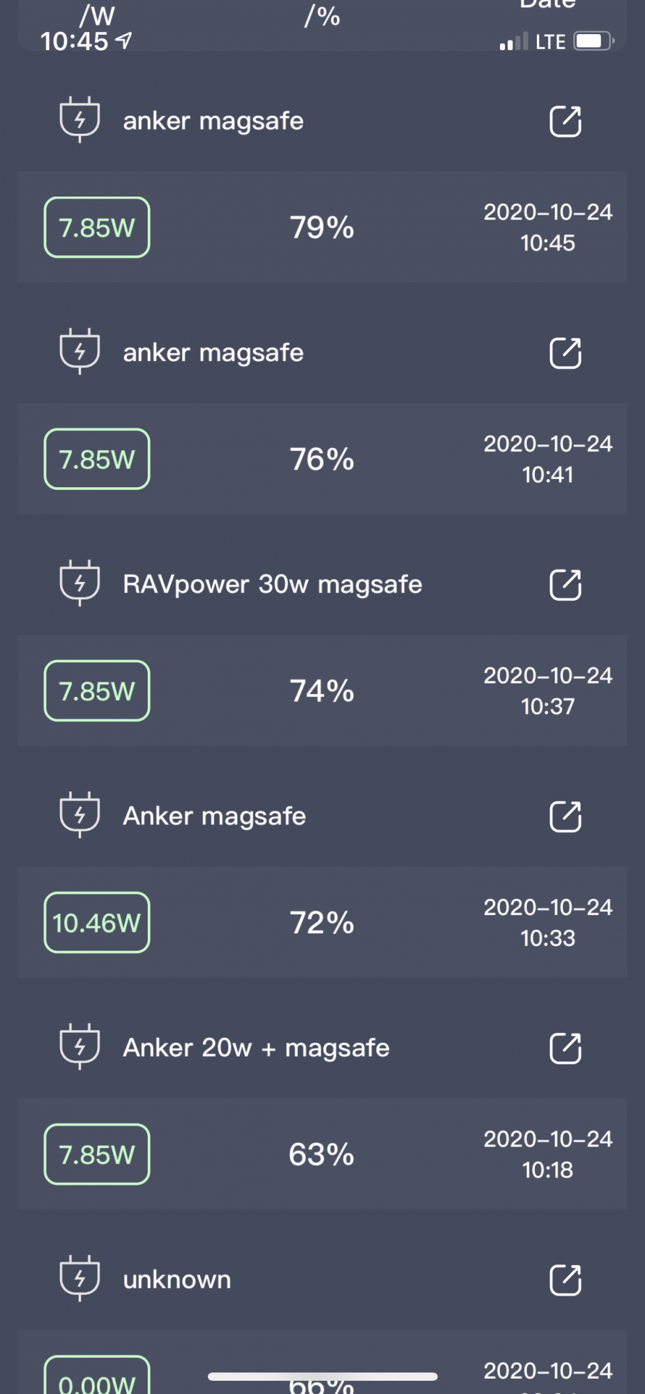

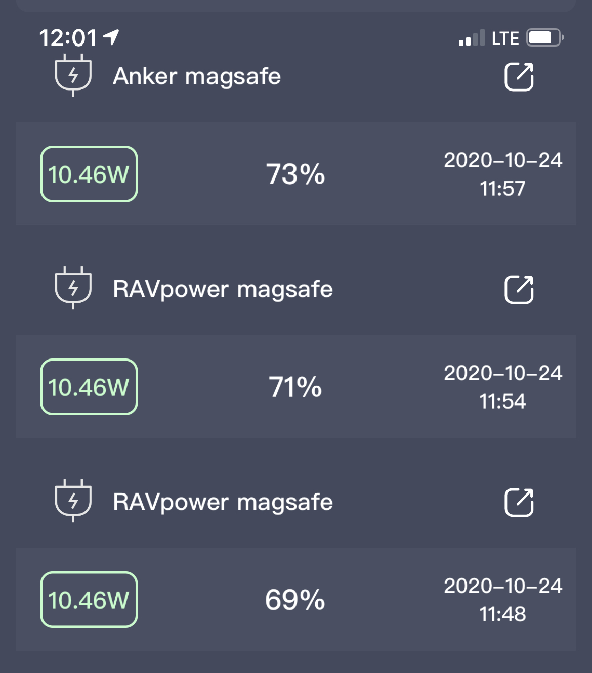

I retested after turning off battery management.
It charged at the same speed as lightening cable.
Now I am consistently getting 10.5 w from both bricks and magsafe with the battery optimization on.
Maybe the new phone needed to be broken in.
Thanks turning the power management of worked with my ohs iPhone 12 after rebooting. Then turned battery management back on it worked.
