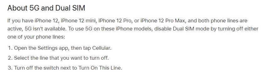

Anyone had success enabling 5G while using both eSIM and physical SIM? According the Apple 5G should work as long as one line is turned off, however I haven't been able to enable 5G. I'm on AT&T btw.
* I had iPhone 12 Pro with AT&T using PHYSICAL SIM first, and 5G was working fine.
* I went to AT&T today to move from physical SIM to eSIM. It moved over successfully but I forgot to check if 5G was working.
* I popped in my other SIM card in, set up dual SIM, then TURNED OFF this line.
* 5G option is nowhere to be found for my AT&T line even after reboot.
My other line is an oversea SIM only for receiving texts (2-factor and verification code, mostly) so I don't need to use it all the time. I was hoping I can keep the SIM in the slot and still get 5G for majority of the time.
Apple doc that shows turning off the second line should allow 5G to work:

Just tried it too, still doesn't work. Only see LTE and 4G under Cellular Data Options. Called AT&T support and waiting for a call back now.
I just came back from AT&T store. We activated a different eSIM on the phone and was able to get the 5G option instantly. Then I was able to add second SIM and, while greyed out, still see 5G options for AT&T line. Not sure what's wrong with the first eSIM.

There is a slider in the cellular menu to turn off one of the lines, when I do that 5G connects on the line that isn't turned off.

Not sure what you mean. I can do 5G on either ESIM or SIM if the other is turned off.
