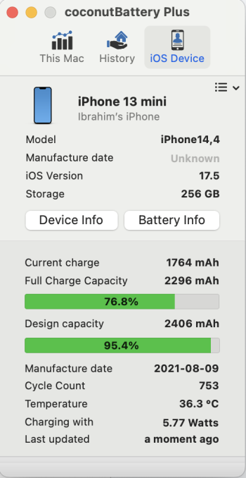

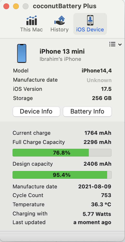

I'm pretty impressed by how the battery itself is holding up. 95.4% of original capacity, 753 charge cycles. The best Apple battery yet I've encountered. I don't do anything special but one thing to mention is I don't play any games on my phone.
I took my mini 13 on a 9 month thru hike of the Appalachian Trail [2,194.3 miles in 2022], so it has more charge cycles than yours. But 5 months later, I am still at 80% original capacity [and that's when I used to get free battery replacements, but now Apple changed it to 79%]. In January I started changing my settings to hopefully wear it down a bit quicker [no screen timeout, no optimized charging, running Coin whenever I'm driving, etc]. But alas, the battery still is at 80%

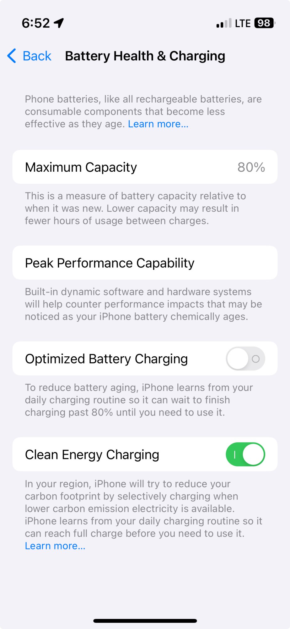

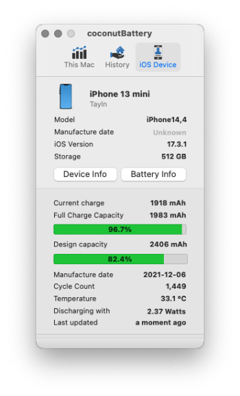

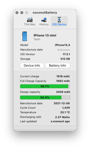

Interesting that Coconut Battery shows 85.1% when the iPhone itself shows 80%

Mine is (just checked) at 90% so just a tad above yours…
Still, after 18 months I think that's reasonable.
Well within Apple's spec.
Unfortunately our Minis are getting on a bit.
Still, if it drops to being unusable I will get the battery replaced.
This is indeed impressive. I have the same number of cycles as you and it is about the same age, but my battery is at 86%. I also don't play games. I use the camera a lot and make some videos but nothing crazy. I do subject it to some heat when golfing and cold when skiing so that may make a difference.

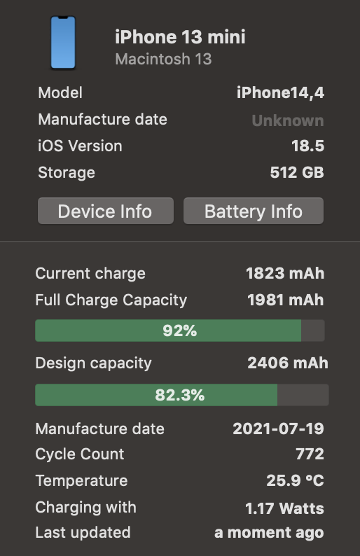

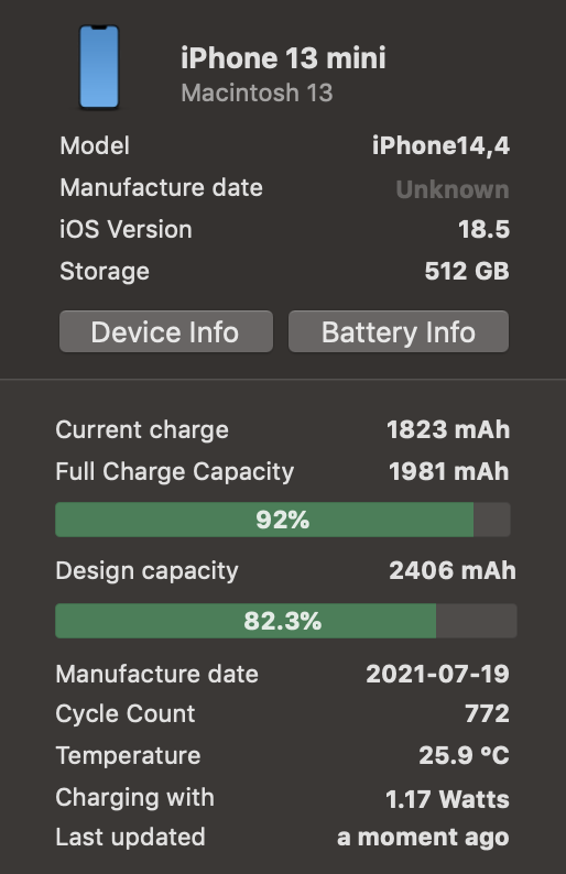

One year later am I am down to 80% capacity as displayed on the phone. It's been at 80% for several months now. However, when I opened Coconut Battery today, it shows 82.3% capacity.

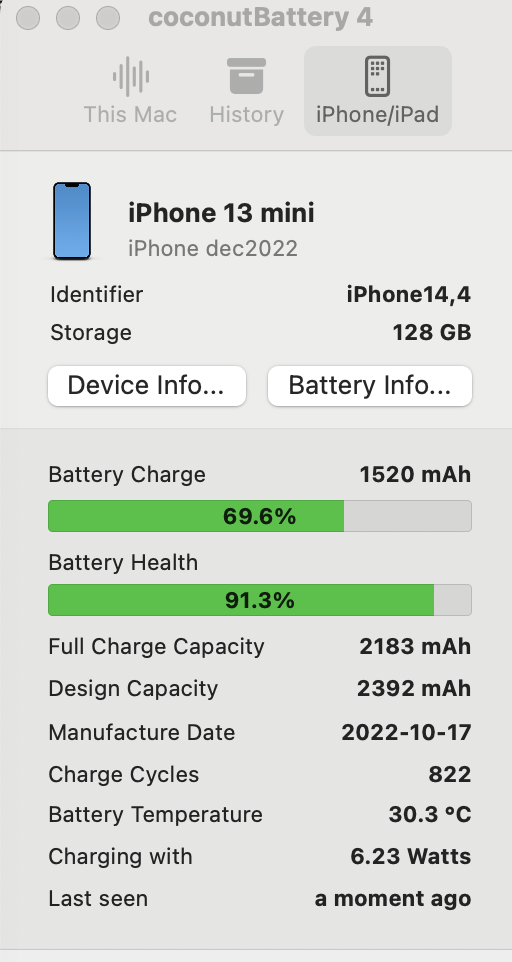

Thanks to your post, I looked up this info for mine and noticed for the first time that difference, that is,
Coconut battery says 91.3% (and design capacity=2392 vs. 2406), but my iphone settings app --> battery health has been at 89% for many months, at least 4-5 months. Strange, but I guess it's all just estimates and that 91 vs. 89 isn't too huge of an error margin.
that's too bad you are down to 80% but not 79%... in which case (if you had current apple care) they'd replace it free?
personally i go back and forth with the whole paying for apple care for every single device, every time, sometimes i do it, others not. In this case the 2 years of "care" was purchased, never used, and expired last Dec. 2024, and i opted to not keep giving them more $$ for it monthly... phone is still great overall but of course the battery life is... not wonderful.
I guess the difference is how it is calculated. Regardless, it's close enough.
There are actually two different calculation methods.
CoconutBatterie reads the Raw Max Capacity to calculate battery health.
This is the capacity physically measured by the system.
iOS uses the Nominal Charge Capacity to calculate battery health.
This is the capacity to which the battery is actually charged.
You will find these two values in the iPhone analytics files.
- Last_value_AppleRawMaxCapacity
- Last_value_nominalChargeCapacity
With a Design Capacity of 2406, your Nominal Charge Capacity should be approximately 2141 mAh in the analytics file (89%)
Batteries degrade over time according to their usage. To save your battery life, you can monitor the daily usage of your iPhone. Charge it when required and don't overcharge. Also, minimize the brightness level to save your battery.
I had my iphone 13 mini for 3.5 years or so. Battery maximum capacity shows 82%. Is that considered good? I never changed the battery. Do people normally change the battery every 2 years or so? How long did it take for your iPhone 13 mini to go from 100% battery capacity to below 80%?
I know it is said you shouldn't change your battery until below 80% but do most people do it? I definitely notice my battery wears out faster than when I got the phone new years ago.
I was at 83% after 2.5 years. And payed apple to change it cos i hoped it would improve more.
It increased from about 3.5h SOT to maybe 4h.
In the end it didn’t really matter cos usually i had to recharge it during the day anyway.
