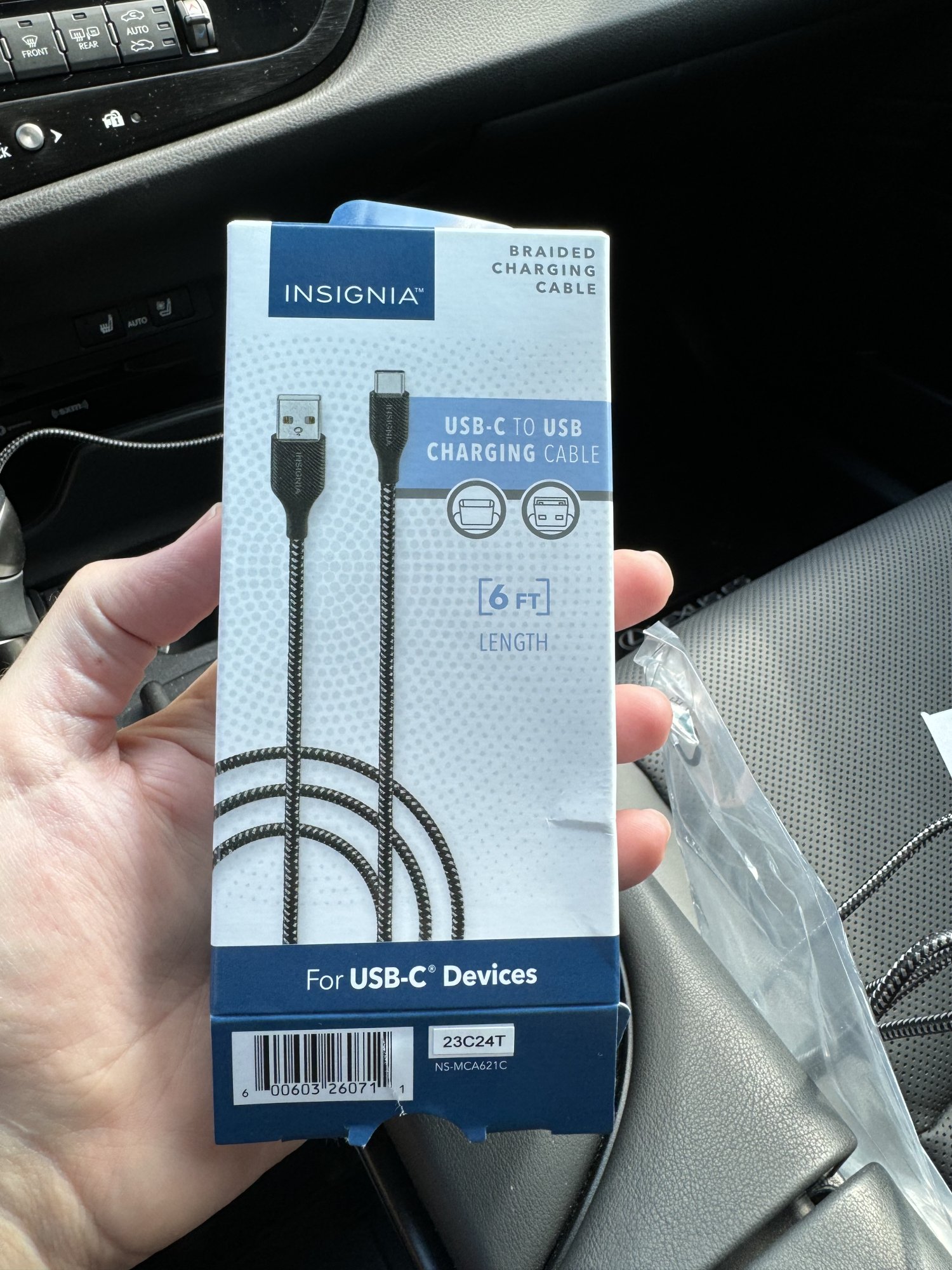

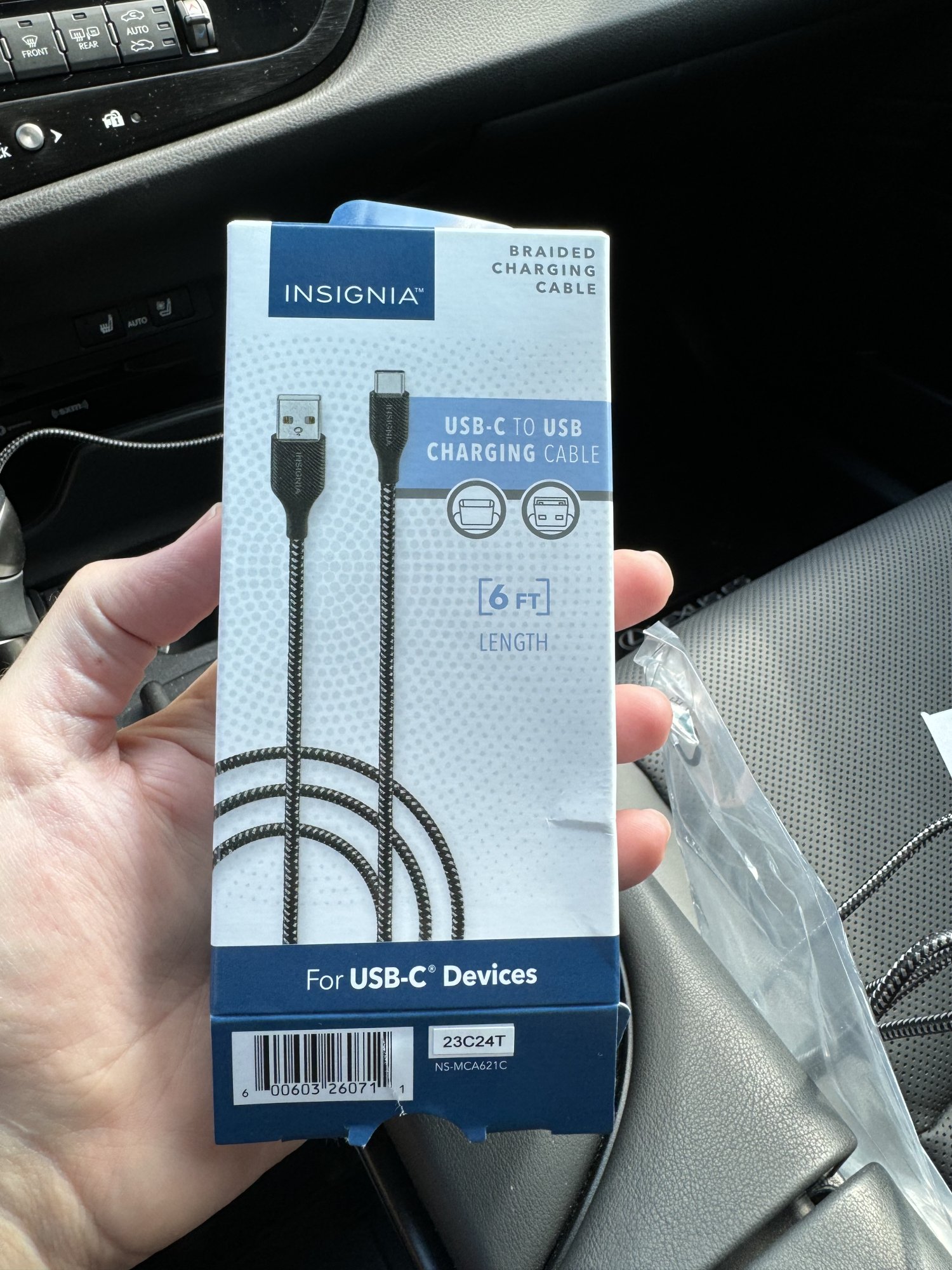

I just went to Best Buy and purchased insignia brand usb to usb c and it’s working perfectly. Has to state data transfer and charge on the back. It’s labeled as a braided charging cable.
This is sadly not the fix.
