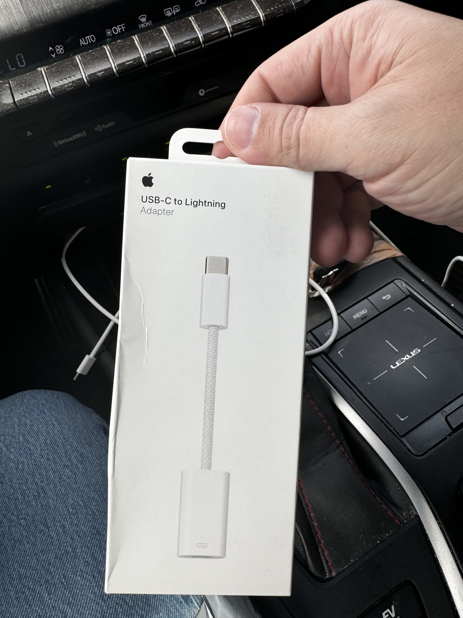

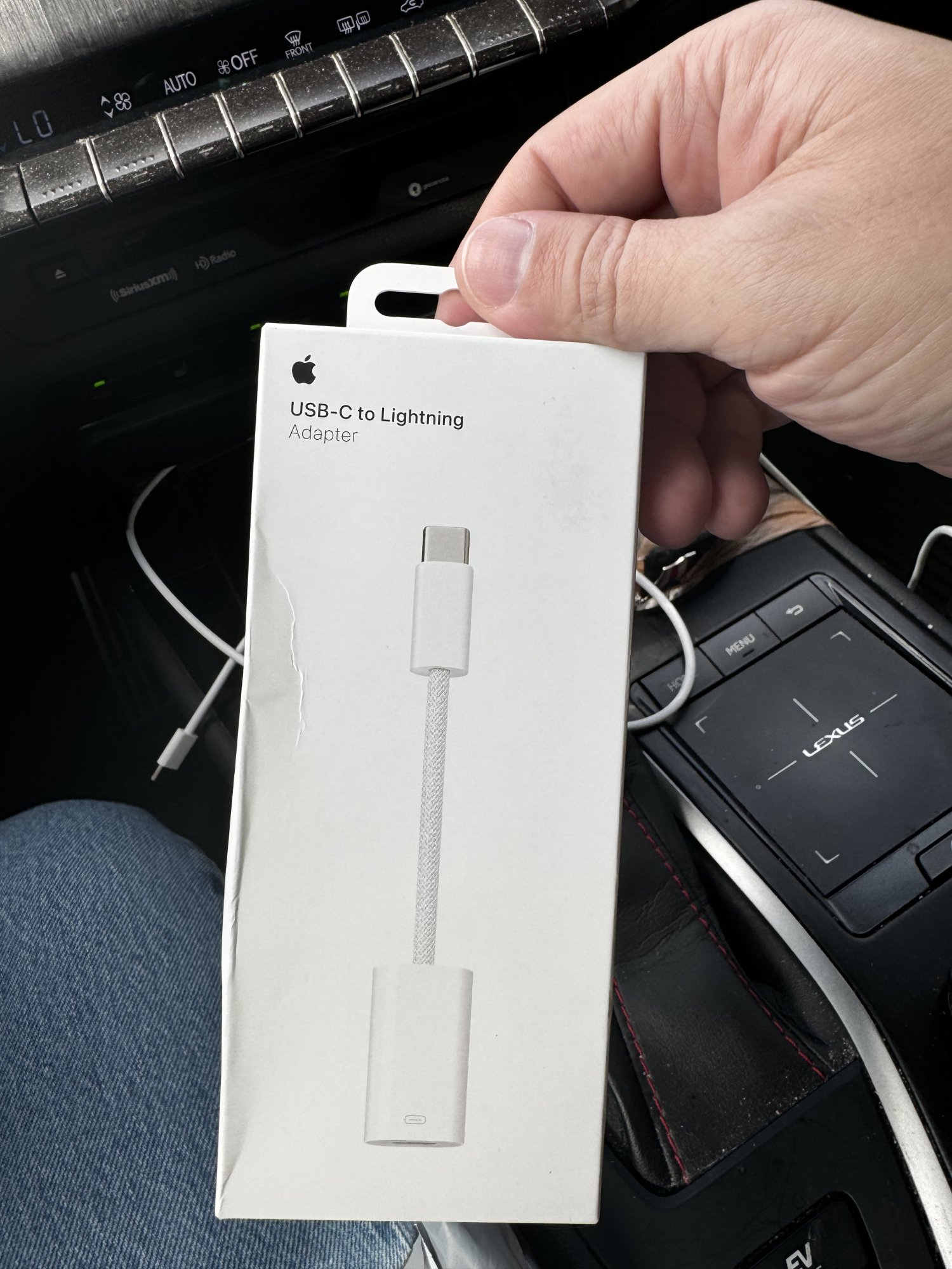

I am unfortunately experiencing carplay issues as well. I upgraded on Friday to the 15 pro from the 12 mini, which had zero issues prior to the change. I have noticed a lot of responses regarding the cable, so to possibly clear the air on that.. I am using a brand new official Apple lightning cable with the brand new official Apple USB C to lightning adapter. Apple doesn't make a USB C to A cable and opted for this adapter instead (annoying all on its own with such a leap from a cable that has been standard for as long as it has, but they gotta sell those USB C charging bricks somehow, right?!).
It worked pretty well on Saturday and Sunday, with one or two disconnects that I didn't think much of and a simple unplug and plug back in got it back. Then Monday, for whatever reason, that started occurring more frequently. Today, I plug it in, it pops up and within 10-15 seconds the carplay screen freezes, disconnects, and you can then watch the phone enter a loop where it connects "charging", disconnects, connects "charging" disconnects etc, which will go on as long as you will let it before you just unplug it.
So, it's not the cable... If it is, then no cable is reliable being that I am using Apples own official products. Send help...
