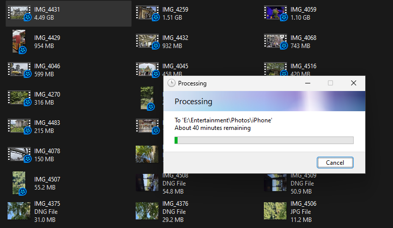

However, unless you're directly dragging files into the storage (which strangely it seems very hard to do so nowadays on both the PC and Mac), you'll still be stuck with a USB2.0 speed regardless of your handshake protocol, be it with iTunes, or with i4Tools on PC.
Frustrated!
UPDATE:
Tried dragging the video file from my iPhone directly to my PC from file explorer, and tell me this is USB 3.0 speed!(NOT AT ALL)

I tried to transfer a 19gb video from my 256GB iPhone 15 Pro to 512GB M1 MBP. 20min later, progress was minimal. I was using the USB cable for my 512GB Samsung T7.
Then I connected the drive to my phone. Surprise surprise, the video transfer was complete in just under 2min. Transferring from the T7 to the MBP took well under a minute.
Fantastic but these are the speeds that I expected to achieve between iphone and MBP without having to use an ssd as the intermediary.
