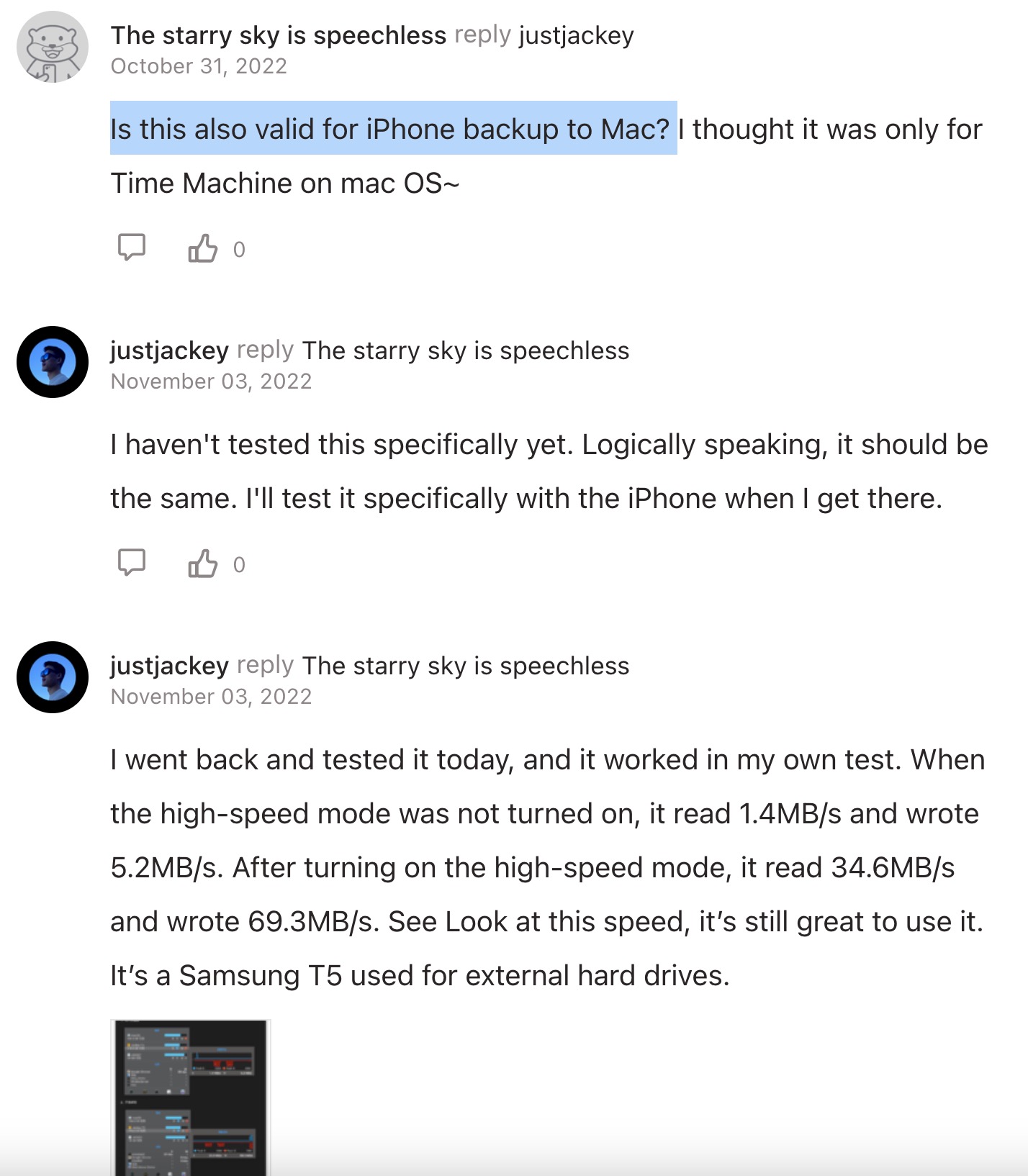

Bash:
# Useful for improving Time Machine backup prep. times, Mac App Store install speeds, etc.
sudo sysctl debug.lowpri_throttle_enabled=0
# To restore defaults
sudo sysctl debug.lowpri_throttle_enabled=1
Anyone tried this?
Does this help?

Bash:
Anyone tried this?
Does this help?
Ok, sudo does work in MacOS, but me thinks you are talking to the wrong crowd… 🤣
I don't know weather macOS limit the transfer speed by this option.
Because when I connect my iPhone 15 Pro Max to my Mac mini, it shows speed at 10 Gbps.
According to justjackey's test, it should work if data transfer was too slow and limited by macOS.
Now the question is, when this option is set to 0, can iPhone 15 Pros connected to mac run at the 10 Gbps that shows in system panel.

I stumbled on this thread and in particularly the Time Machine Speedup command that I am familiar with and use regularly, however I have only ever used it for Time Machine. Had no idea it was applicable to iPhone backups as well, which it definitely is.
Without the setting enabled, System Information was showing my iPhone connected at 480 Mb/s regardless of cable or port utilized. I deleted the backup I had just made and went to make a brand new backup from scratch. I enabled the
sudo sysctl debug.lowpri_throttle_enabled=0 command as I usually do when making a large Time Machine backup.
I'm pleased to report that after maybe 10-15 minutes, the new backup is already 50% completed. System Information now reports my iPhone being connected at up to 10 Gb/s. I wish there was either a way to make that command stay enabled so high speed transfer is always active, or honestly Apple should figure out how to make the transfer rate as high as compatibility of the cable and port utilized will allow. God knows how much time this could save people going forward who are simply unaware that there is a better way to go about the backup process. Hopefully I can remember to make sure I enable it every time I need to make an iPhone backup.
And of course, as always, don't skimp out on cheap cables. Just not worth the headache. Okay thanks for reading, I hope that was helpful!

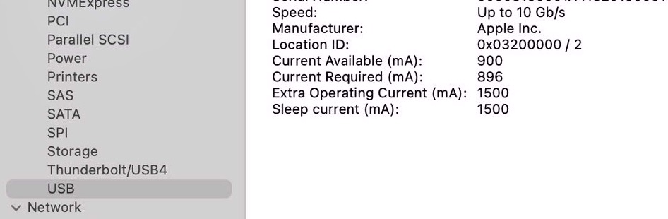

With my iPhone 15 Pro Max I get 10 Gb/s with a Belkin Thunderbolt 3 cable (F2CD081BT1M-BLK) and a Monoprice USB 4 cable (44117). Mac is MBP M3 Max.
iPhone:
Product ID: 0x12a8
Vendor ID: 0x05ac (Apple Inc.)
Version: 16.02
Serial Number: 00008130001C11DC2EA0001C
Speed: Up to 10 Gb/s
Manufacturer: Apple Inc.
Location ID: 0x02200000 / 1
Current Available (mA): 900
Current Required (mA): 896
Extra Operating Current (mA): 1500
Sleep current (mA): 2400
