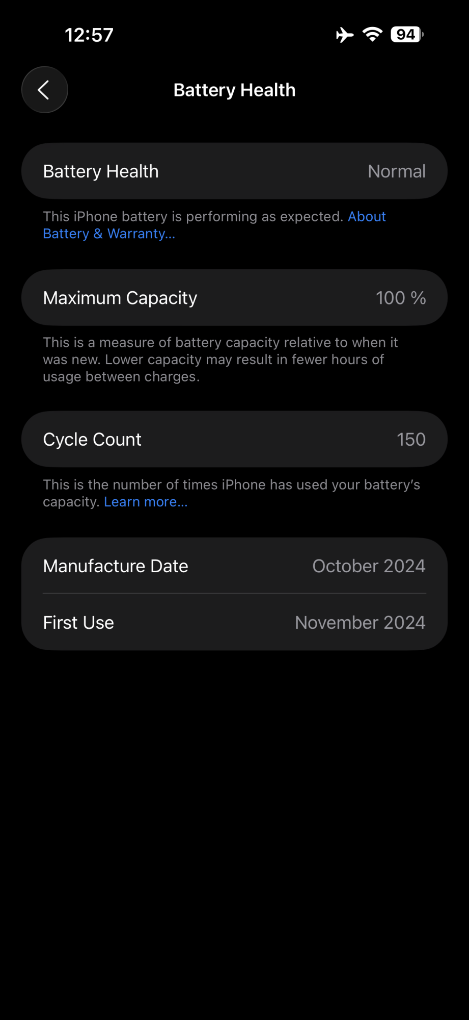

I did exactly the same. 80% charge limit, launch day 16 pro max. 220 cycles. Still on 100% max capacity.

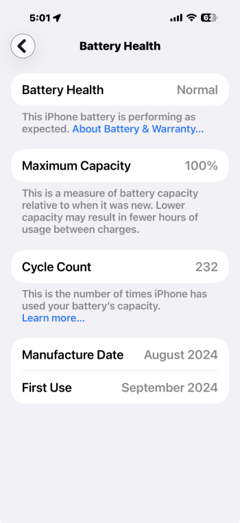

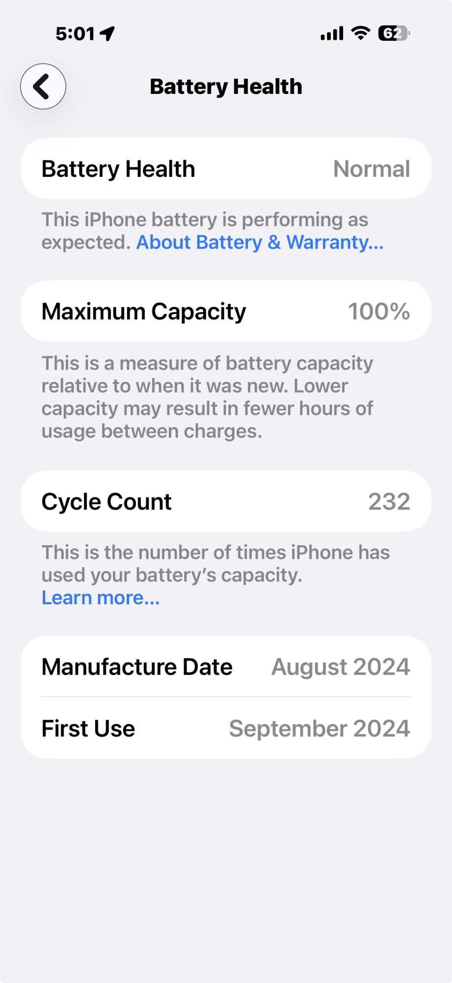

iPhone 16 Pro Max
First use October 2024. 226 cycles, 100% health.
