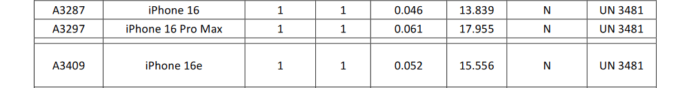

Apple does publish battery capacity specs in their compliance docs.
Apple marketing materials make it sound like the C1 is doing the heavy lifting. According to Apple specs, the battery capacity was increased by 12% (Wh rating) compared to iPhone 16.
For every 1% increase, the video streaming battery life tends to increase by 1.3% to 1.4%. This is similar to what we saw with iPhone 15 to iPhone 16. C1 isn't magic. Apple just added more battery to the 16e because it doesn't have a second rear camera.

I learned about this mAh vs. Wh thing several years ago — it's a common thing pointed out on the internet.
I'm not sure what the argument is here, though. The sentence I wrote in the article was merely a fact, that Apple doesn't share mAh figures.
For whatever reason — perhaps because iPhone battery voltage typically remains constant — many people are really interested in learning the mAh figures.
So I shared the 3,961 mAh figure, as new information.
That's it.
Nevertheless, I'm always willing to add more detail to my articles where possible, so I added "provided that the iPhone 16e's battery voltage remains the typical 3.85V." I don't feel that it's an entirely necessary statement until iPhone battery voltage is proven to have finally changed, but it doesn't hurt to add.
You were replying to JPack’s comment pointing out that we already have official information from Apple (and therefore don’t have to rely on Lee’s information) with “Yes, in Wh. The article correctly states that "Apple does not publicly advertise mAh battery capacities for iPhones."”. This reply read as if Wh were somehow not good enough and independent information in mAh was needed, and as if you didn’t know that the corresponding mAh values can be trivially calculated from the Wh values. Nobody contested the article’s statement that Apple doesn’t advertise mAh values.
Reactions: JPack

iPhone 16e is a perfect example of why sharing mAh alone is misleading.
The numbers 3,961 mAh and 15.556 Wh imputes a voltage of 3.927V. This is never before seen on an iPhone battery.
If we just looked at mAh, we would have thought battery capacity only increased by 10%. In reality, it is closer to 12%.
