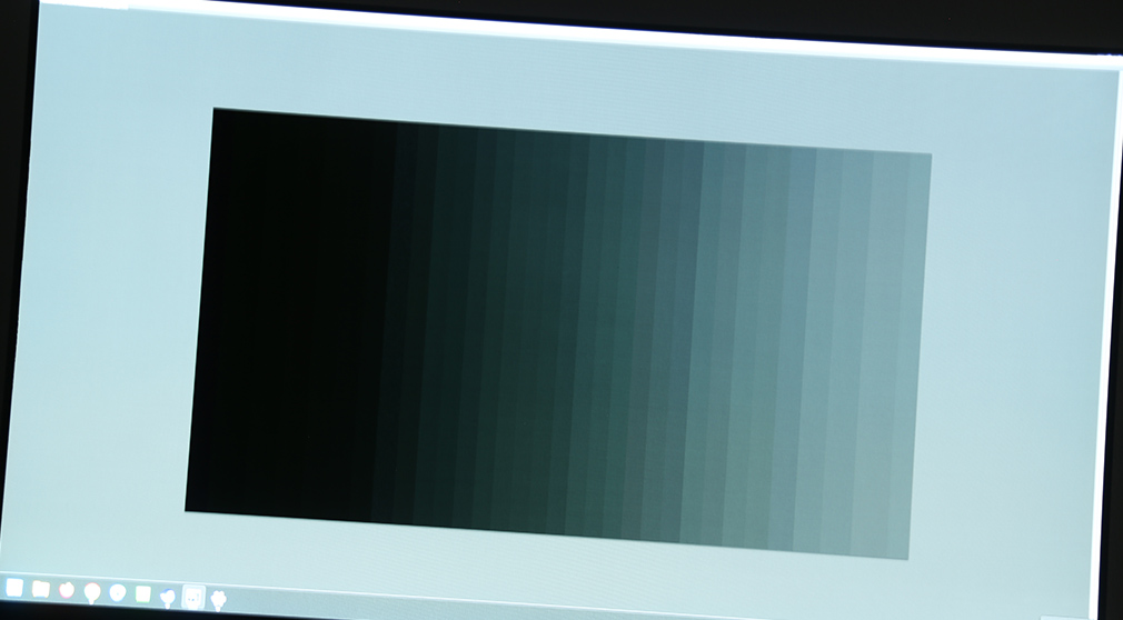

Here is an RGB(0,0,0) to RGB(31,31,31) gradient on my LG CX OLED TV set to maximum OLED Light (brightness) in SDR mode with my DSLR camera set to 3.2 second exposure time:

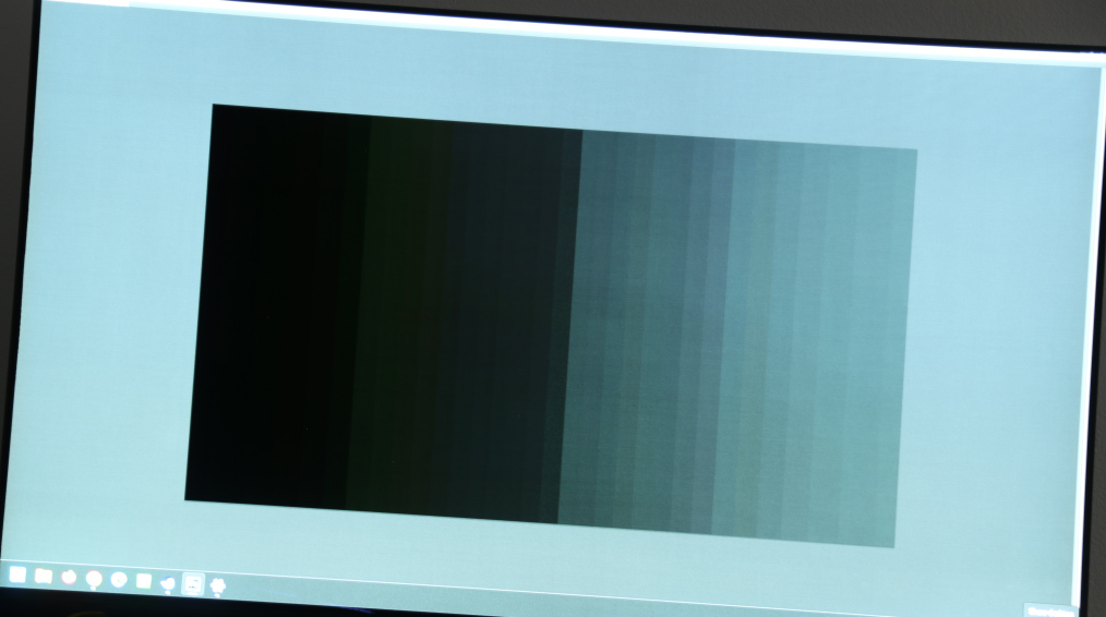

Here is the same gradient, but with the TV set to minimum brightness, but with the camera set to a 15 second exposure:
The image quality is significantly worse at the lowest brightness setting.
There is about a 5x difference in light output between the brightest and darkest settings.
On my Pixel 8 Pro, there is about a 500x difference between the brightest and darkest settings when manually setting brightness. And it's nearly a 1000x difference if you include auto brightness when using the display under bright light.
The performance demands on a smartphone display are enormously higher. It's not about cost savings.

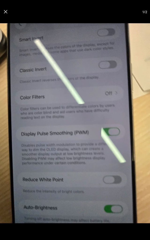

Is there a chance that the PWM toggle switch will roll out to older phones like the 15 series?
Maybe, but I don't think so. Apple being Apple might be quite aware they can boost the sales a bit more with this feature exclusive to iPhone 17. Or it's just available on the latest models because of an updated display controller. Nevertheless none of those cases indicates that this feature will be rolled out on older phones.

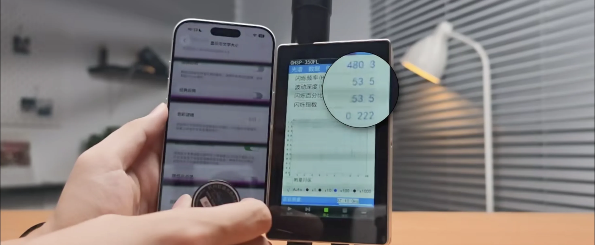

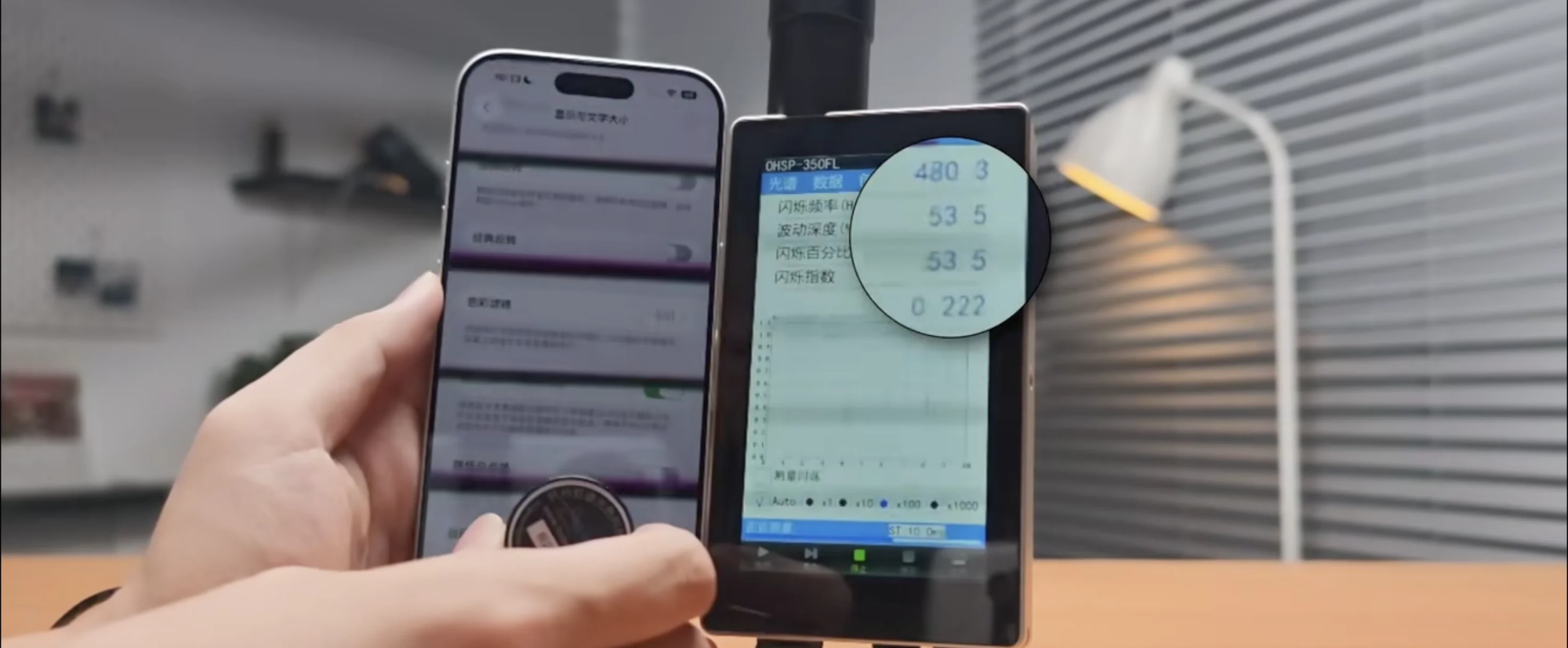

First chinese reviews are out.. and WHAT A SURPRISE it's a total lie. It basically reduces modulation but doesn't remove PWM at all.
Not sure why I expected anything better from Apple tbh - cancelling my pre-order 🙁
Modulation is a huge deal as well though so don’t completely discredit it.
it is.. but a result of 50% modulation is still very bad, and is not 'disabling PWM' in any shape or form.
You’re not wrong but that’s assuming what you’re looking at is accurate. Additionally, traditional there’s been differences in every model so time will tell.
Yes, the topic can be closed. Friends, at least Apple has started moving in this direction! See you in a few years.
My question is, do the black bars get wider at a lower brightness? If not, this should still significantly improve comfort at lower brightness levels for most people. Perhaps the hardware can't be pushed beyond ~90% pulse width.
I suppose if the pulse width is consistent across brightness levels, they can truthfully say they don't modulate the pulse width to adjust brightness.
The wider the bars get the worse it is typically. What I’m hoping we’re seeing, and everyone is jumping the gun on, is something similar to oled tvs. All oled tvs are technically not flicker free with a slight dip that corresponds to the refresh rate but even folks extremely sensitive to pwm barely notice. This shows up as black bars on your tv as well.
Additionally, I believe oled monitors do this as well which is why they are often certified as flicker free by 3rd party companies.
