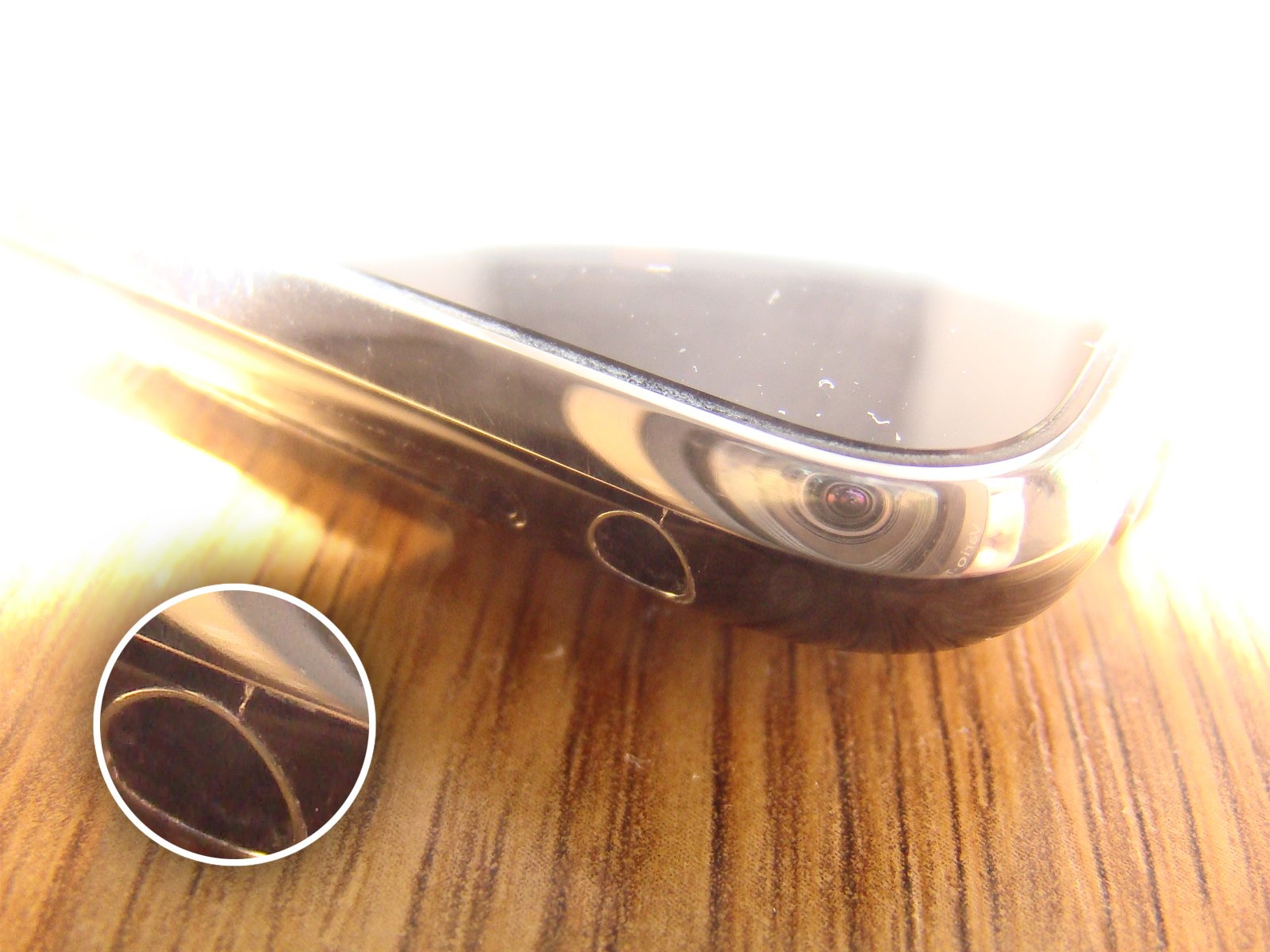

I'm adding that a few weeks ago, my right headphone (the one with the microphone above) stopped working while listening to some music. I was planning to send my headphones in warranty, but a few days ago noticed the problem mentioned in first paragraph and the second problem attached in the photo (small crack between headphones hole and the metallic frame).
I'm also adding that I've never dropped my device and I've restored it to default settings and software (2.2.1), until this post and nothing changed.
Any suggestions ?
Thank you.
