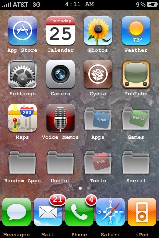

I have the same issue with both of my 3G phones, says its fully charged, but it stops charging and is not 100%
