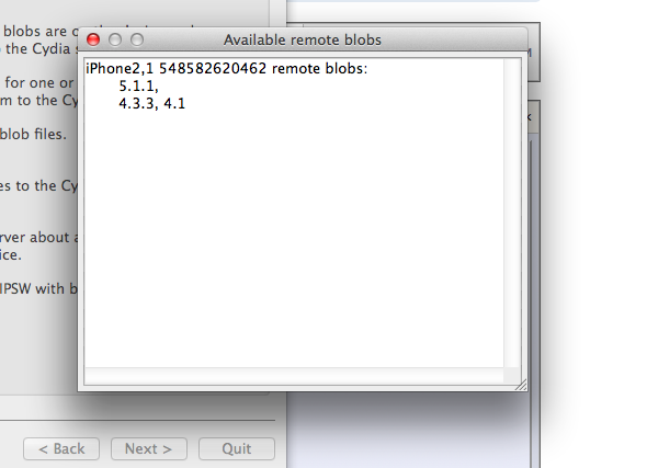

I am really sorry, but being a beginner, I tryed in redsn0w to click on extras and then verify and this is the result... maybe this can help to downgrade?!
Yes if really needed you can downgrade to 5.1.1 get untethered and unlock with ultrasn0w.

If it doesn't work you can downgrade to 5.1.1 with redsn0w
In that case you can skip the 6.0 step and go to extras/even more/restore with a downloaded 5.1.1 ipsw, remote blobs and preserve the BB, after that you can jailbreak with redsn0w and install ultrasnow again
