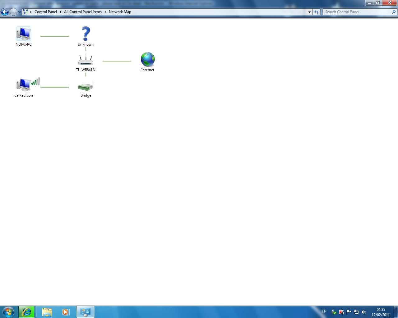

ok so here, on my PC (desktop), the computer that is connected and managing the router, I go to Network Map and get this:
NOMI-PC = the dektop computer.
DARKEDITION = my laptop
I don't see any other devices, does that mean my iphone is not connected to the network?

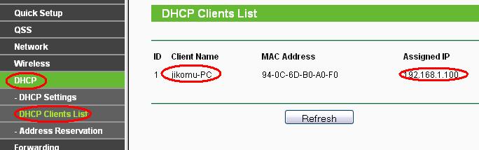

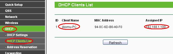

No. To get into your router, you would open your browser and navigate to something SIMILAR to "192.168.1.1". Sometimes it's 2.1. Sometimes 0.1. You never know. It might be written on your router. But you can probably just google the brand and model number. You will also need the username and password you it which is usually "admin,password" or something simple. But again, just search for it. You will find it. Once you're in, look for "DHCP clients" or something. Just click on everything until you see the names of your devices connected to the router. If you don't see the iPhone, wait a few minutes and refresh. It goes off and on over and over. If you still don't see it then it must not be connecting.
ok got it. but where do i see a list of devices connected? here's what i see:
and i looked into all those options on the side, couldn't find a clue..

Try DHCP or network. Or everything. All routers are always different. You're really just going to have to click through everything. Look through each page, every option, until you find it. It took me a few minutes to find it on my own router and I've done stuff like this before. Just look around.
***** YEAH
lol got it guvner. listed as Johnns-iphone with ip and all.

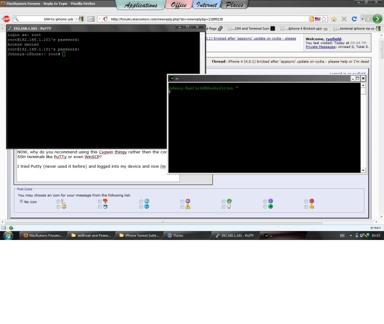

NOW, why do you recommend using this Cygwin thingy rather then the common SSH terminals like PuTTy or even WinSCP?
I tried Putty (never used it before) and logged into my device and now i'm here (current Putty screen on the left, current Cygwin screen on right).
What you reckon?
what directory am i suppose to be in when i type your command lines?
i cant see your screenshot... anyway, i only recommended cygwin because thats what i used, and it worked. if you want to use something else, i see no reason not to, but i have no idea if the commands would work the same or if they would require modification.

i see. thank you very much. i have managed to SSH into my device's directory (using Winscp which is also recommended in the link you provided). do you think I could just find those to files (packages) that **** up the booting and delete them? I'm sorry for the bother, but this Cygwin looks really complicated and you know so much more than I do about this stuff
i only know what ive learned on that tutorial. you can try that, but if you just do what the tutorial says, i promise its very simple. just install the service, enter a few commands to set it up, then enter the commands i posted.

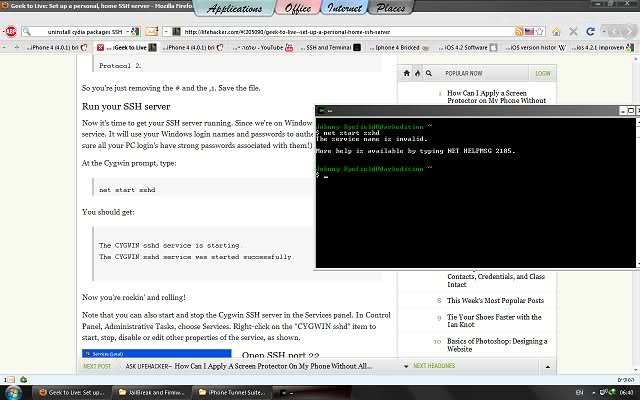

this is what i get upon typing the command:
(the service name is invalid)

ok lad it worked! i used winSPC and fixed the commands! you are topboy son. topboy. cheeerss!
