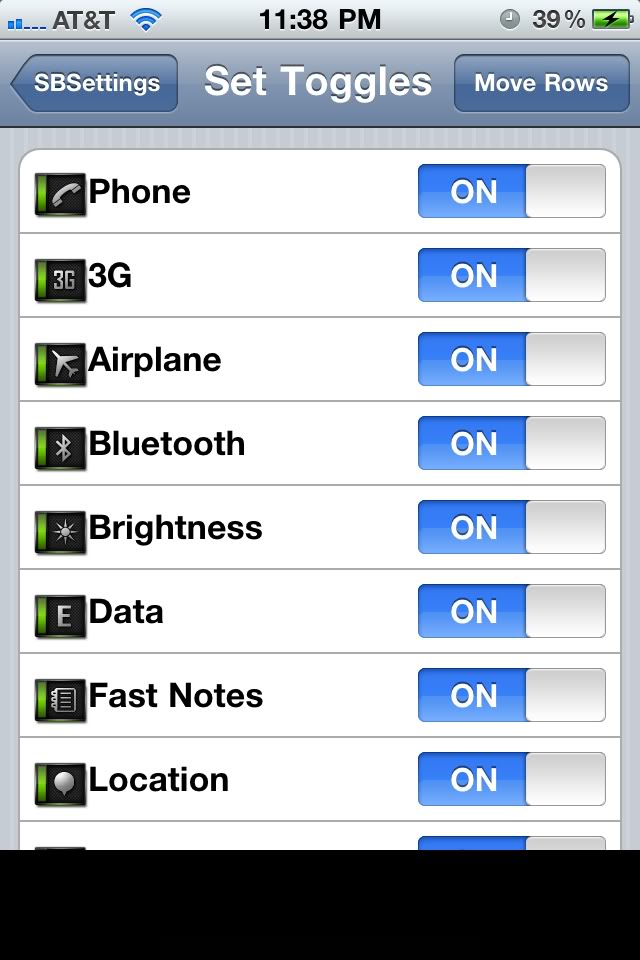

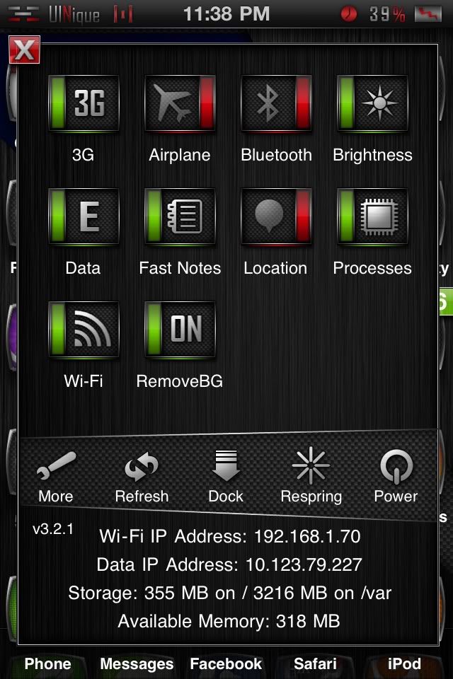

First off, i will admit that i'm a n00b at jailbreaking. I had it on my iphone 3GS and now my iphone 4. There was a SBSettings toggle on my 3GS jailbreak that would turn my phone app off, and my signal bar would appear "no service". I have installed SBSettings on my iphone 4 and tried everything but it just wont appear on the sbsettings slide down menu. Is anyone else having this problem or know a way to fix it. Any help is GREATLY appreciated.
My phone toggle appears fine on sbsettings.
Make sure its enabled. Open Sbsettings/more/set toggles and then select "phone" toggle to on.
Then go back to the previous tab you were on sbsettings and the phone should respring. If it doesnt do it manually.

I have the same issue. I...
Flipped the toggle back and forth rebooting....Nope
Re-installed sbsettings...Nope
Uninstalled sbsettings, deleted var/mobile/Library/SbSettings/Toggles, rebooted, installed sbsettings, rebooted....Nope

EDIT : I think I'm onto something, using SBSschedule, I only have 3G, Airplane, AutoLock, Bluetooth, Data, Location, Wi-Fi in the list of toggles...the only toggles that SBS Settings can show.
It's gone, I just got that after sending en email to BigBoss via Cydia : "4.2.1 and newer users: Phone toggle does not work and has been disabled. It is not a "bug" that it does not show up. Use airplane."

It also seems odd that the option activate the toggle would still be on the SBSettings Set Toggles screen when the toggle itself has been disabled.

Hey everyone. Long time MacRumors:Forums follower, first time poster here. Yesterday I updated my iPhone 4 from 4.0.1 to 4.2.1 and rejailbroke. I noticed that the phone toggle didn't work so I started to look around online and stumbled on this post. I was dissappointed to find out that they turned the phone toggle off. Hopefully someone can create something similar and throw it up on Cydia for us.
