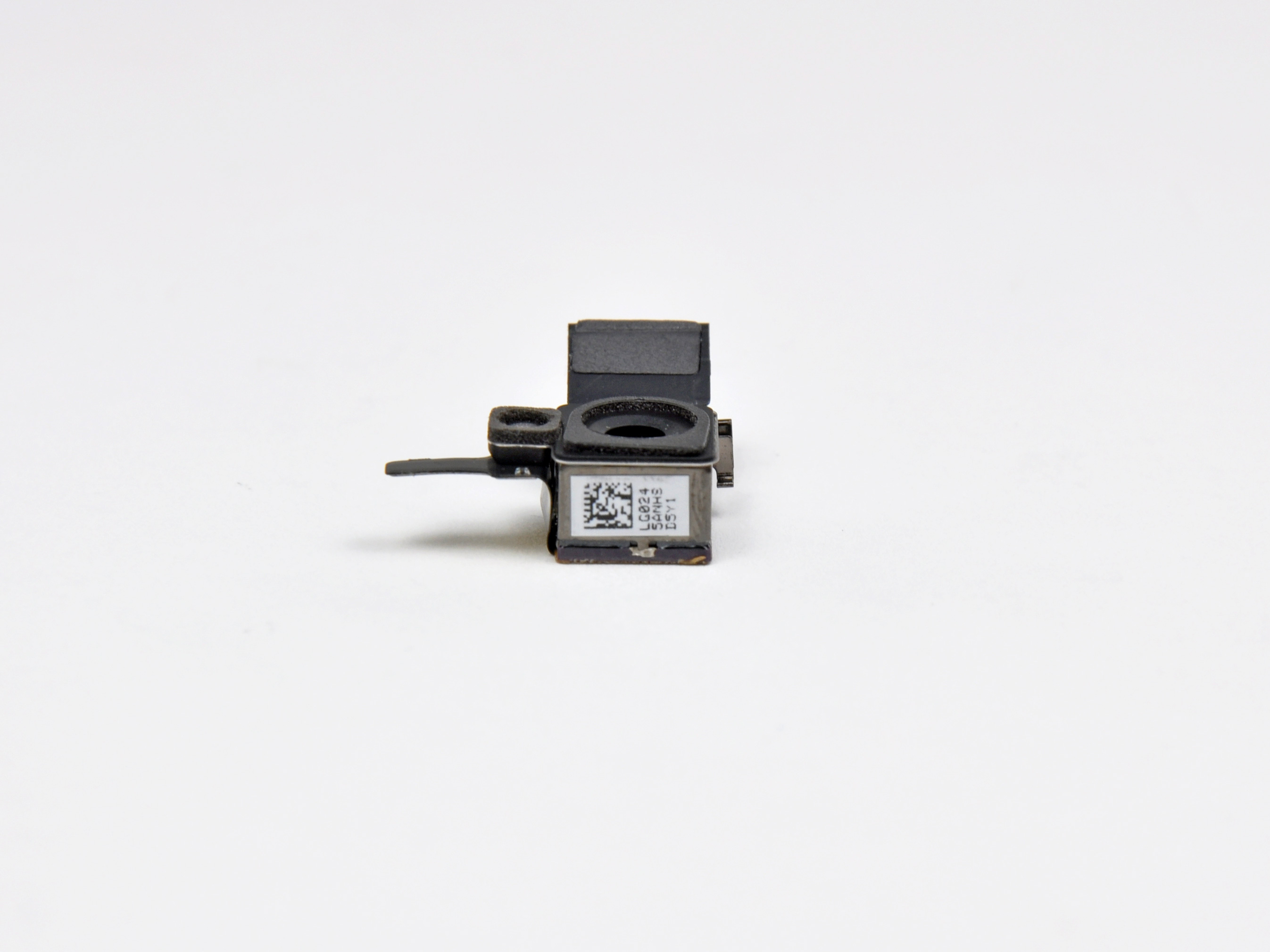

The LED is the little box hanging off of the left side.

This is 95% caused by liquid damage. The other 5% would be dropping it too much. A camera replacement will not fix the light. The entire phone needs to be replaced. If you have applecare it can be swapped at the Apple Store for $49 or $79 depending on when you bought applecare. If no applecare then it's $149 for iPhone 4, $199 for iPhone 4s, and $269 for iPhone 5, 5C, and 5s. If by some chance it's not liquid damage, and you are still under warranty or have extended applecare, it will be a free replacement.
FALSE
I've done this repair multiple times and after changing the camera the flash problem is fixed. Looks something like the image below could be dimmer or a lot brighter depending on the damage.
Also attached where you could get the part pretty cheap actually with tools

I'll admit its possible a camera replacement will fix it if it's NOT a logic board issue, l but if it's liquid damage it's only a matter if time till the phone stops functioning completely due to corrosion. Plus the OP doesn't know what a DFU restore is, I doubt he/she will want to or be capable of a camera repair. Although it is pretty easy, I have done it multiple times.
