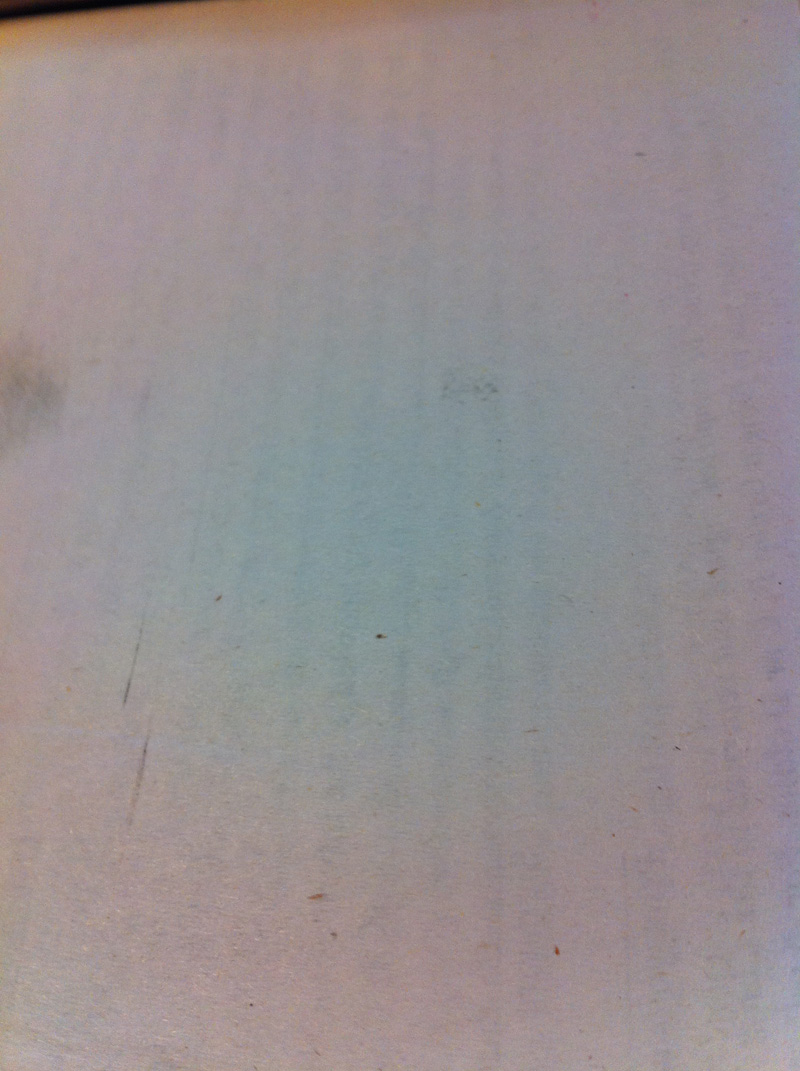

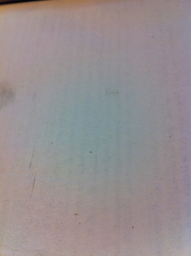

I just did the test and I have the same blue tint.
My faith in Apple is dropping like a rock.
I have owned a crap load of Mac products. I am a freakin Apple evangelist in my family for Gods sake. This is embarrassing.
Great.
attachment.php

Read my previous posts, this is normal behavior for a camera in fluorescent lighting. While a update to how the camera processes the image may help this is not apples fault, it's your fluorescent lightings fault.

I read your post and thought my ceiling fan was running incandescent bulbs. I stopped the fan and checked, and they are fluorescent bulbs.
I reshot a pic under incandescent bulbs and it looks good.
Thank God.

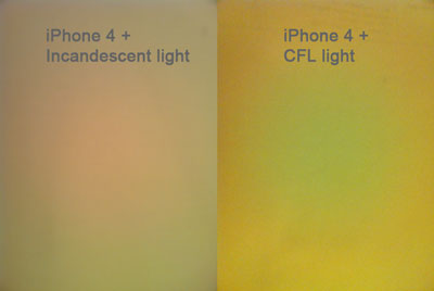

Are you in a room with CFL or any sort of fluorescent lighting? Your MBP has a CFL backlight you know 😛

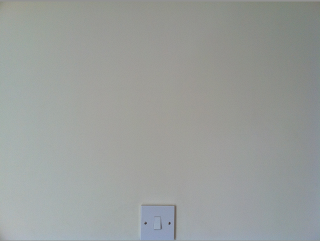

Fluorescent lighting will cause the green tint, the iPhones lens or one of the elements tends to over exagerate it for some reason (if you look at the lens its already a green'ish tint). I noticed I have the same green tint at my office, outside no green tint. My house is mainly CFL, during the evening I can see a slight green tint against my wall, in the day with natural light no green tint on the same wall.
This is not an issue with the phone, its the type of lighting that you are in and its affect on the camera lens. I'm surprised a photographer hasn't already chimed in here on this considering how many of them are on this forum.
I tested again and no green spot! Thanks !!! 😀
I'm over all of these issues (e.g., reception drops, green spots, etc.) and am going to try to stop being such an Apple perfectionist. The phone works. 😱
Go outside and take a photograph of a white surface and it will be entirely 100% perfect. Nobody photographs things under fluorescent light anyway. At least if you do you probably don't care about what you're photographing very much.
