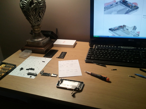

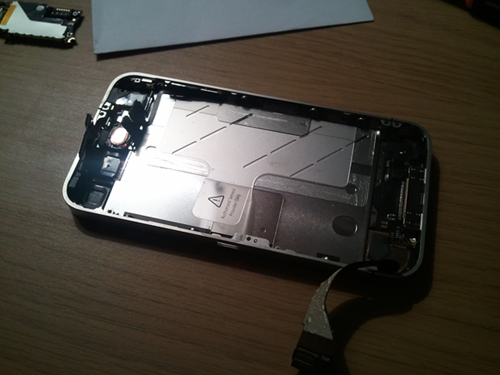

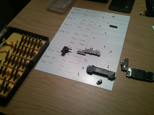

I'm just after spending the last 2 hours replacing the home button on my iPhone 4 using this link. Job complete and working as good as new :D
and here is the culprit that was causing all the problems!

I didn't notice any difference between the two buttons. The old button still did the clicking noise just like the new one. I couldn't tell the difference between the two of them. The problem may have been caused by the flex cable or it may have been slightly off centre underneath the actual home button.

I did think about sending it off to a repair service but after looking through that step-by-step guide in the link I posted above and with the right tools I decided to give it a shot myself. The actual home button cost me about 4 euro/5 dollars on eBay.
Judging by your photos, it looks like you didn't take out the display/digitizer? Or am I wrong?
How difficult was it to disassemble? I'm afraid of screwing up the screen/digitizer if I do this :(
That's only a few photos I took. I did have to take out the display to get to the home button flex cable.
It took me that long that night as it was my first time doing it and I just wanted to make sure I didn't mess it up and I followed the instructions carefully.
I have done it once since and I had it done in about half an hour.
As long as you follow the step by step guide you should be ok.
