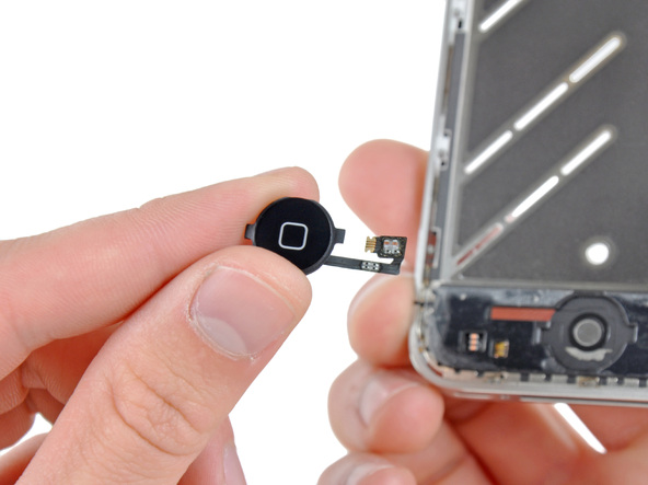

Although there's something I don't get, or am understanding it wrong; maybe someone can clarify. The home button itself isn't the actual button, is it? By that I mean, it's not the part that actual gets pressed down? Because if you take the phone apart, the button itself appears to be underneath the plastic "button," which doesn't make sense because the plastic part has the ribbon cable? How exactly does this thing even function? If I understood it better maybe I'd see why it doesn't work as it should.
Look here for what I'm talking about...see the metallic round thing on the actual phone assembly? Isn't that what one would assume is the real button?

The part that produces the tactile click is a little metal flexible dome, with the top of the dome facing towards the back of the phone. The flat bottom of this is connected to the ribbon cable and has a sticky pad. You remove the old one, remove the backing from the new one and carefully stick it to the plastic home button. You will need tweezers to fit the ribbon cable back into the cable retainer.
Appleipodparts is a UK based provider of genuine parts.
The button part and cable is sticky - when you get a new one, you peel off the backing and carefully stick it to the plastic home button. You willneed tweezers to fit the ribbon cable back into the cable retainer.
Ahhh okay that actually makes sense. So I was wrong when I said there's no adhesive, I guess it just wears away much too quickly.
Sorry for double posting, but I want to report that I did end up buying a replacement home button, and just finished installing it. I had a lot of trouble with the putting the ribbon cable into its socket, and realized that the little retainer clip doesn't actually even hold the cable in place...I don't know what it does, but no matter how far in I push the cable, it can always come out, clip or not. Anyway, I jammed it in there as far as it would go, and am ecstatic to report that my home button is FINALLY FIXED. Feels like a brand new phone. If anyone else is having second thoughts, I urge you to go ahead and do this. If your phone is out of warranty, and you're capable of following directions to a tee with caution and patience, this is a no-brainer. Thanks to iFixit, my phone feels like it did on day 1.

What did you notice about the old home button that was causing the issues for you? I've heard some threads mention that it is dust/lint buildup interfering with the electrical contacts.
The home button is sealed, no lint can get "between the contacts". Sometimes glass will get under it and prevent it from making the circuit if the screen has been cracked but otherwise its just a detiriorating flex. Seems its a known issue, I've fixed a few myself!
