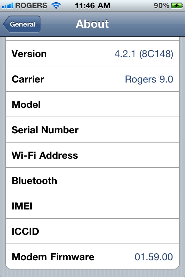

FYI, this is iPhone 4 only and it works like a charm!
I haven't seen anyone really posting this and if it's been posted, my bad. This is probably for people who have legitimate carrier iPhones and just want to preserve the baseband for future unlocking purposes instead of those people who absolutely rely on the unlock for the iPhone 4s to work.
http://www.iphone4jailbreak.org/how-to-upgrade-ios-4-2-1-preserving-baseband.html
The instructions and the video I feel is pretty self explanatory!
I've attached a screenshot, I'm at 4.2.1 and my baseband is still unlockable at 01.59.00.

No, it's not fake and, no, this is the last version of TU, which is 4.21, I believe. You're not running TSS server as the update happens. TU is able to kick iPhone 4 out of recovery mode. Just watch the YouTube video in the link.
If you believe it's fake, then that's your belief. All I'm saying is I have an iPhone 4 running at 4.2.1 with baseband 01.59.00 and I know there are people in the community who'd like to be running the latest version with an older baseband and I'm just confirming that the method in the link above DOES work and this is no fake and neither is the screenshot of my settings screen.

Oh well, I kind of figured that my screenshot and assuming you watched the video, it would be proof enough. But I won't belabor the point, I'm just going to say that the method works and that's that.
Your sreenshot or video means nothing.
