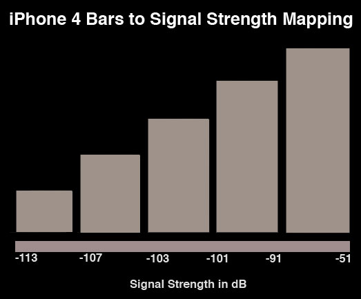

Your not very good at math are you?
Look at that graph, -90 dB is 5 bars, -114 is zero. That is a difference of 24 dB, which is within the reported range of signal lost reported from holding the phone. I know this is very difficult for some, but in this very thread, I have shown mathematically how it is possible for the same phone with the same design defect to be held in one location with 5 bars, and lose absolutely NO bars and held in another location with 5 bars and lose signal COMPLETELY.
The problem with all of this "evidence" is that it fails to take into account all the numerous videos out there on YouTube that show signal strength dropping from FIVE bars to zero. They were clearly in a strong signal area to begin with
Wrong. PLEASE re-read the article. 5 bars does NOT = strong signal
The problem with all of this "evidence" is that it fails to take into account all the numerous videos out there on YouTube that show signal strength dropping from FIVE bars to zero. They were clearly in a strong signal area to begin with, yet went completely down to zero. Then when the hand is removed, go right back up to FIVE bars.
I understand completely what everyone is stating; if you are in an area which has a lesser signal, this is more likely to happen. But that doesn't account for all the 5 --> 0 signal drops.
You are wrong. 5 bars does not equate to high signal. The bars represent whatever signal strength apple wants it to represent. The fix Apple is proposing will show you fewer bars than it used to. So death grip should no longer show 5 to zero but it may show 3 to zero. Just depends on how they calibrate the new signal bars.
Actually, when you look at the Anandtech article, you will see that the ~25dB loss of signal when gripped bare IS enough to take it from 5 to 0 if you are already at the low end of what the phone considers 5 bars.

24 dB decrease from -91 gives you -115 (ZERO bars).
