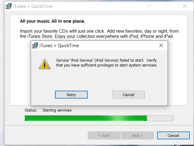

I uninstalled my iTunes and reinstalled it. It still won't work. There is no response. I did an internet search. I noticed that Apple has an iTunes version for the iPhone 4 and Windows 10. It is the 9.2.1 version. I checked to make sure that my HP laptop computer has the 64 bit Windows. It does. I attempted to download that iTunes version (iTunes 9.2.1 for Windows 64 bit), but it won't install on my computer. I tried multiple times. Every time I try, the installation crashes before being completed. And I get a strange message ("...verify that you have sufficient privileges..."). The iTunes icon momentarily appears on my computer, but then it vanishes. A Quick Time Player icon appears on my computer. That appears to install successfully, but the iTunes won't install.

I will attempt to post a screenshot of the message I get when the installation attempt crashes.

Are you using the Microsoft Store version or the Apple.com version. If you are using the Apple.com one, try to uninstall that and install from the Microsoft Store.
Hi JCCL,
I tried what you suggested. I uninstalled the Apple version of iTunes, and I installed the latest iTunes version from the Microsoft store. And it worked. My old iPhone 4 successfully connected and synced to my HP laptop computer. I was able to successfully transfer all of my photos to my computer.
