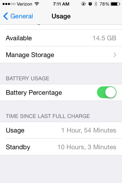

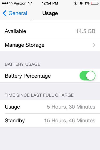

Update from battery replacement.
It's MUCH better then the 3 hours I was getting before and it counted down every % without skipping to 0.
That said, that's a new battery on a phone that has been restored as new. iOS 6 gave me 7-8 hours consistently throughout my normal days routine. But at least it's better then it was prior.
