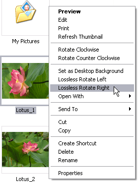

I had the same problem since the lanuch days on my ip4s, my work around is using the JPEG Lossless Rotator, it is build into the right click context menu.
