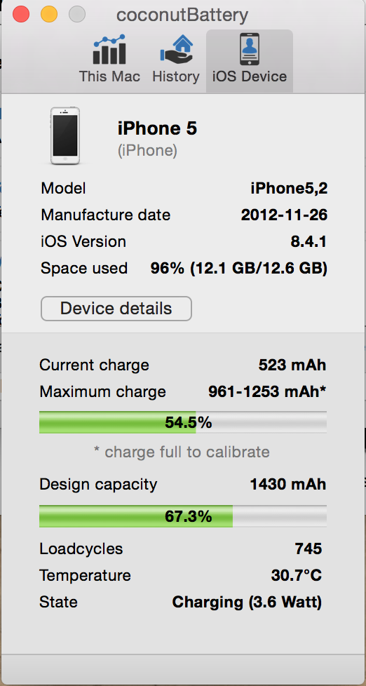

Coconut battery! You can definitely tell it's old, and it's been used.

67% is not good. Better to change it. Anyways, a full restore is not that useful (the problem may appear again after a few days). Try just with the settings restore, before doing anything else.

Background app refresh has an impact if you enable Facebook. If it's off, the drain is not important. I'd enable it, it is useful. Anyways, as Coconut highlighted in the test, you've to change your battery.

SUCCESS! I finally got a Genius Bar appointment this afternoon, and the Genius determined that my iPhone 5's battery degradation was not the norm and offered a free battery replacement. My suspicions were correct. Thank you all for any advice you provided.
