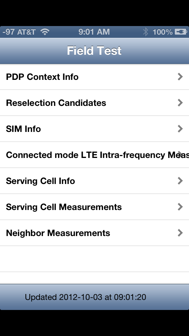

I remember this worked on my 3G, but I don't think it worked on my iPhone 4. Out of curiosity I tried it on my iPhone 5. Sure enough it works!
To enter field mode:
Open up the dialer and dial
*3001#12345#*
Press call.
Presto! Field mode!
Of course this is for AT&T. It's pretty cool to see my signal strength.

Interesting how on the 5, the Field test mode still shows up in "letterbox" mode. 🙂

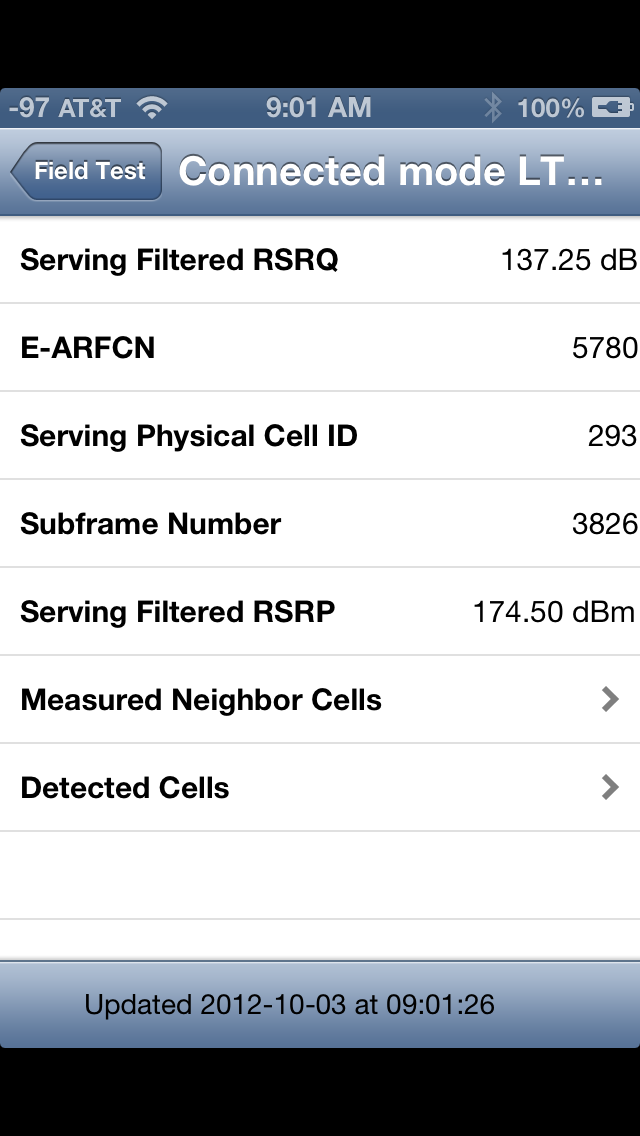

Also, there's an additional submenu if you're covered by LTE.
I thought that was weird too. I also thought they got rid of field mode with iOS 4.

Yes, I am also wondering what this does. Perhaps, in lieu of the existing signal bars, it's simply a different unit of measurement of signal strength?
I believe it's attenuation. The closer to zero, the better your signal strength (someone correct me if I'm wrong, but that's how I've been reading it for the last six months or so).

The Field Test says now -111 and that looks like 1 bar.
Does anybody knows how to check signal for specific cell site by this test and what's minimum number I should have at least some reception.
