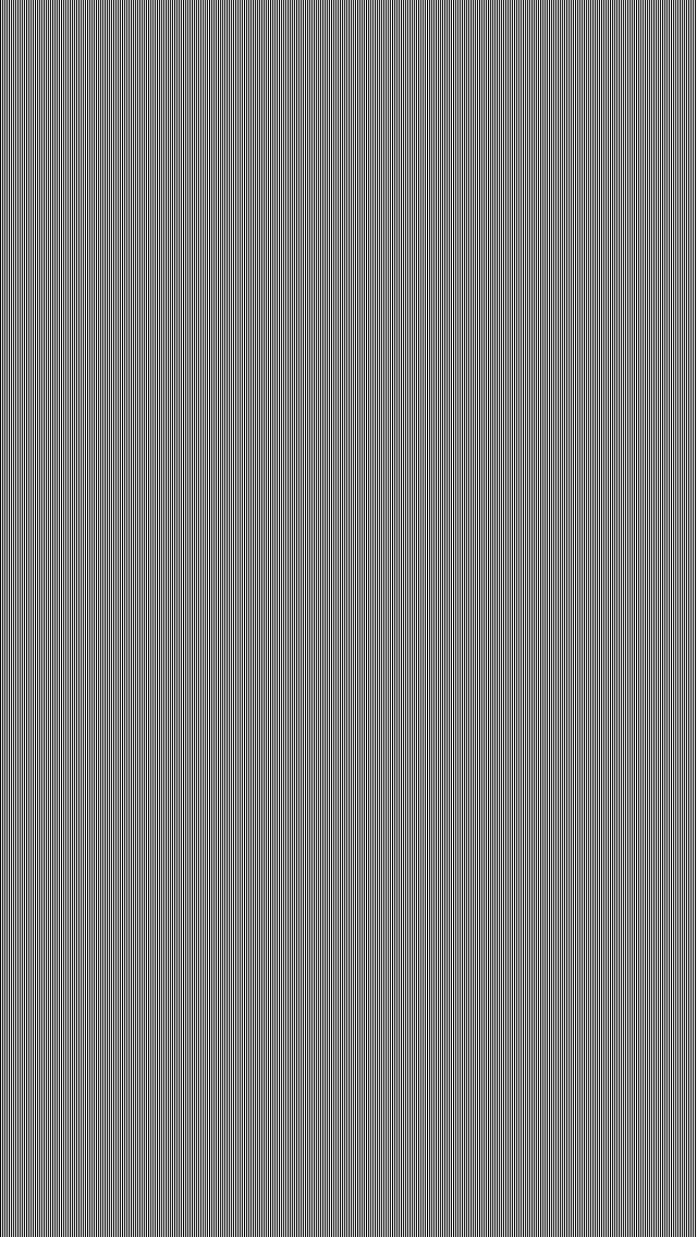

can someone link the this interface image you guys are talking about? i want to see if my iphone 5 has this problem.. what exactly am i looking for/
Save that image as your home screen wallpaper. It will make the screen flicker if you have the "vertical lines" problem.
It only makes the screen by the dock flicker but the rest of the screen doesnt flicker?

Use this wallpaper, if your background flickers or if it flickers by the dock then you have the issue, and it will be very noticeable

I don't get flickering when using that image as a wallpaper. Can you describe what the flickering looks like? Maybe I am missing something. I guess I don't have the problem. I haven't noticed any vertical or horizontal lines on my screen.
Not that I doubt you guys. I have been through my fair share of problems with the 5, and have witnessed quality differences in the screens.
It flickers like crazy, you would notice it right away. It's almost as if the brightness flashes high/low at 30fps or so.

Maybe it was worse in your case because I cannot see anything under the white text on the home screen, hell i cant see anything in the browser, virtually id say the screen to me is like 98% out of 100% with the 2% being the scan lines, sometimes i wonder if its just my eyes playing games with me when i "think" i see it
Like twitching by the dock, but if you cant tell then it means you dont have the issue... But i never see flickering on any background or color, only with that wallpaper which is intended to test for that... From the looks of it other people here defitnetly have worse scan lines then mine because its virtually almost possible to see it on my screen and i even wonder if my eyes sometimes play games on me lmao...idk i dont even really care i got a flawless phone in all other aspects and im not going to swap it out for this reason because its so minor, but i probably will in the future if i happen to really ding up my phone and ill just use that excuse and get a replacement for free
With that wallpaper i posted?
