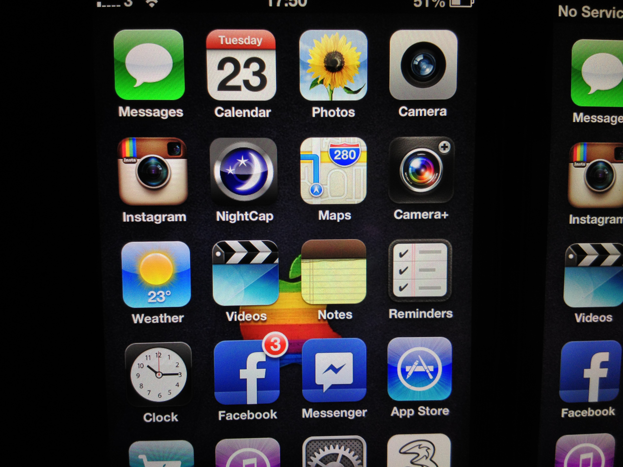

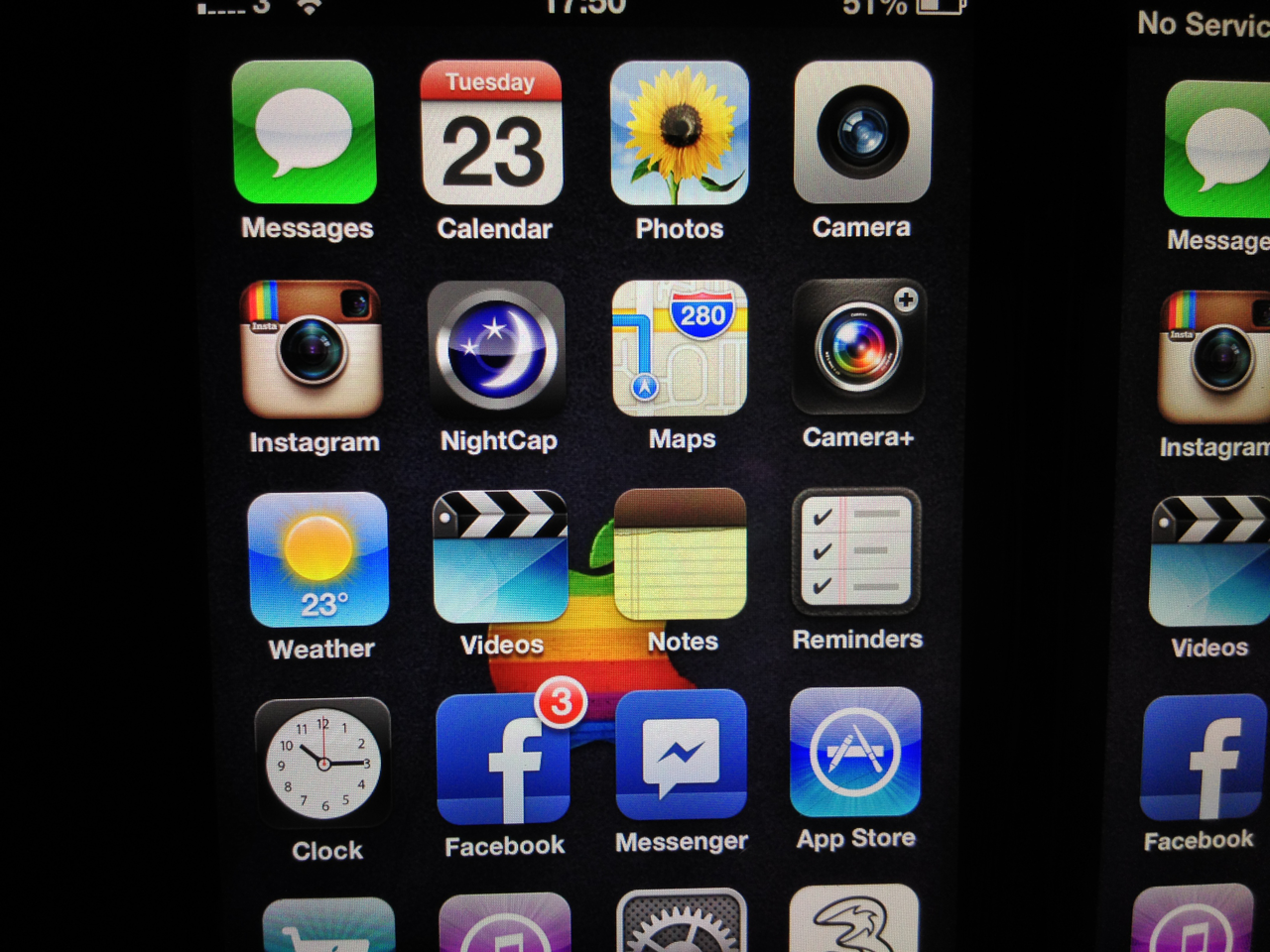

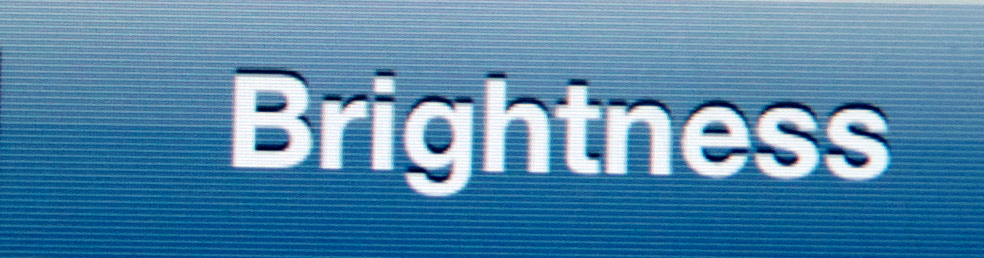

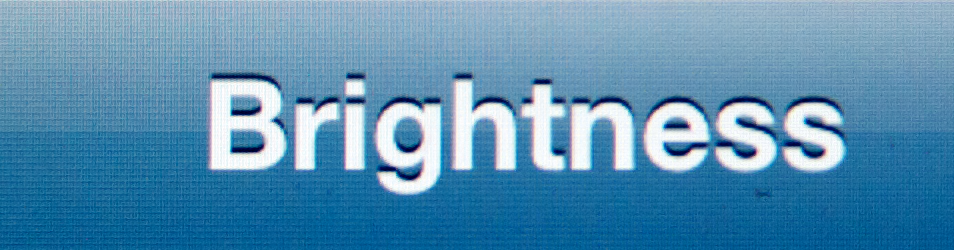

Sorry for saturating this thread haha, but I just want to document stuff so you guys know the interlacing is not normal. My friend took a picture of my screen vs his screen and you can see a complete difference. I don't know if I should keep getting replacements because my unit doesn't have scratches or any other major issues and getting another one doesn't guarantee a better screen.

I noticed that this is more visible on blue or grey colors. It gets really bad when either your eyes or the screen moves, because it seems that the color is shifting on these edges.

As for the interlaced lines in the images above by the other poster, If they look that way all the time then it's an issue, but you can see them on ANY device if you are filming or taking images of the screen, just move the camera around over the device and you will see them.
If you see them with your own two eyes, without a camera? and with just general use of the phone, then I'd say you have interlacing issues, but if you can only see this from photographs or by using a camera lens, then you need to step back from that and just stop obsessing because there's nothing there to be obsessing about.

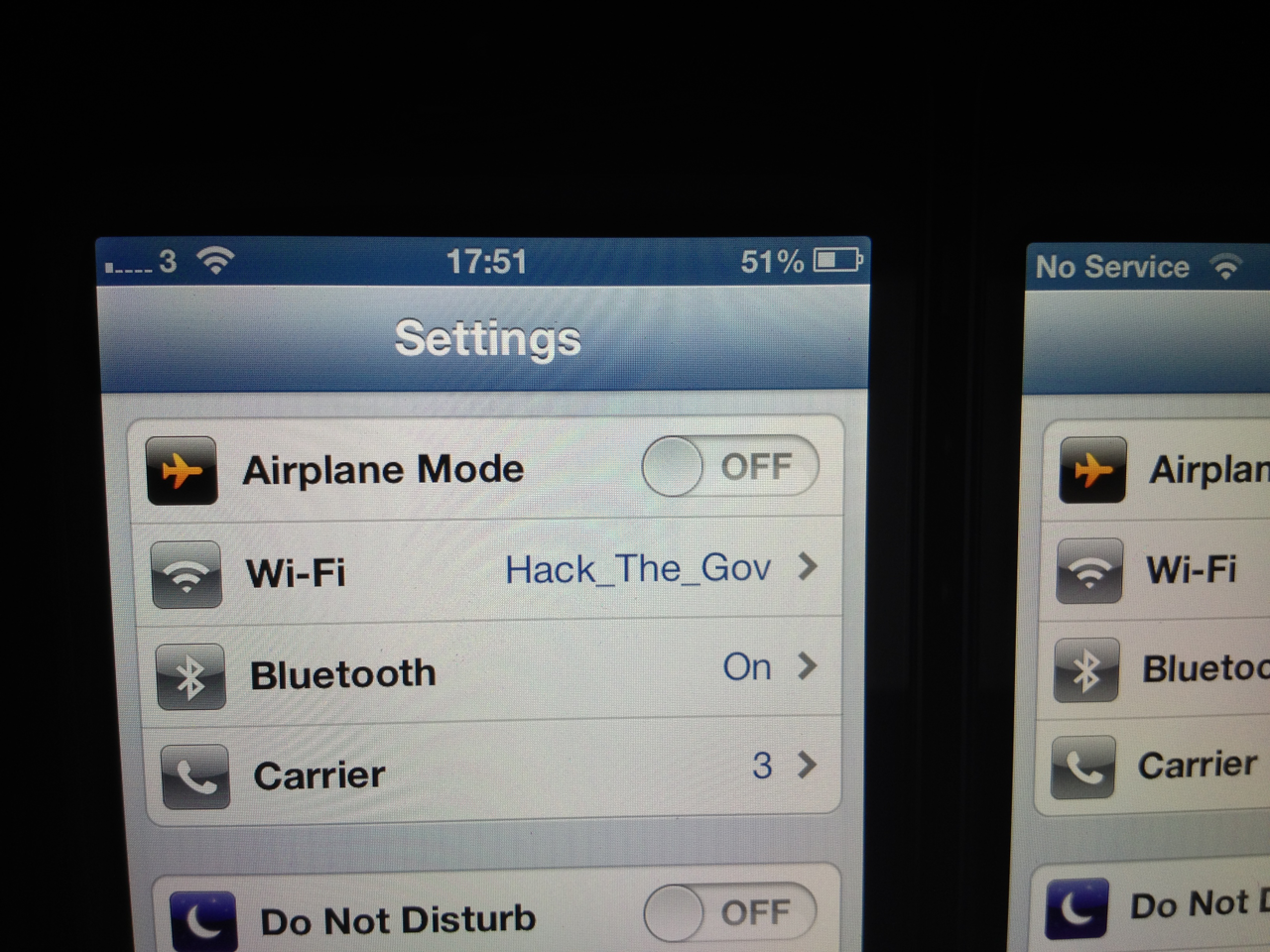

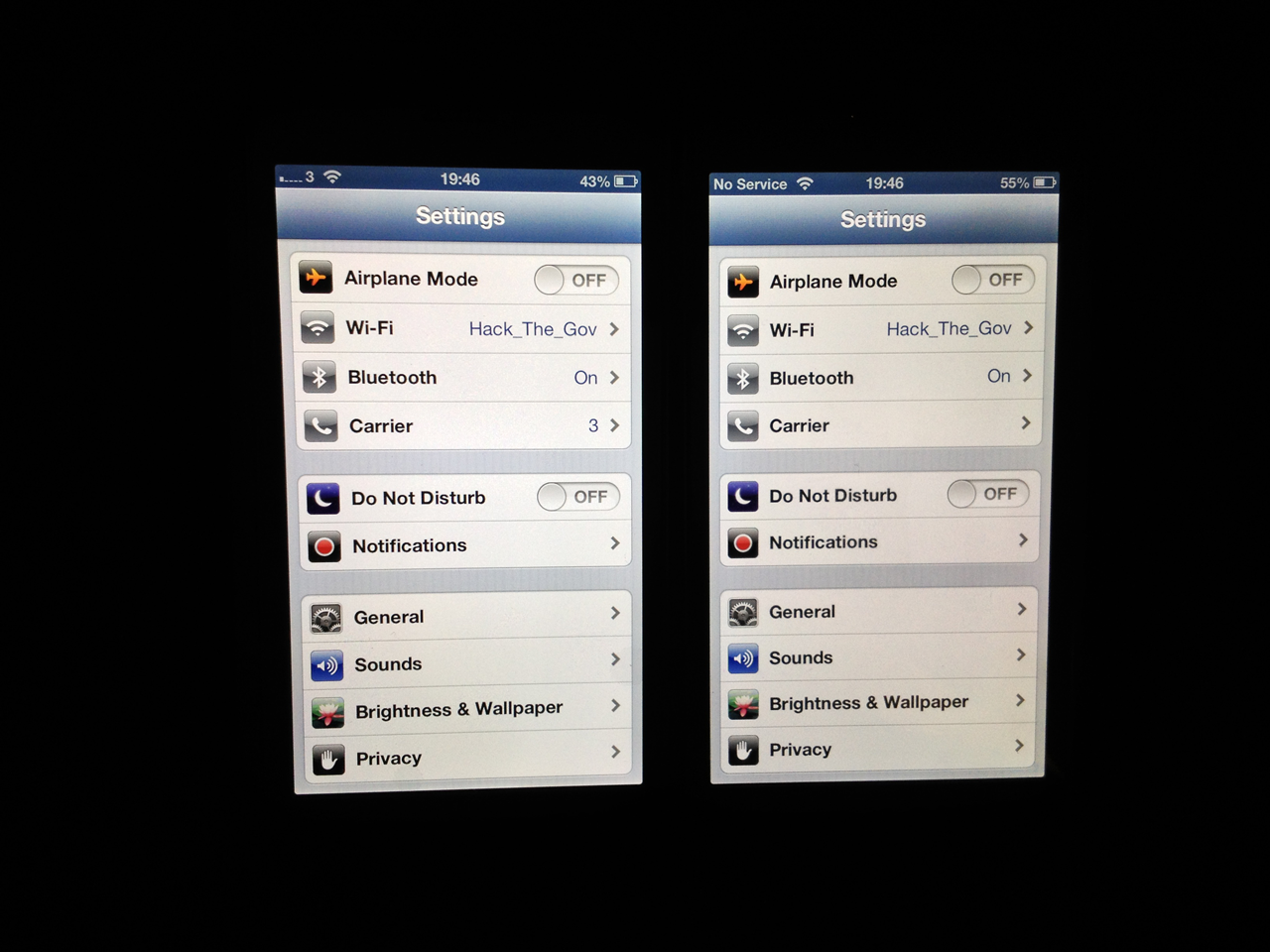

Here are my two models side by side , Excuse the over saturated images, and the lines. I was forced to use my old 4s
Week 39 Black (64GB) - left
Week 36 Black (64GB) - right this one is being returned to Apple, so I have to choose between the two and this one is scuffed 🙁
Both are at 100% full brightness. They both look very different under natural light. It's difficult to get the images to show how they really look. They show a pinkish tint using the 4s camera, but don't show this with the naked eye.
I don't get it; what is wrong with the one on the right if it is not interlacing?
Scuffed to hell. Neither of them are interlacing. Looks that way with the one on the left because of my damn crappy camera on the 4s.
The one on the right is awful, even the camera and some apps tend to crap out and freeze.

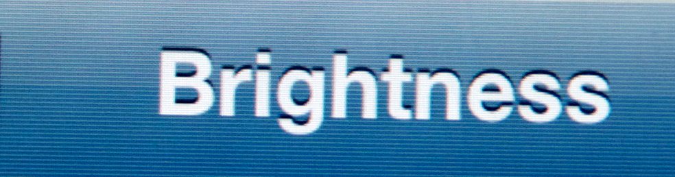

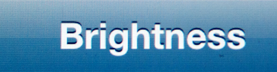

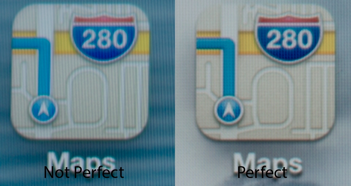

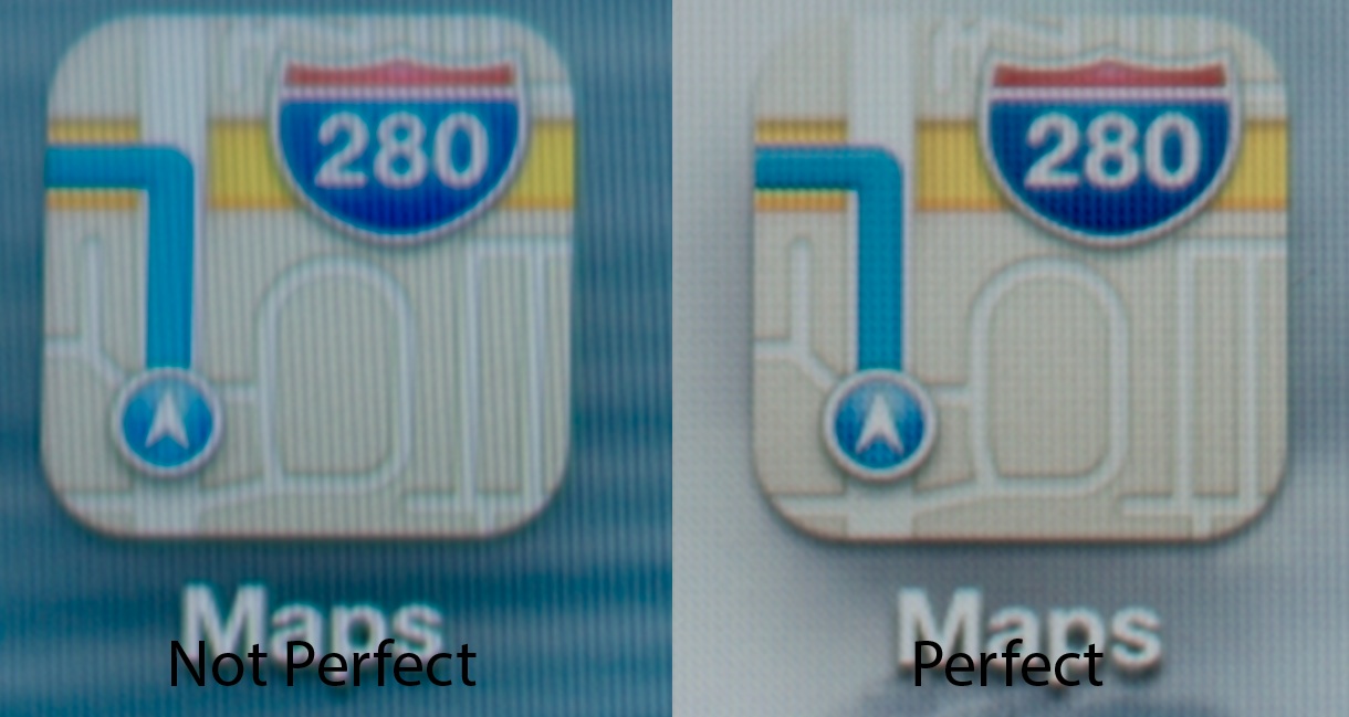

This is what interlacing looks like. If you cannot see this with the naked eye and only through a camera lens, you are obsessing.
If however, this is visible to the naked eye, obsess away dudes.
Interlacing - Left
No Interlacing - Right
Interlacing - Left
Interesting your lines are horizontal. It seems this isn't a new problem as iPhone 4 owners complained about them. I wonder who makes the interlace screens or if all manufacturer's provide bad screens from time to time.

I looked back at my iPhone 4 and actually saw horizontal lines, but they are so small that I might as well be looking at subpixels. I didn't notice the lines during the 2 years using the iPhone 4, but the lines are much bigger on the iPhone 5 and I noticed it within a few minutes of using the phone at a normal viewing distance.
