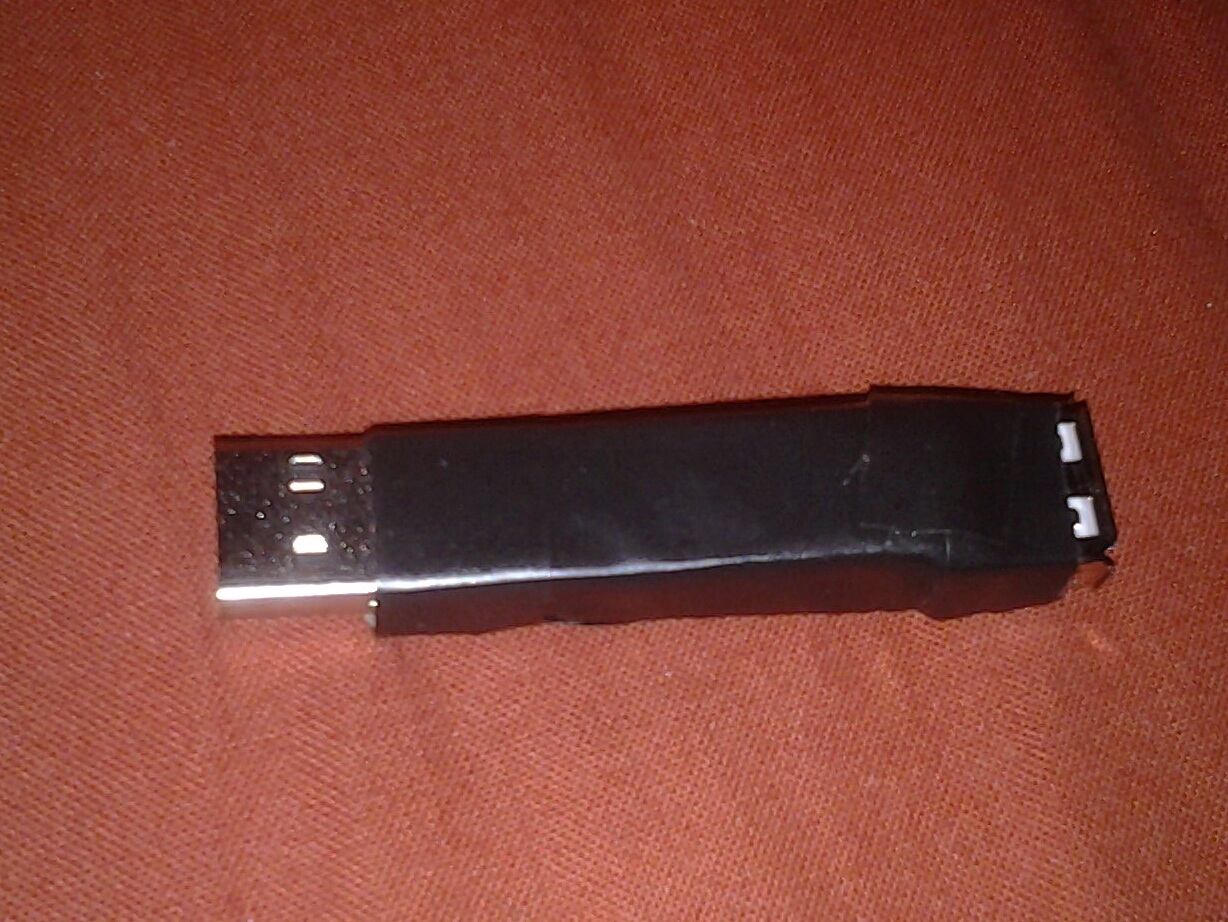

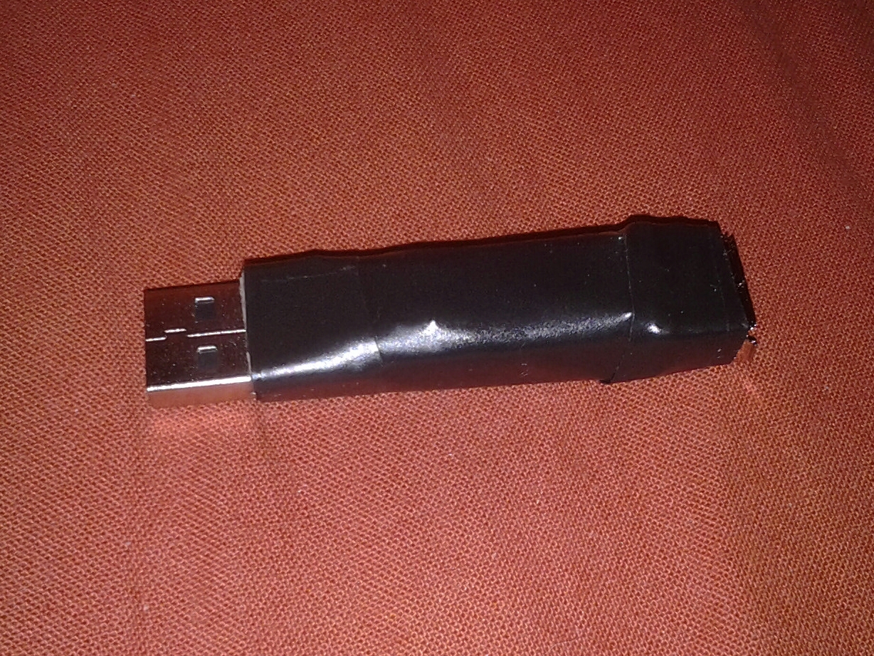

I made some usb adapters that plug between any usb port and your ipad/iphone usb
I made some usb adapters that plug between any usb port and your ipad/iphone usb connector that allows charging from any usb port. This way you can charge from any pc, or generic wall charger, any car charger, etc. If you're interested in one let me know. I can list them on ebay or some other site.
See pictures, nothing fancy but they work perfect with any charger and or usb port
