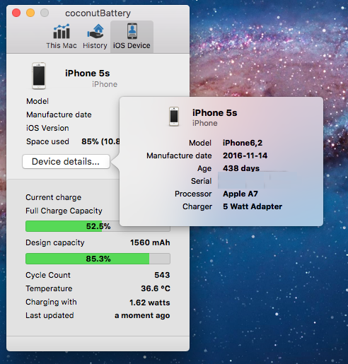

Hook the phone to Coconut Battery to look at the state of charge cycles, odds are, that battery, like my library card, has long since expired.
Hello,
thank you all for your replies. I'll post the picture of Coconut, recommended by @jav6454
Is it possible that it shuts down due to cold? It shuts off usually when I'm outside and it started kinda recently. I don't remember this issue from the last year when I bought it though.
Cold can have an effect, what’s the ambient temperature? Also, your battery looks very good at 85%. That said, it means not a bad battery and puts other factors in play.

It'll be the battery, and yes it may be exacerbated by the cold, but either way its the battery that ultimately needs replacing.

In the end the battery will be the problem. Everything you say indicates a weak battery that is affected by the cold. Coconut battery has been mistaken before.
1) Your battery has reached end of life. The design capacity of 85.3% is unreliable as it's only an estimate. The cycle count of 543 is the most accurate indicator. Li-ion batteries are most commonly spec'ed for 500 cycles. And this is the case for Apple iPhone batteries.
2) Temperature has significant effect on li-ion capacity. There's up to a 40% loss in cold temperatures of -20C.

Apps don't know the chemical state of the battery. Without dissecting the battery under a microscope, the "capacity" readings from all apps are estimates. The apps use a lookup table and estimate based on age and cycle count.
Batteries age due to time, heat, and mechanical stress. If you use apps such as GPS that draw significant amounts of power and heat up the phone, it negatively affects the battery. Besides heat, there there is also mechanical fatigue as the lithium ions move through the anode during operation. This occurs more rapidly if you run apps that cause high current draw.
In short, you can't compare battery age alone as the aging depends on many factors. Cycle count is a good indicator.
