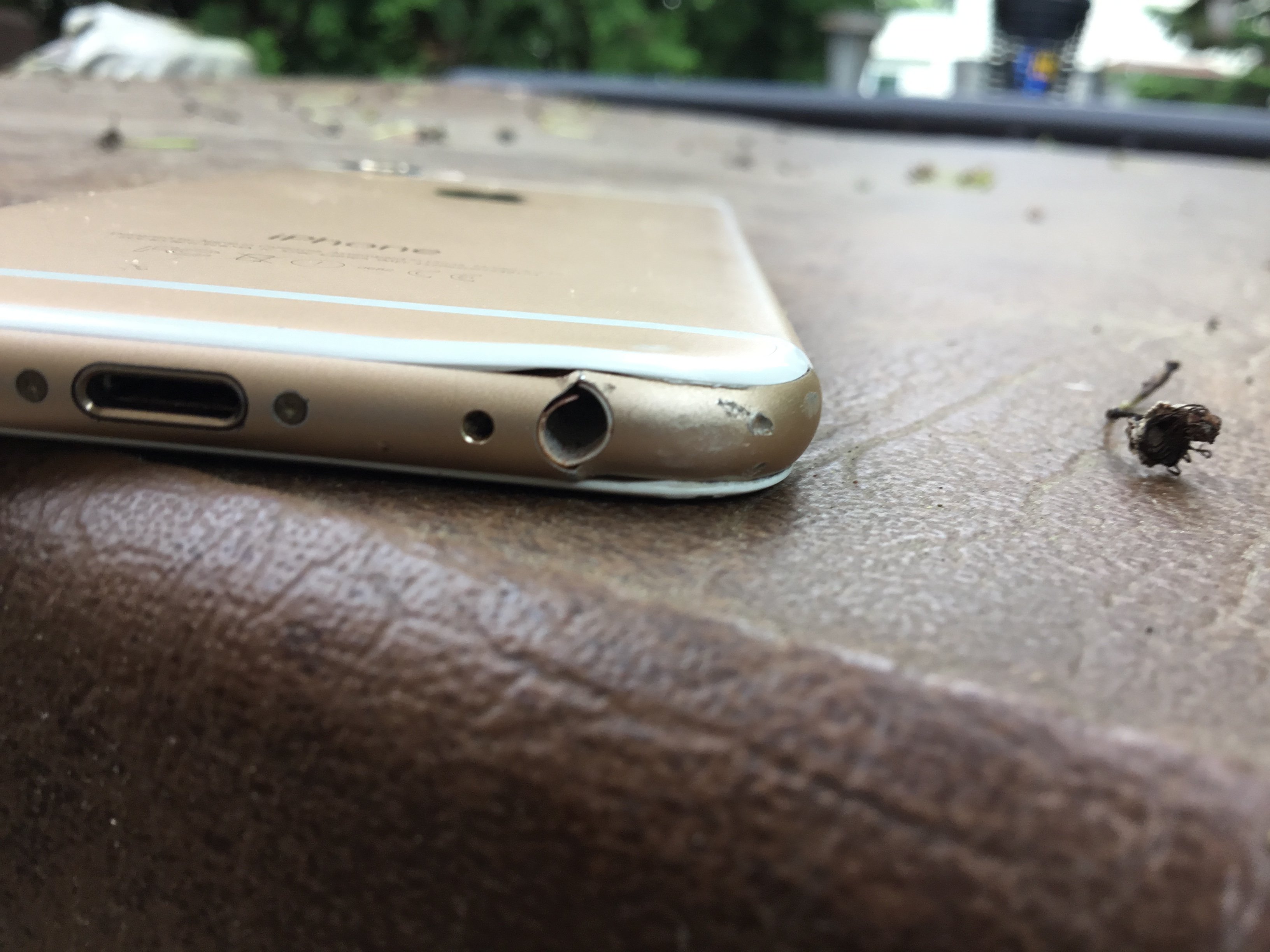

I went to the Apple Store Polaris in Columbus, OH, today, to replace my battery for the $29 charge. You can see from the attached picture that at one point, I dropped my phone, and the metal around the headphone jack cracked. I was afraid of what was next after reading Genius Bar horror stories over battery swaps.
An Apple support member, “J.T.,” stated that he conferred with “three techs” who all said they wouldn’t touch the phone—whether I needed anything done on it or not as my 2014 phone is out of warranty. I could either leave or replace the entire phone for $299. The issue they saw was that it would be “impossible” to replace the battery without the front popping off permanently, and the phone “probably suffered internal damage.”
I don’t even use the jack (I use the lightning dongle), but in any event, I can STILL put a jack in the hole and the jack works fine. “J.T.” wouldn’t hear any of it, just repeating that Apple “doesn’t repair damaged iPhone 6 phones.” NOTHING is wrong with this phone but this crack, and I was told no one will replace the battery. This guy’s smug attitude didn’t make me any happier, but, then again, welcome to the Apple Store.
I left, went upstairs at the mall, and paid $40 to a third-party kiosk to swap with an Apple-branded battery. I got the phone back, and it works like a new phone again. Took ten minutes.
“J.T.” told me that Apple wouldn’t even replace the “shell” of the phone, equating it to “replacing the entire chassis of your car.” That’s rich—if my car has a dent, I can still get a battery replaced without swapping out my car’s shell. It was clear that Apple was looking to force me to either upgrade or pay $300+tax for a simple fix. I’m disgusted with this level of “customer service.”

Your phone's condition is a perfect candidate for Touch Disease. Once it gets dropped like that, there's a good chance it will be affected later.
On the iPhone 6, the chips on the logic board are not glued with underfill. As a result, bent or dropped phones are likely to experience TD down the road. Apple doesn't want to be responsible for it.

Touch Disease doesn't happen overnight. It happens after drops and bends. After that, normal vibrations (such as putting your phone on a table or hard surface) accelerates the process. The solder points on the chips slowly lose connection with the logic board.
Replacing the battery requires physically prying 4 connectors from the logic board: display, front camera, finger print sensor, and power.
The entire process places bending stresses on the logic board, which has already experienced stress from an obvious hard drop.
Apple is responsible for warrantying your device for 90 days after the battery replacement. TD is much more likely to happen after a battery repair due to the above mentioned stress. Apple simply doesn't want to be responsible for this.
You're thinking this is only a cosmetic issue. From an engineering perspective, your phone is not in a serviceable condition in terms of reliability.

Touch Disease is often slow to show up. Phones are engineered to handle a certain amount of everyday, cumulative vibration over the lifetime of the device. A drop significantly decreases that lifetime, particularly with iPhone 6 due to Apple choosing not to secure chips with underfill. Every day vibrations from the vibration motor or handling will continue to decrease the lifetime of those soldered connections.
Is Touch Disease guaranteed to happen after a drop? No, but the chances are much higher. As I mentioned, prying the connectors on the logic board makes this even more likely.

If they open the phone and replace the battery and find themselves unable to close it back up properly because of the damage, then they lose out.
I wouldn't have touched this phone either. You damaged the phone and they rightfully rejected a repair. Tough luck. Put a case on the next one.

I don't know what you mean by "not responsible for damage from accidents anyway." True, their warranty does not cover accidents, but as a repair shop, if they agree to repair something that has physical damage, they need to be reasonably sure they can perform a satisfactory repair, at the quoted price, despite the damage.
It doesn't matter whether you tell them, "It's been working fine for 30 months." If they pry open the unit and find pre-existing damage, or if something that was nearly broken before the repair becomes completely broken because of opening/repairing, who will be held responsible?
Maybe they could have said, "We'll try to do the battery for $29, but if anything goes wrong or we find additional problems that prevent a successful repair, we'll have to charge you $299 for a replacement." Would you have agreed to those terms in advance?
Even then, since the repair is covered by a 90-day warranty... can they be sure, if they only replaced the battery, that they wouldn't see the iPhone back in the shop, at Apple's expense, a month or two later?
Apple, being a very large organization, has polices and procedures for everything (including the kinds of damage that rule-out a simple battery replacement). However, as in most very large organizations, the detailed, complex reasoning behind command decisions is not relayed to the troops in the trenches. So when a customer disagrees with the company's policy, it's not necessarily reasonable to expect a foot soldier to provide a complete, satisfying explanation of that policy.

His point is that Apple would have to warranty the repair for 90 days. If for example the headphone jack failed after the repair which wouldn't be surprising given the state that's it's in, Apple would be liable to fix your phone because a part of the phone failed after they had worked on it.
I would consider the damage to you phone rather more than minor, more like major structural damage.
Ultimately Apple probably doesn't want to fix phones that are damaged to the point of something likely braking during or after the battery replacement.
