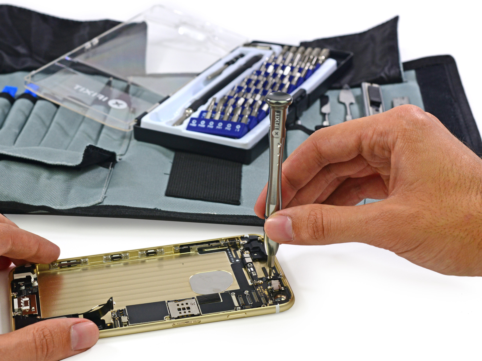

Also before, the actual shape of the 5 and 5s helped to prevented this from occurring (aside from the shortened height, of course). The squared edges add strength to the form but without them, the strength is determined solely by the materials, in this case the aluminum and glass, which is pretty durable now. The only inside supports are from the metal rivets either attaching components to the housing or the padding around volume keys.
Here's a photo from iFixit for those who want to see the points of weakness in the chassis:
MZkkrpauIeskXman.huge
Design oversight, maybe, but I don't think it's close to a antennagate.
