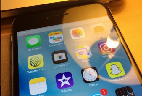

My 6 Plus screen went unresponsive with the grey bar at the top. It's the second time this had happened. What causes this?

That's what I mean.

Thank you. That helps. Is that the normal color of that bar (I believe it's called the status bar)? Or are you saying that the gray bar appears and then the screen freezes?
Regardless, I would suggest rebooting the phone. If that doesn't fix it, you might consider backing it up to iTunes, restoring to factory settings, and then restoring it from the backup. If that all fails, it probably has to go to Apple for warranty service.

Yes, the grey bar appears and then the screen freezes. I've rebooted it and the lines still appear, even while booting up. But I know that restoring it back to factory settings won't do anything because when when i hold the phone tight, it works again. I'm pretty sure it a physical hardware problem.
