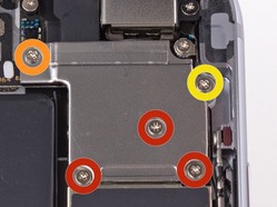

This is a common problem on a hardware "bend" on the top right common to the iPhone 6's.
People have opened them and put a sim card on the top right above or below the metal overlay there and had the problem disappear.

I replaced the battery before so had the tools on hand. I didn't realize until opening it that this fix was for a 6 plus so I couldn't put a sim in the middle as that's where a screw goes. I also totally mucked things up as I misplaced where the screws were initially and was trying to screw the large one into the wrong hole, luckily I didn't force it but it goes on the right side hole and not in the middle. I eventually put everything back without putting tape or anything and the phone has been working fine for a few hours. So does this pretty much confirm that that's what the issue is? If it messes up guess I could try the SIM card fix again but maybe cut it in half so it doesn't interfere with the middle screw (see pic attached mine has middle screw the plus does not)?
Yes, I've seen video of people using a small part cut off a credit card or even folded electrical tape. Some have wedged it in that corner either below the metal shield or just above it.
In both cases, the screen touch disease and the gray bar problem disappears. The problem is apparently a warping of the phone due to the light elements of the case being too soft. They corrected this in the iPhone 7 and use a more rigid material for the case.
Ah ok maybe I got the tape route if the issue arises seems easier. Whats weird is we never got the gray bar. The phone was dropped during the time it happened, maybe the cable got unseated. Thankfully phone is still kicking with no issue. We're not ready to upgrade yet maybe this next X gen we will.

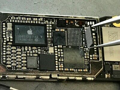

Drops and bends are what cause Touch Disease. The touch controller isn't secured using underfill to the logic board. Solder alone isn't designed to hold chips in place during drops. Anything that stresses the connection points between the chip and logic board contribute to TD.

It will gradually get worse as applying pressure will stress other solder points. Realistically though, the device might outlive its usefulness by the time it's completely non-responsive.

I am still rocking my iPhone 6 with a new battery but recently the touch disease has become worse and worse. Already put a small credit card piece over the controller. The display sits firmer now but touch is still shaky.
Do you have any other ideas of what I could do? The new iPhones are only a few weeks away, I know - but I have really come to like my 6, its compact size, great battery life and everything. My phone use is light as I am doing most of the typing for e-mails and iMessages on my MacBook Pro.

I did open the phone and check for loose connections, also to put a piece of plastic against touch disease but no improvement. I have been reading that a chip needs to be re-soldered for it to work again?!

Thank you JPack. Is this something I could fix myself? Have tools here and I assume there are Youtube videos on this problem?
No, it’s a complicated process that requires a lot of practice and real tools. There is at least one chip (often two) that needs to be removed, re-balled, and re-soldered.

In the video the guy "just" resolvers the IC chip by heating up it up. What do you think? Not something I should try.

I'm just wondering how many times the person on YouTube has done it successfully before posting the video. If you have nothing to lose, you can give it a try. It's what the cheap eBay sellers are doing.
Even if successful, it's a short term fix. The proper fix requires removing the old chip, reballing, and resoldering. This removes any existing oxidation on the old solder. Some shops add a jumper wire to the M1 pad to better prevent this from happening again.
