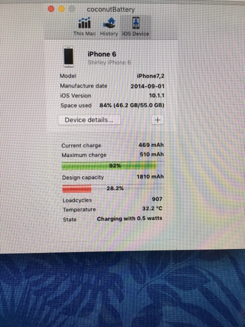

What does the red bar at 28.2% tell me ?
The current battery capacity?
That red bar is the battery health which means your battery is knackered and needs replacing. The design capacity for the battery is 1810mAh and the max capacity for your battery is 510mAh.
