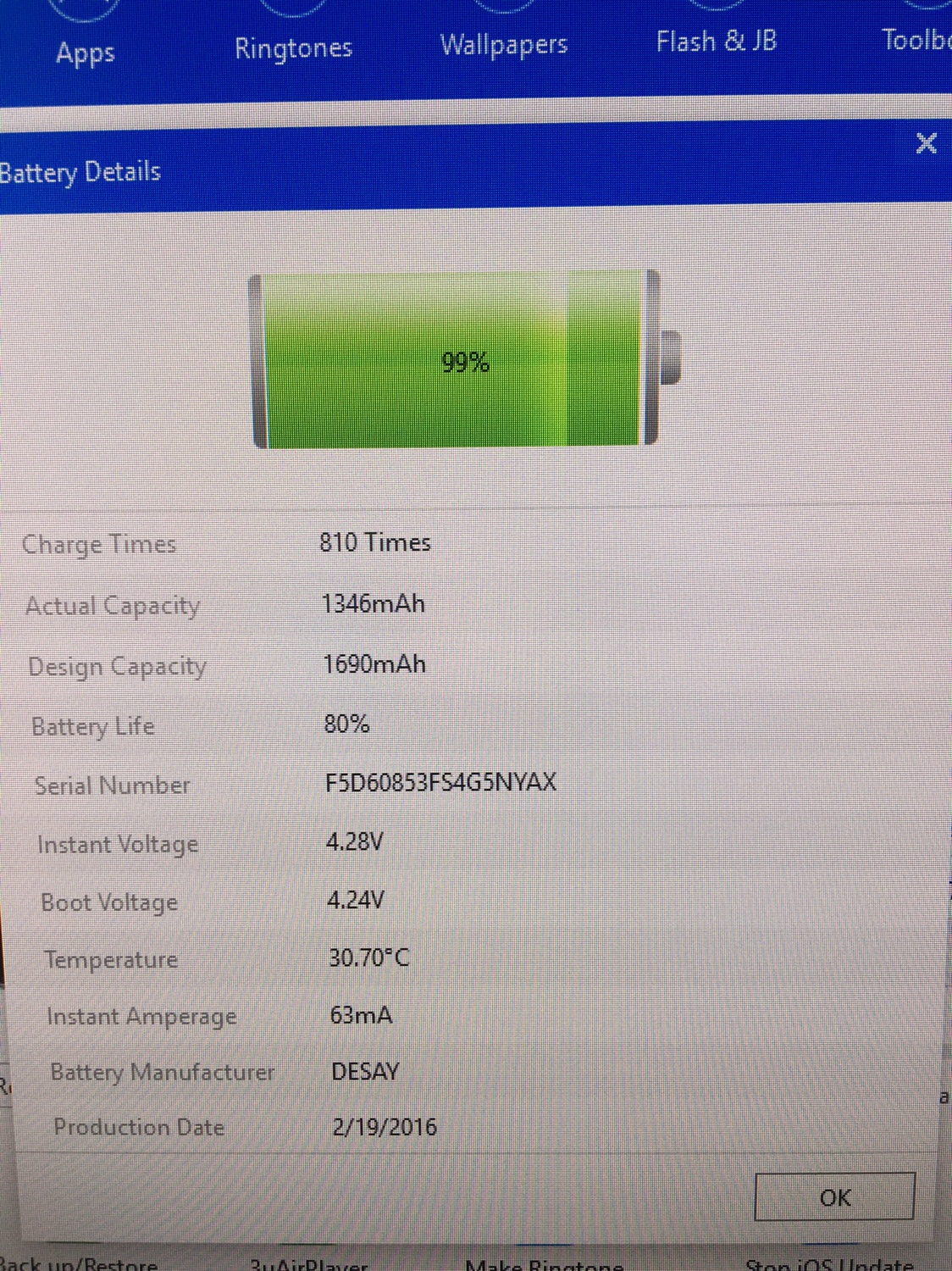

Guys, I've read in 2-3 places that people have done it. According to them - the battery fits, connector is the same, the cable is a bit longer, but they bend it so it fits.
This is 200mAh more. Anyone here done this? My battery is 3 yr old and at 810 cycles, I have to buy a new one, and am thinking to try this

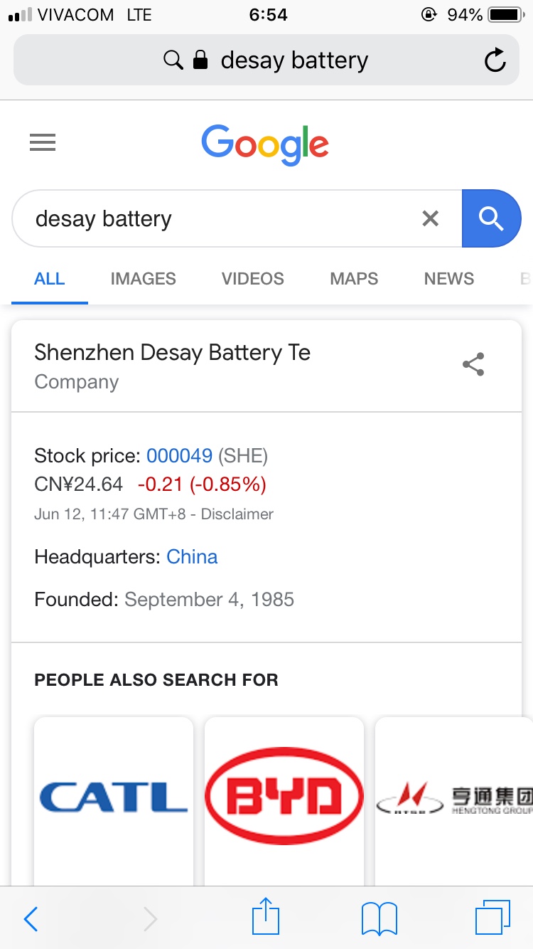

Guys, you know that there isn't some kind of apple magic in their batteries, right?
They are built in China too.
Desay is my OEM 3 year old now, battery. Upon quick Google search, this comes up.

- I've bought an iPhone 7 battery, the connector is the same, as the size. The cable though is longer, and in my case, came with a metal one, that couldn't bend enough to fit. So, if one decides to do it - find one with a softer type of flat cable. It will work.
Then I've bought another third party battery for the 6s, and now I'm getting like 50% more screen on time.
With the original, 3 year old 80% health and 810 cycles battery, I was getting 2 hours of screen on time on mobile data, and 4 on wifi.
Now I'm getting 3 hours of screen on time on mobile data. Didn't test it on wifi yet.
