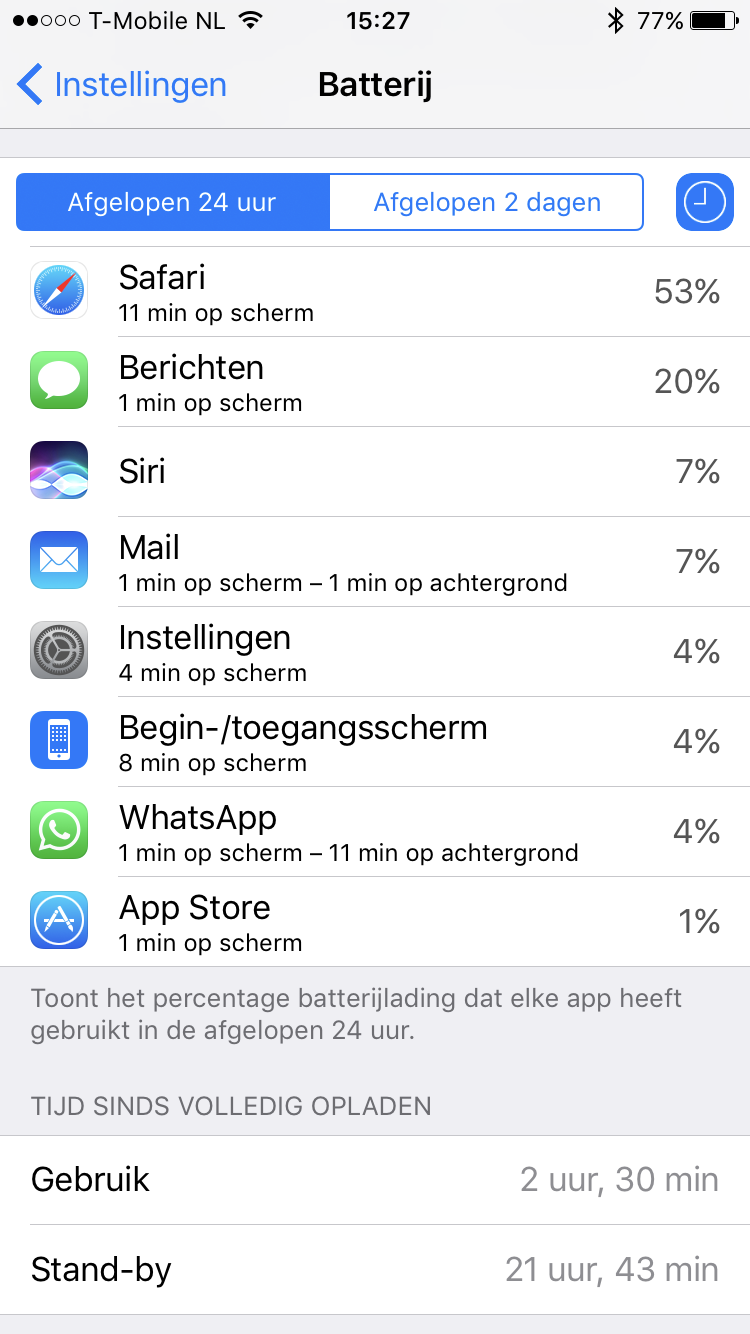

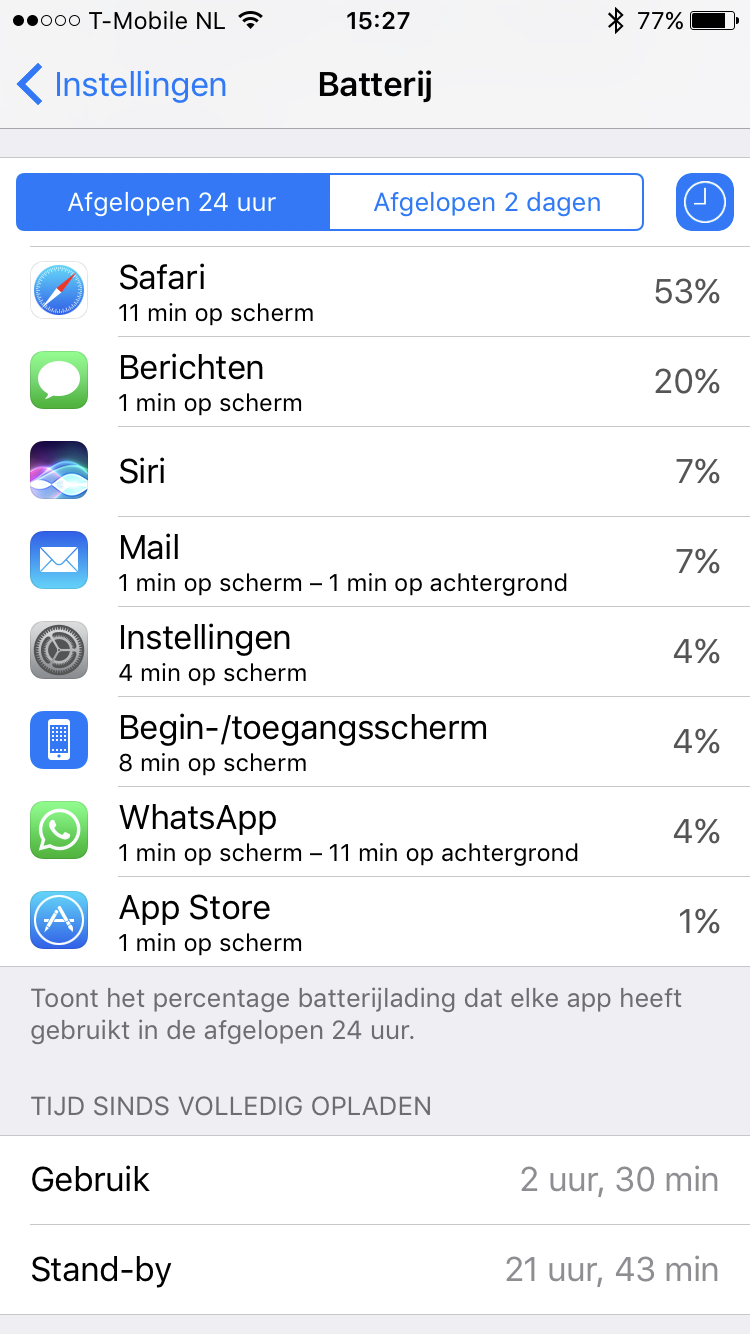

At home I left the phone be and got the following result. As you can see the phone clearly reports a lot more usage then I've actually used.
I ordered a new sim so hopefully that'll fix something. On airplane mode it drains 3 percent over 8 hours with 7 minutes is usage instead of 7-9 percent with 40 minutes of usage. It's getting really annoying now and I just can't make it through the day like this. Sure it makes 2 days on standby, but whenever I actually use it it's dead at 3pm.

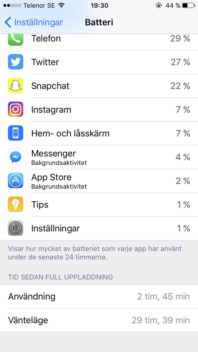

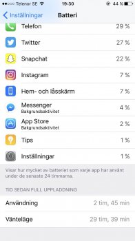

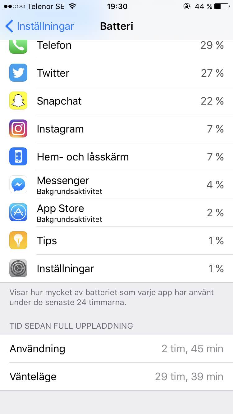

This is my IPhone 7 battery life. As you can see, haven´t used it much. More regular things. Most surf over wifi. I think it´s bad. Suprisingly bad. I have tried to turn backgrounds refresh off and things like that. So, now i´m stuck in the middle between; is it something wrong with my phone or is this "normal"? When i see other post here i think it´s my phone and that this is not normal at all. Any suggestions what i can do?
29 hours standby and it's still at 44% ? I would have thought that's pretty good. Maybe try using it more and see what sort of Usage stats you get, that way uou can probably judge better ?
If the usage stats are real and not lying; that's quite good! Mine would show 10 hours of usage at that point but in reality I would've used it for around 3, just like you and my phone would be empty; so you win 🙂
